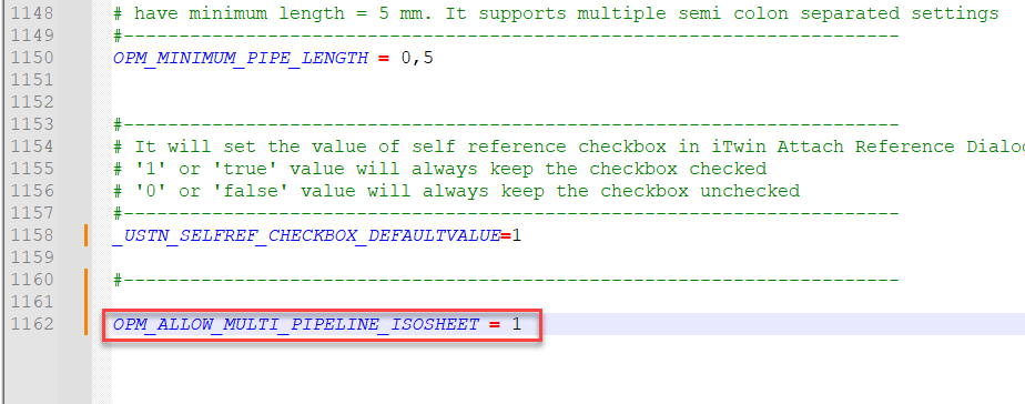

  1. Open the modeler.cfg file located in OpenPlant workspace configuration. Add the following line to enable multi-pipeline isometric generation:
  OPM_ALLOW_MULTI_PIPELINE_ISOSHEET = 1
            Save the file after making this change.

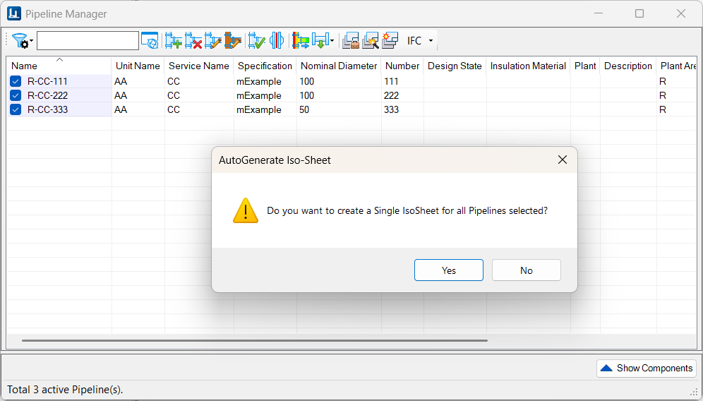

  3. Open the Pipeline Manager from the ribbon.
  4. Select all pipelines that are part of the connected system.
  5. Click the AutoGenerate IsoSheet button.
        A prompt will appear: "Do you want to create a single IsoSheet for all pipelines selected?"
  1. Click Yes to confirm that you want to generate a single system isometric sheet.

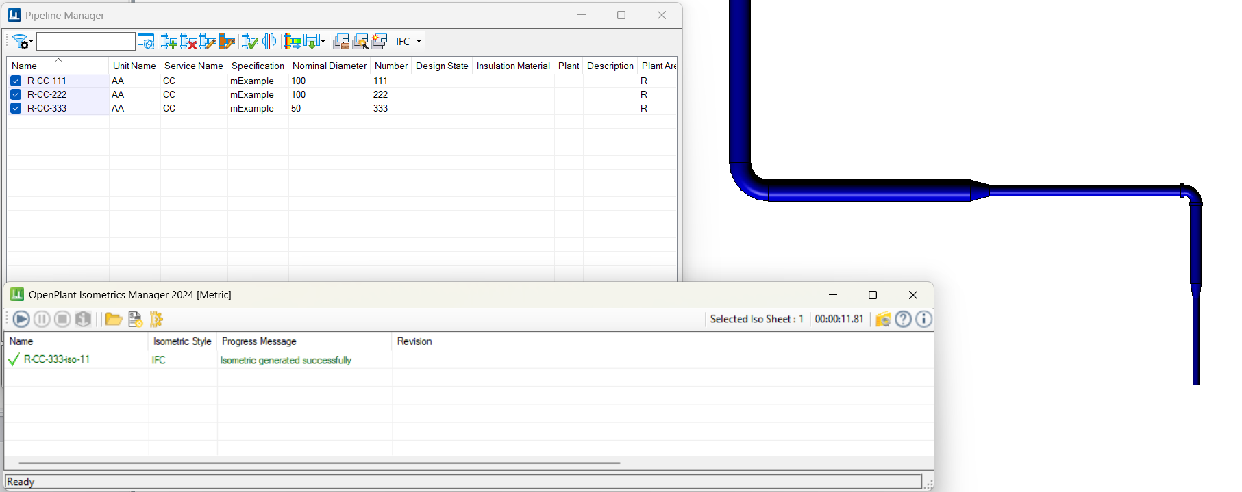

    8. Reselect the pipelines and click Generate ISO.

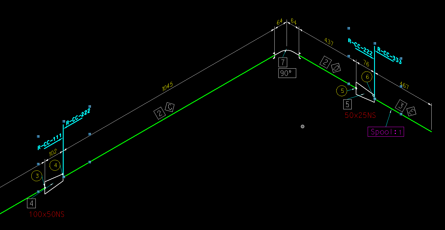

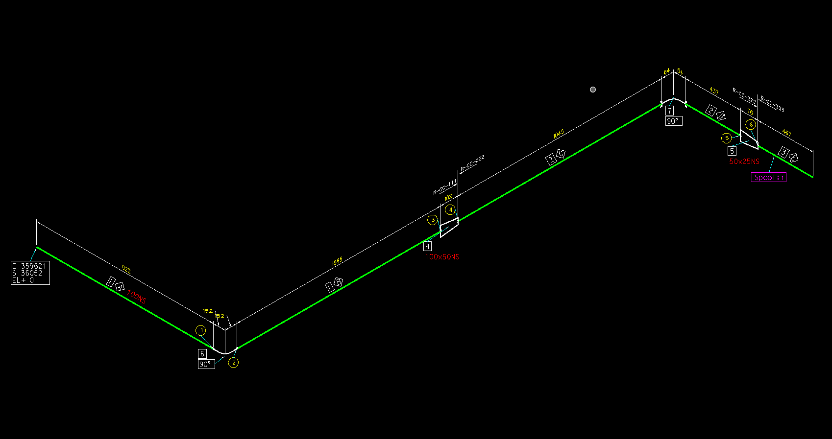

    9. Notice that a single Iso sheet has been generated.
    10. Open the generated isometric drawing to verify that all selected pipelines are included in a single sheet.
