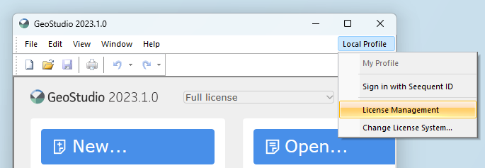

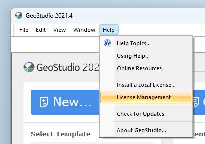

Information about your license can be found in the License Management dialog box in GeoStudio.
- In GeoStudio 2022.1 and later:
- this is accessed via the User Profile menu (located at the top right of the application menu bar).
- you can also switch between license methods in the User Profile menu.
- In GeoStudio 2021.4 and earlier, this is accessed via the Help menu.
Bentley SES Licenses
If you access GeoStudio licenses through Bentley SES, use this method.
- Launch GeoStudio.
- Ensure you are signed in to the Bentley CONNECTION Client with your account.
- Under the User Profile menu, navigate to the 'License Management' menu option.
- The License Management dialog will display available GeoStudio Tiers.

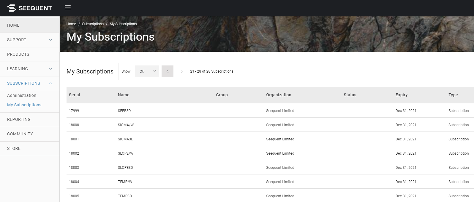

Find Seequent ID Licenses Using MySeequent
- Log in to the My Seequent portal.
- Select 'Subscriptions' from the pane on the left.
- The My Subscriptions page will list all of your available subscriptions:
