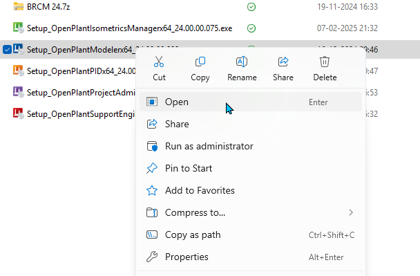

    2b: By opening the exe file
    A screenshot of a computerAI-generated content may be incorrect.
  3. Click on Modify -> Configure -> <Check OpenPlant Support Engineering> Done

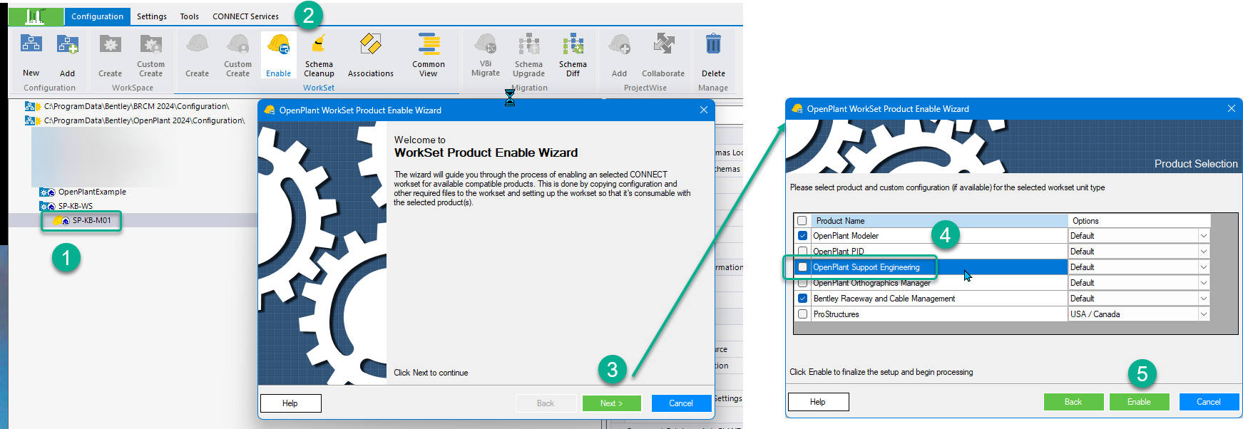

  4. Goto OpenPlant Project Administrator and select the workset in which you want to enable OpenPlant Support Engineering Options.

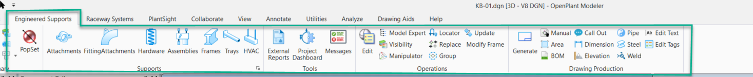

  5. Open any drawing in the workset and you can see that the Engineered Supports options have been enabled.
