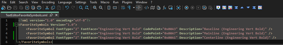

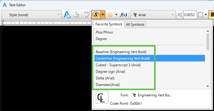

  6. MS_DGNTEXTEDITORFAVORITESYMBOLS
    • This variable defines the file path where the favorite symbol preferences are stored. It points to an XML file that stores this.
    • Here is an example of the .xml file:

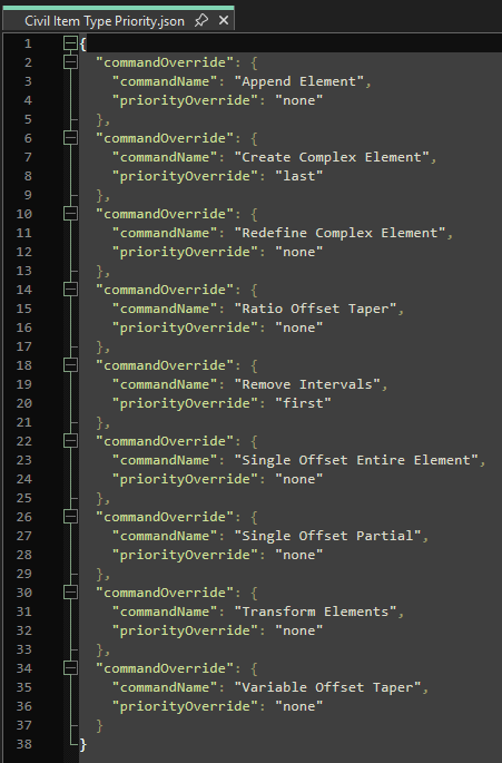

    • ITEMTYPE_PRIORITY_MAP_PATH = $(CIVIL_ORGANIZATION_STANDARDS)Dgnlib/Item Types/Civil Item Type Priority.json
      • Purpose: Optional definitions to override the default behavior for how conflicts with Item Types are resolved on a command-by-command basis. For example, if you have two lines that each have the same Item Type properties but different values, what happens when you complex those lines together? Keep the item type from the first element selected, last element selected, or keep no item types.

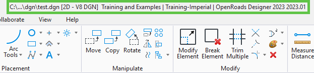

  10. You can customize the title bar at the top of the software to display additional information related to your workspace. Review this wiki for more information.

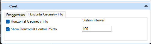

  18. Display horizontal geometry information in the dynamic profile view by default by defining these variables:
    • CIVIL_PROFILE_HORIZONTAL_GEOMETRY_INFO = 1
    • CIVIL_PROFILE_HORIZONTAL_GEOMETRY_HTPS = 1
    • CIVIL_PROFILE_STATION_LOCK_INTERVAL = 100
