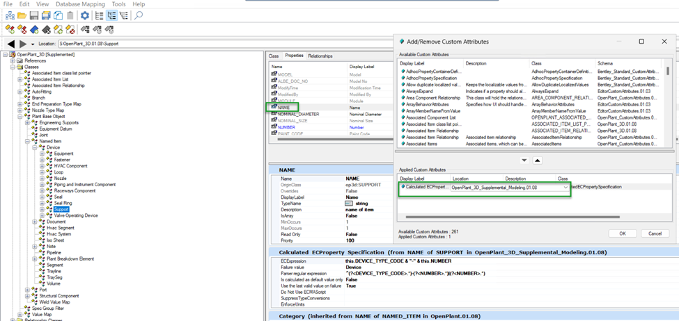

Problem Background
The scenario is where the reference file is created in OPM Update 9. On the other hand, the main dgn file is made in OPM Update 11. The crashing occurs when copying a pipeline including pipe supports attached from a reference file.
1. Open OpenPlant_3D.01.08.ecschema.xml in Class Editor.
2. Supplement with OpenPlant_3D_Supplemental_Isometrics_Isoextractor.01.08.ecschema.xml and OpenPlant_3D_Supplemental_Modeling.01.08.ecschema.xml.
3. Proceed to Support class.

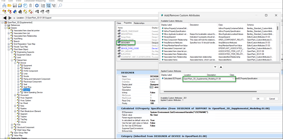

4. In the Properties, look for Designer. Add Calculated ECProperty Specification in the custom attributes. The location must be in OpenPlant_3D_Supplemental_Modeling.01.08.

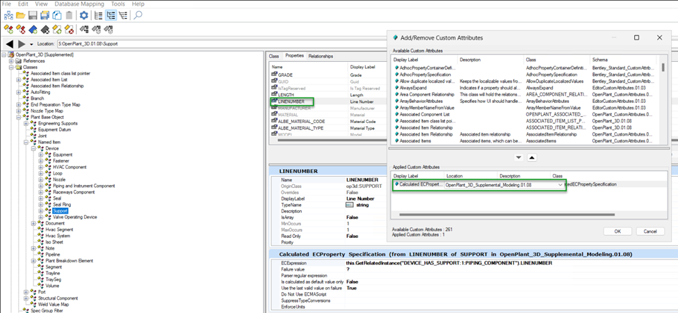

5. Apply same procedure for Line Number and Name.
6. Save and close the Class Editor. Restart the machine and verify the result.
