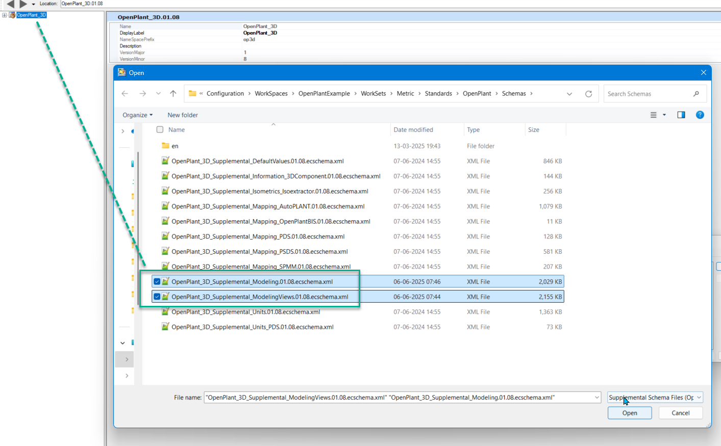

  1. In the schema editor open “OpenPlant_3D.01.08.ecschema.xml” and supplement it with “OpenPlant_3D_Supplemental_Modeling.01.08.ecschema.xml” & “OpenPlant_3D_Supplemental_ModelingViews.01.08.ecschema.xml”.

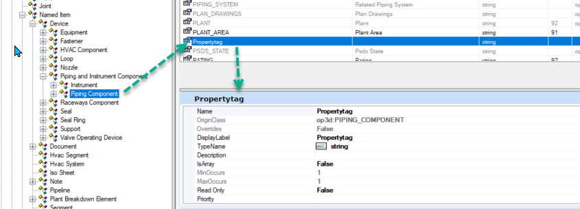

  2. Goto piping component class and create a new property here we are creating “Propertytag
    NOTE: Same Property must be added under Instrument Class as well.

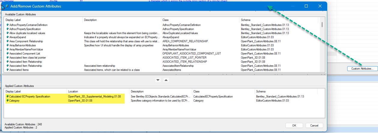

  3. Then add a Calculated EC Property Specification and change its location to OpenPlant_3D_Supplemental_Modeling.01.08.ecschema.xml

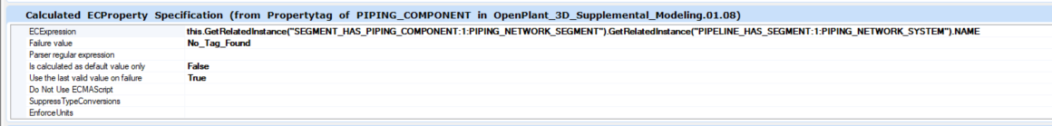

  4. Add the following expression against EC Expression and give a failure value.
    this.GetRelatedInstance("SEGMENT_HAS_PIPING_COMPONENT:1:PIPING_NETWORK_SEGMENT").GetRelatedInstance("PIPELINE_HAS_SEGMENT:1:PIPING_NETWORK_SYSTEM").NAME

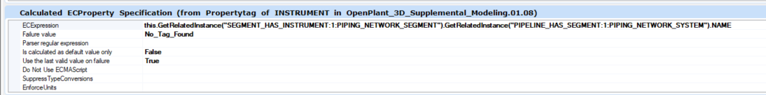

  6. Repeat steps 2 to 5, however the EC Expression for Instrument will be
    this.GetRelatedInstance("SEGMENT_HAS_INSTRUMENT:1:PIPING_NETWORK_SEGMENT").GetRelatedInstance("PIPELINE_HAS_SEGMENT:1:PIPING_NETWORK_SYSTEM").NAME

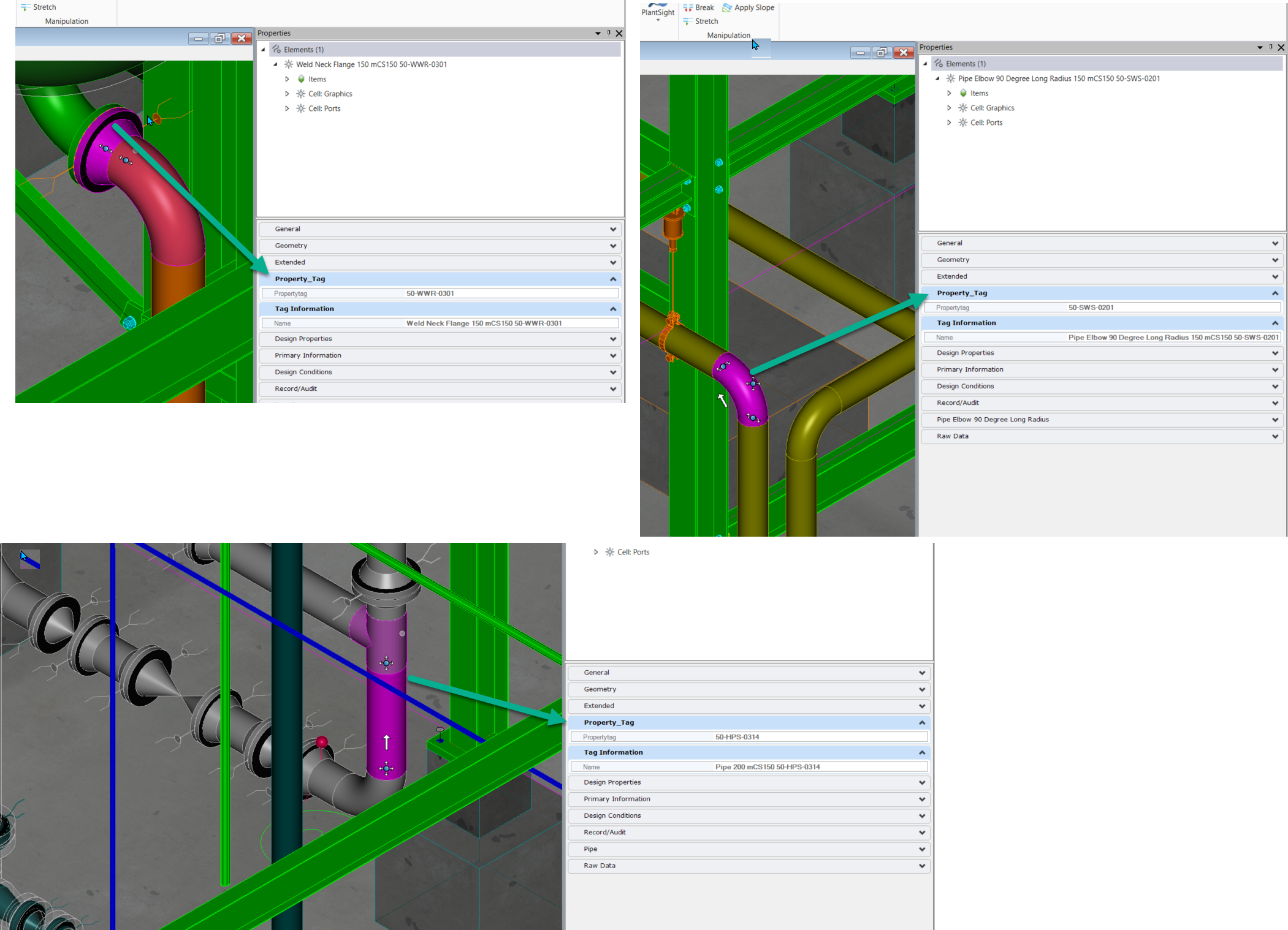

  7. After making the above changes we can see the pipeline when we open properties for a piping component.
