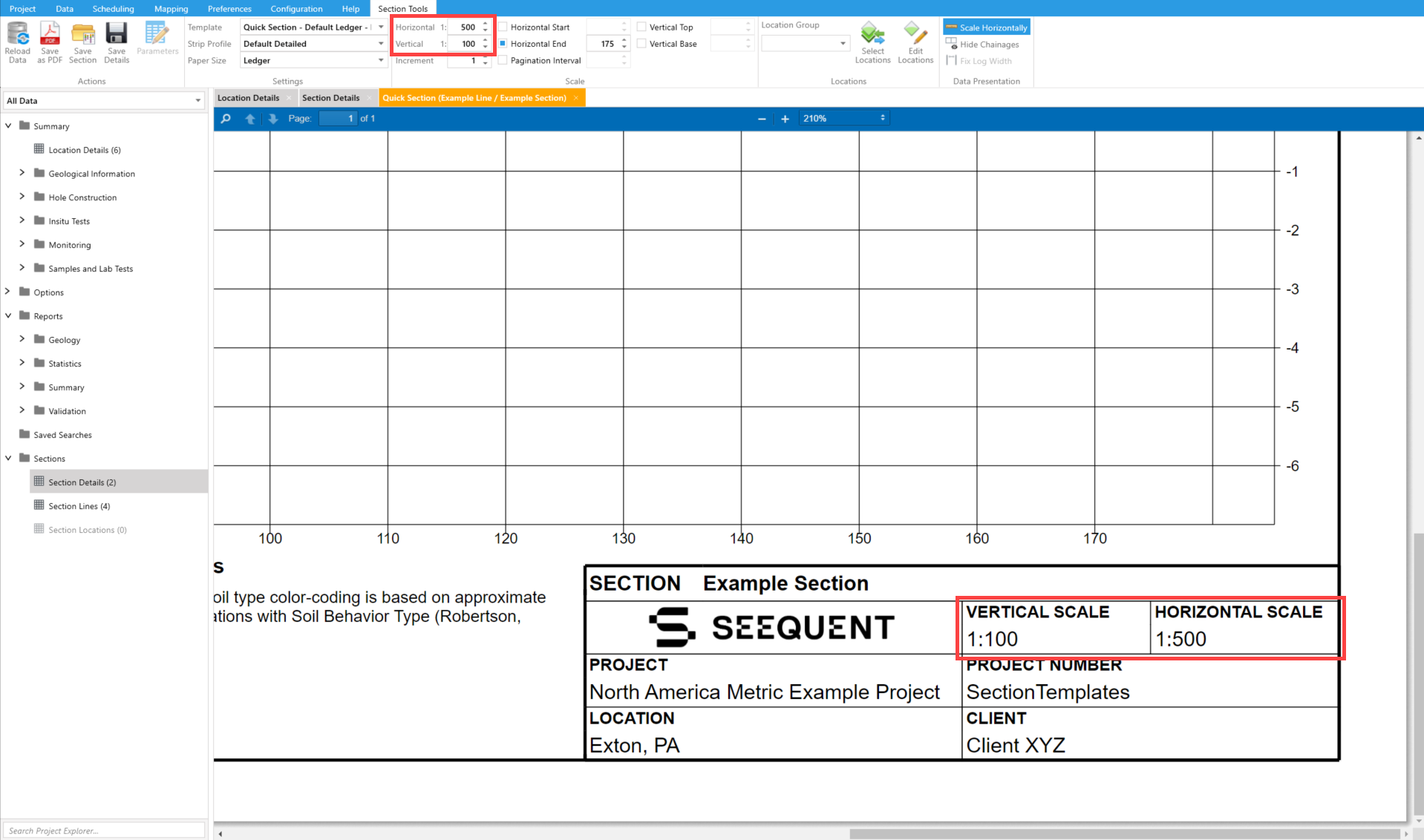

When generating a Quick Section, you enter Horizontal and Vertical Scales as a ratio of consistent units. For example, a 1:100 scale would mean that 1 m on the Section would represent 100 m in real life (or similarly, 1 ft on the Section would represent 100 ft in real life).
Similarly, when printed on a Quick Section template using the Horizontal Scale object and Vertical Scale object, the scale is represented as a ratio:

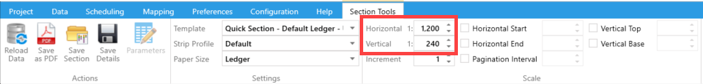

Entering Imperial Scales
When working with Imperial scales, you will still need to enter your scale as a ratio of consistent units. You will want to use a scale factor that is a multiple of 12.
The table below lists the ratio you would need to use for some common Imperial scales:
Imperial Scale  Scale Ratio
1”=10’ 1:120
1”=20’ 1:240
1”=30’ 1:360
1”=40’ 1:480
1”=50’ 1:600
1”=60’ 1:720
1”=70’ 1:840
1”=80’ 1:960
1”=90’ 1:1080
1”=100’ 1:1200
1”=150’ 1:1800
1”=200’ 1:2400
1”=300’ 1:3600
1”=400’ 1:4800
1”=500’ 1:6000

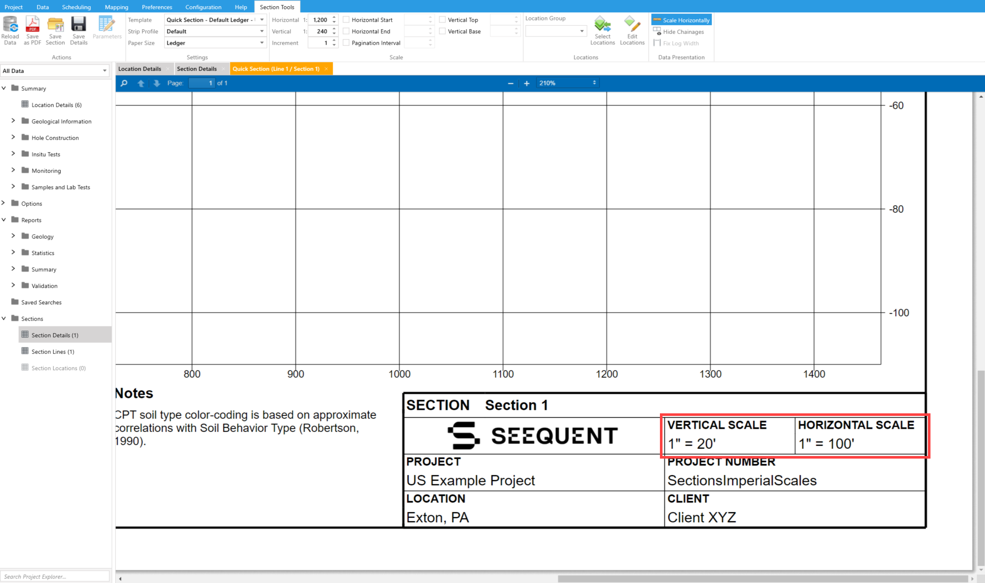

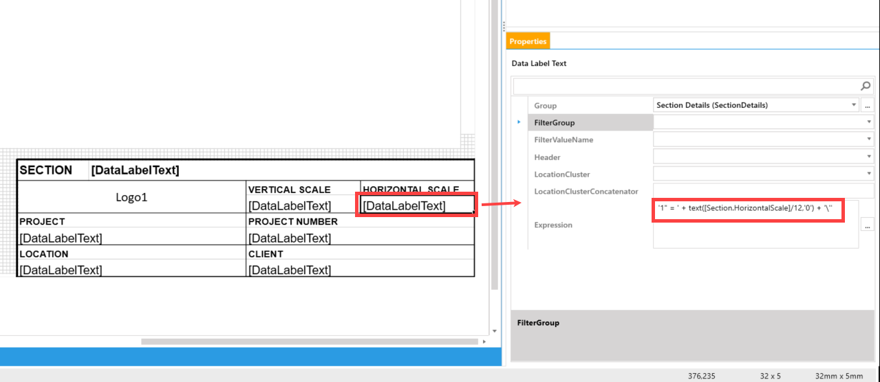

Printing Imperial Scales on Quick Section Templates
To print an Imperial scale on a Quick Section template, you will need to use a Data Label Text object instead of a Horizontal Scale object or Vertical Scale object.
You can then use Expressions, along with the [Section.HorizontalScale] and [Section.VerticalScale] Section Functions, to generate the Imperial Scale, as described below.
Basic Expression
These expressions will print the horizontal and vertical scales in 1”=XX’ Imperial scale format:
Horizontal Scale
if(
  isblank([Section.HorizontalScale]),
  'Not To Scale',
  '1" = ' + text([Section.HorizontalScale]/12,'0.#') + '\''
Vertical Scale
'1" = ' + text([Section.VerticalScale]/12,'0.#') + '\''

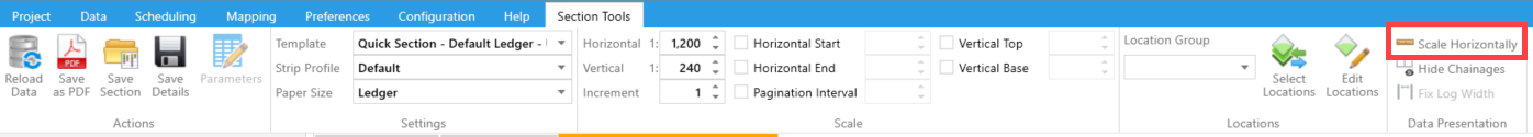

Sections Not to Horizontal Scale
It is possible to have a Quick Section that is not to horizontal scale by disabling the Scale Horizontally option (in which case the Locations will be evenly-spaced).
In this scenario, [Section.HorizontalScale] will not return anything.
This is why the expressions above that reference the [Section.HorizontalScale] function contain the check below using if() and isblank() to return 'Not To Scale' in such scenarios:

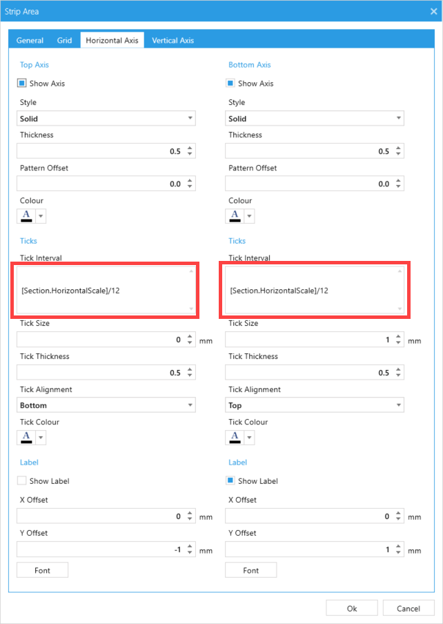

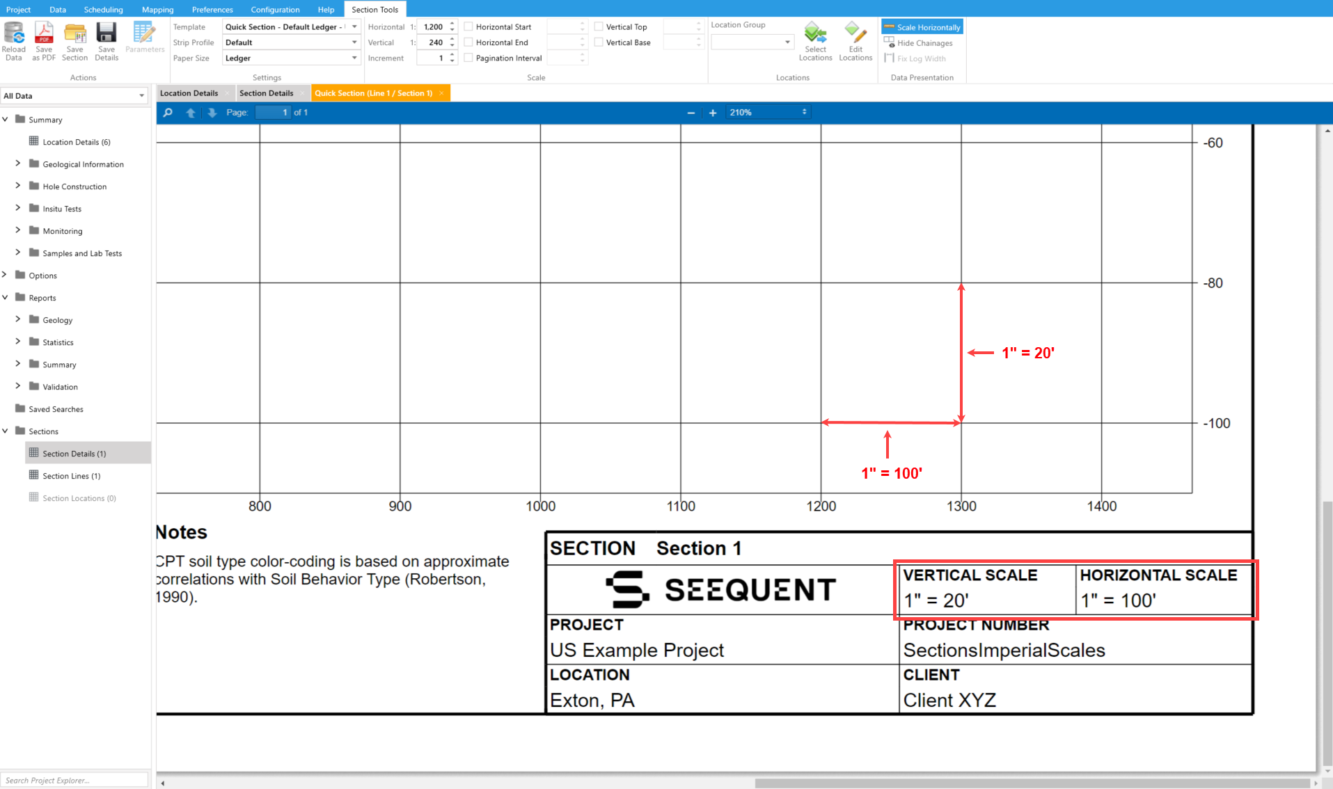

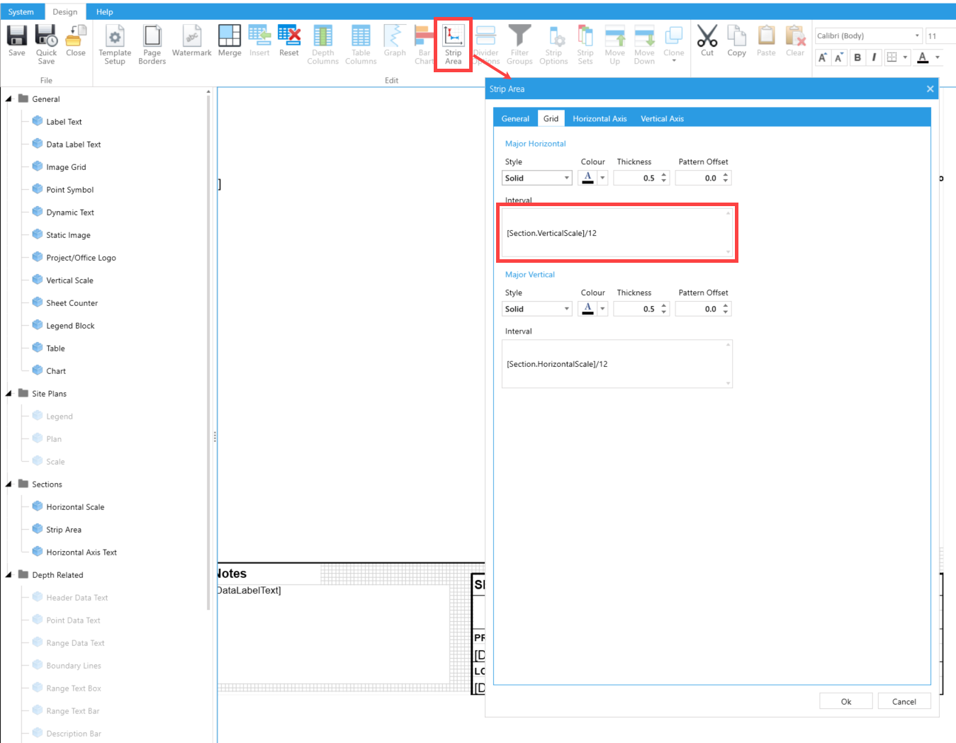

1-inch Strip Area Intervals
Another thing you might want to do when working with Imperial scales is use Grid and Axis Tick Intervals within the Strip Area that are equal to 1 inch so that they conveniently align with the scale.
Note – When a Quick Section is generated, OpenGround ensures that nice whole numbers are used for the Grid and Axis Intervals. Accordingly, the approach below only works when using a denominator for the scale that is a multiple of 12. If that is not the case, the intervals will not be a nice whole number and the program will round to a more suitable interval, which will not be 1 inch.

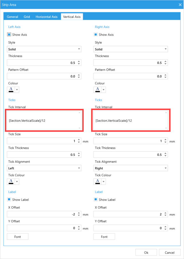

Horizontal Grid & Vertical Axis Tick Intervals
This expression can be used to generate 1-inch Horizontal Grid Intervals and Vertical Axis Tick Intervals when an Imperial scale is used:

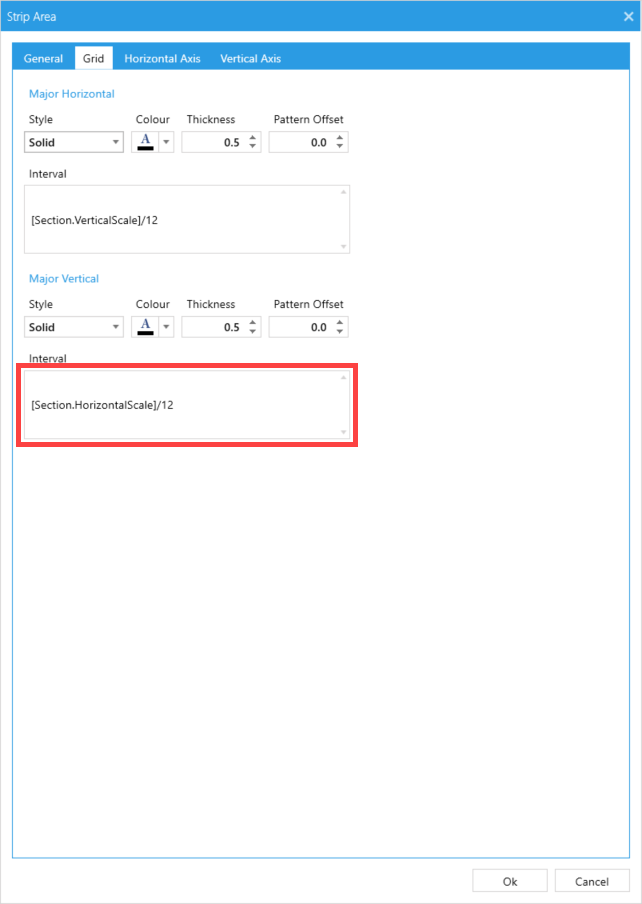

Vertical Grid & Horizontal Axis Tick Intervals
This expression can be used to generate 1-inch Vertical Grid Intervals and Horizontal Axis Tick Intervals when an Imperial scale is used:
Note: If the Scale Horizontally option is disabled, Vertical grid lines and Horizontal Axis ticks will not be drawn, so the expressions above will essentially be disregarded.
