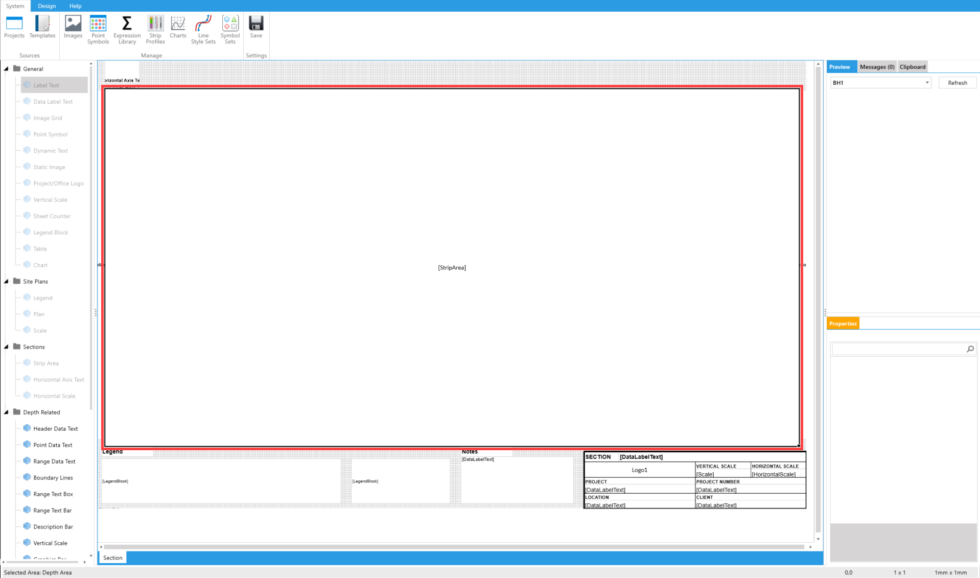

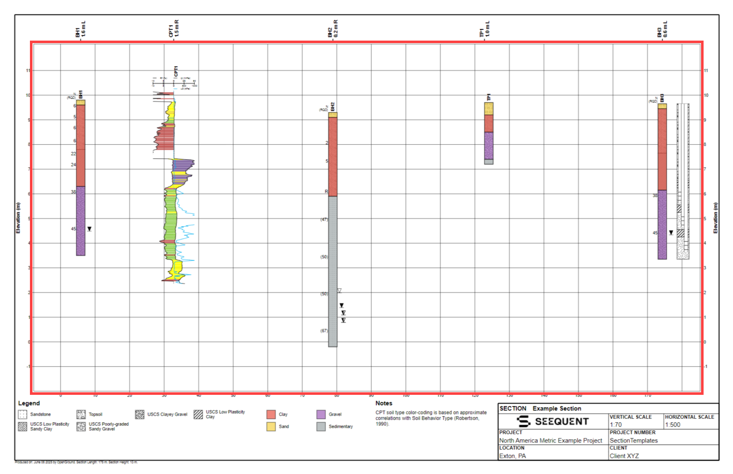

The Strip Area object is used to place the actual body of the section on new Quick Section templates. Various properties are available to configure the Strip Area’s Horizontal/Vertical Axes and Grid Lines.
The Strip Area can be placed anywhere within the grid.

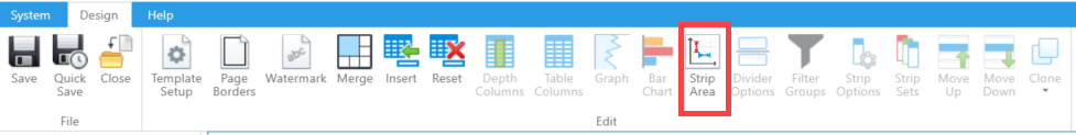

The Strip Area can be edited by selecting the Strip Area object within the grid and clicking the Design>Strip Area button. The various properties are described below.

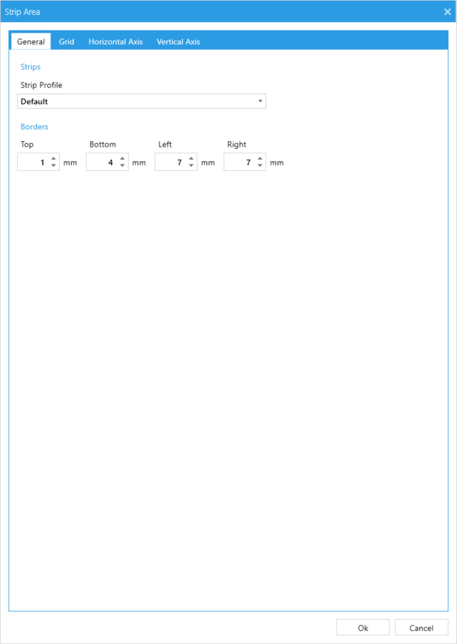

General Tab
Strip Profile
A Strip Profile can be selected, which determines the Strip template that will be used for each Location. Note – a different Strip Profile can be selected when the Quick Section is generated.
Borders
Borders/margins can be set within the Strip Area, such as to reserve space for Axis Labels.

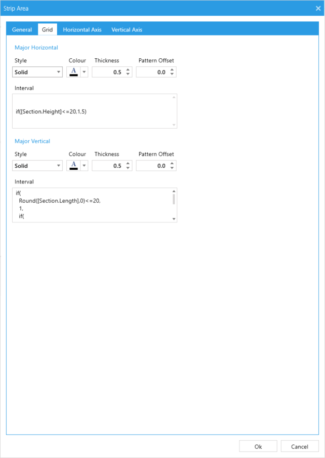

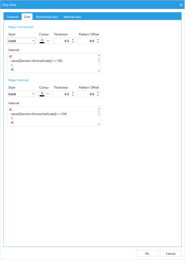

Grid Tab
These properties can be used to control the Grid lines within the Strip Area.
The Major Horizontal properties control the properties for the lines that run horizontally across the Strip Area.
The Major Vertical properties control the properties for the lines that run vertically.
Note: If the Scale Horizontally option is disabled, Vertical grid lines will not be drawn.
Style / Colour / Thickness / Pattern Offset
The pattern, colour, and thickness of the grid line.
If a Dashed or Dotted Pattern is used, the Pattern Offset can be used to control the spacing.
Interval
The Interval property accepts an expression for the spacing of the Grid lines. The expression can be a static value, such as 10, or a more complex expression.
For example, in the screen shot above, the Major Horizontal lines use an expression based on the Vertical Scale of the section. Depending on the Scale of the section, the Interval will be 1, 5, or a multiple of 10 units:
if(
  value([Section.VerticalScale])<=100,
  1,
  if(
    value([Section.VerticalScale])<=500,
    5,
    Round([Section.VerticalScale]/700,0) * 10
The Major Vertical lines use a similar expression based on the Horizontal Scale of the section.
if(
  value([Section.HorizontalScale])<=100,
  1,
  if(
    value([Section.HorizontalScale])<=500,
    5,
    Round([Section.HorizontalScale]/700,0) * 10
Please also see this article with additional suggestions and examples for Interval expressions when working with Imperial units.

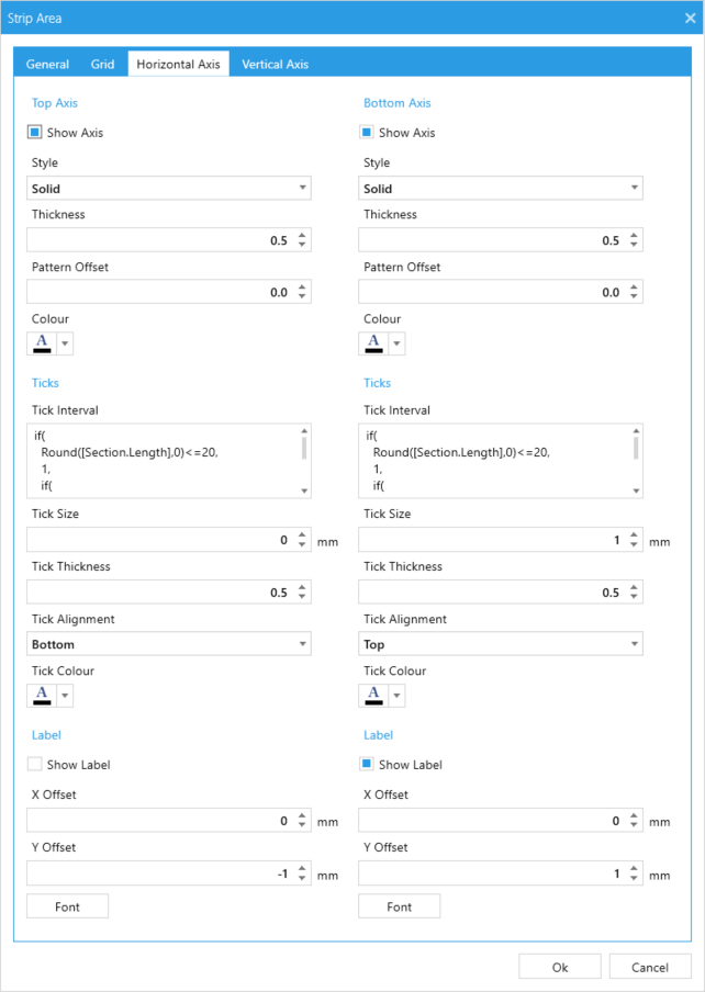

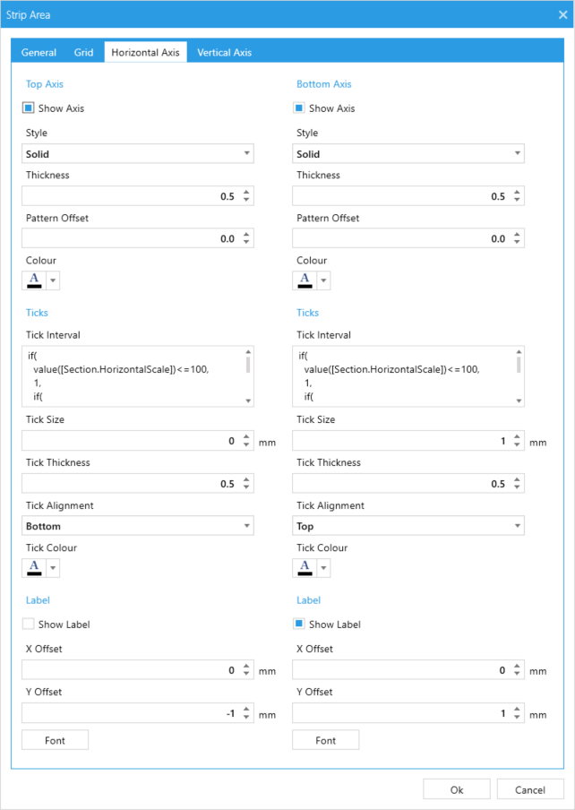

Horizontal Axis Tab
These properties can be used to control the styling, tick marks, and labels for the Horizontal Axis.
Show Axis
Can be used to turn on or off each axis line.
Style / Thickness / Pattern Offset / Colour
The pattern, thickness, and colour of the axis line.
Tick Interval
The Tick Interval property accepts an expression for the spacing of the Tick marks shown along the axis. The expression can be a static value, such as 10, or a more complex expression.
The expressions will often be the same or similar to those used for the Grid Intervals (see above).
Note: If the Scale Horizontally option is disabled, the Horizontal Axis ticks will not be drawn.

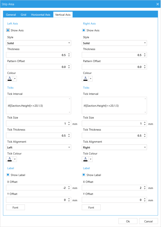

Vertical Axis Tab
These properties can be used to control the styling, tick marks, and labels for the Vertical Axis.
The Vertical Axis properties function essentially the same as the Horizontal Axis properties (see above).
