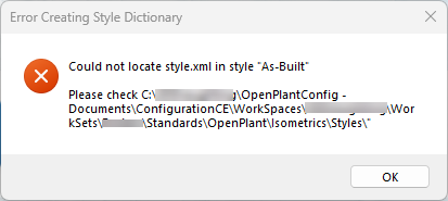

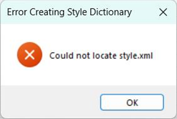

When generating isometrics in OpenPlant Isometrics Manager, users may encounter the following error: "Could not locate style.xml"
This issue typically occurs when the configuration is stored in OneDrive or ProjectWise drive.
