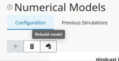

Rebuild i-model button
Whenever the hydraulic model is uploaded or re-uploaded but there are issues with the visualization of the model in WaterSight, or there are errors during the uploading process, make sure to click on this button to force a complete rebuild of the model. After that try to reupload or upload the model again.
Note: There is no risk to loose any information by pressing in this button.
This button is accessible through the Admin >> Numerical Model, and is located above the table
