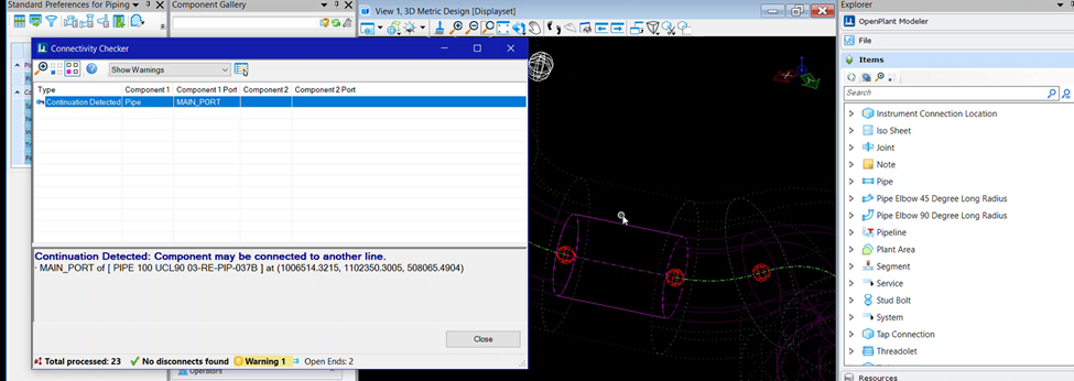

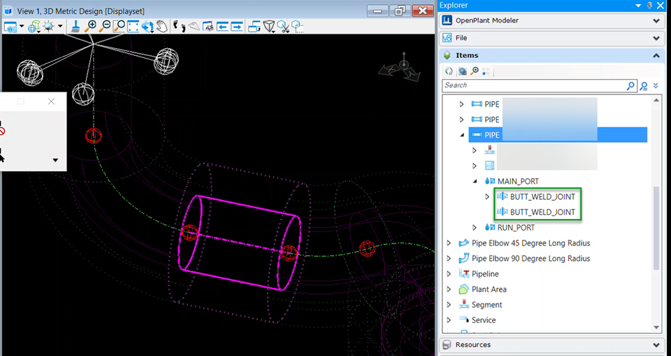

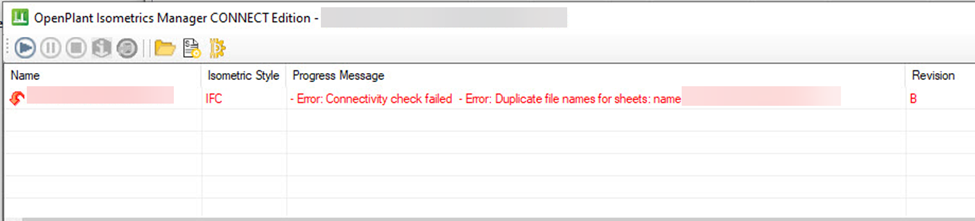

The error message Error: Connectivity check failed - Error: Duplicate file names for sheets: name appears during isometric generation. The cause of error is due to existence of orphan joints in the dgn. For instance, pipes having two weld joints. To eliminate the orphan joints, a key-in must be applied.
1. In an opened dgn in OpenPlant Modeler, run the Connectivity Checker to determine which component has an issue.

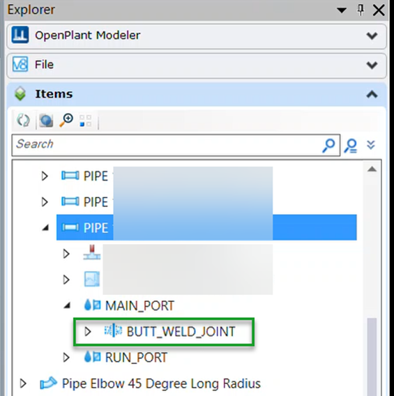

2. In the File Explorer, locate which component has the orphan joints.

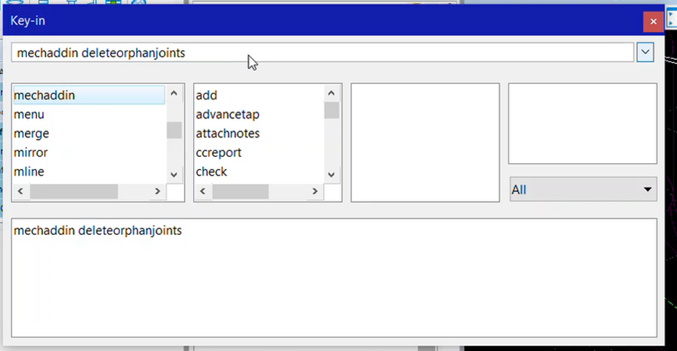

3. Apply mechaddin deleteorphanjoints in the Key-In.
4. Check and observe the File Explorer. The other joint is eliminated.

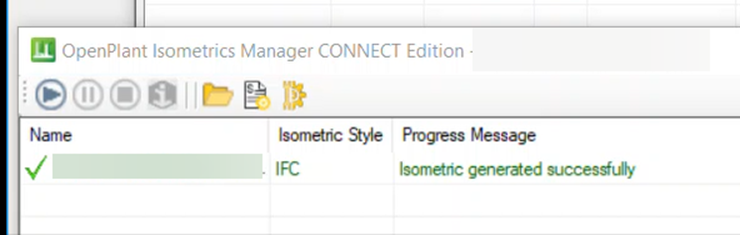

5. Generate the isometrics and verify the result.
