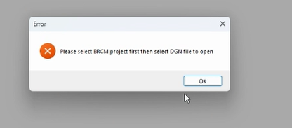

In Bentley Raceway and Cable Management CONNECT Edition, users may attempt to create a new Workspace and WorkSet using the "Create WorkSpace" option. However, when creating a new DGN file within this setup, the following error may appear: "Please select BRCM project first, then select DGN file to open."
A screenshot of a computerAI-generated content may be incorrect.
Although the drawing opens, users are unable to load a model or display a 3D view. This issue occurs because the new Workspace and WorkSet are not yet associated with a valid BRCM project configuration.

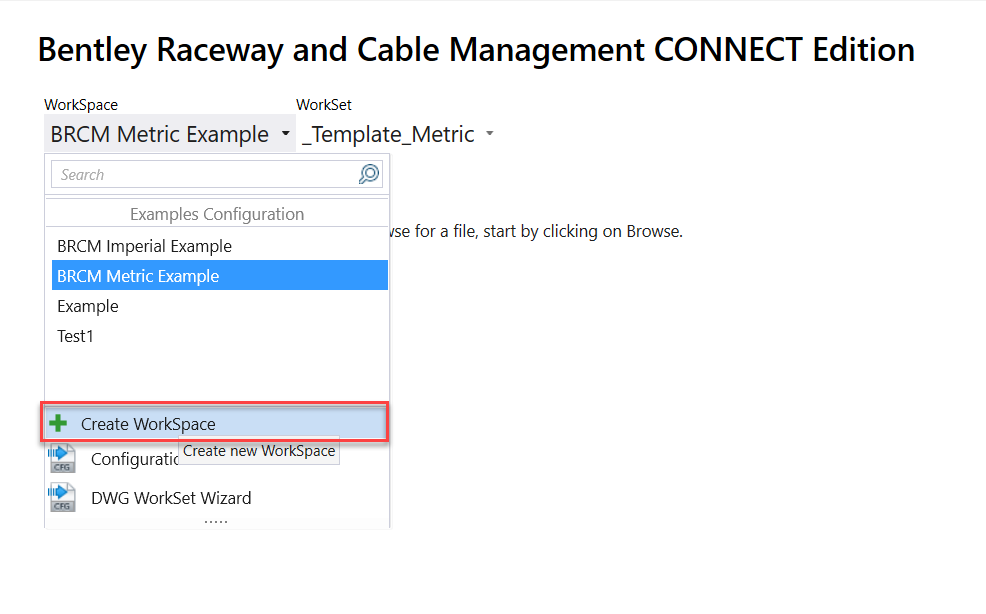

  1. Launch Bentley Raceway and Cable Management CONNECT Edition
  2. On the Work Page, click the WorkSpace drop-down and select "Create WorkSpace"
  3. Enter a Workspace name and optional description, then click OK.
  4. Click "Create WorkSet", provide a WorkSet name, and associate it with the new Workspace.

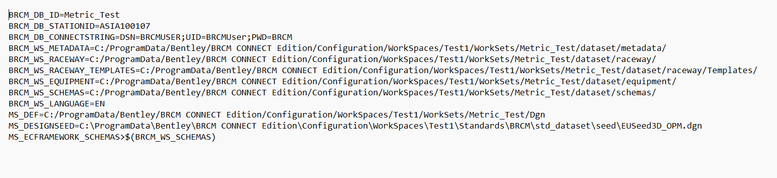

  1. Navigate to the copied WorkSet’s configuration file:
C:\ProgramData\Bentley\BRCM CONNECT Edition\Configuration\WorkSpaces\[ Workspace Name]\WorkSets\\[ WorkSet Name]\Standards\BRCM\BRCM.cfg
  1. Open BRCM.cfg and update the DB_ID, and any path entries pointing to the old Workspace or WorkSet. Refer snapshot below.
    A close-up of a textAI-generated content may be incorrect.
  2. Save the file and restart BRCM.
