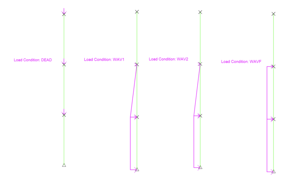

To illustrate how the load sequence works, consider the following example, where there are four load conditions are defined:
  1. DEAD load for vertical load
  2. WAV1: first wave load
  3. WAV2: second wave load
  4. WAVF: Final wave load

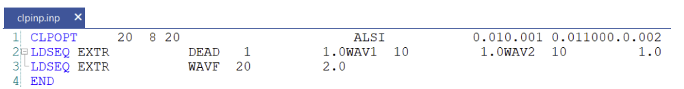

In the collapse input file, we can apply the above load conditions sequentially, as defined in the following example:
First, the DEAD load condition is applied one step up to load factor 1.0. Then, WAVI uses
10 steps until it reaches load factor 1.0. After that, WAV2 similarly uses 10 steps. Finally,
the final WAVF is applied using 20 steps until it reaches load factor 2.0.

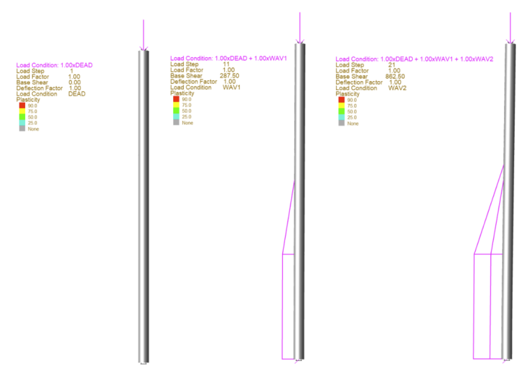

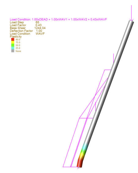

The following screenshot shows the loads, the model deformation, and the plasticity at different load steps:
As shown above, the Collapse program applies the load conditions sequentially to the model, and plastic strains and stresses are carried over from one step to another.
