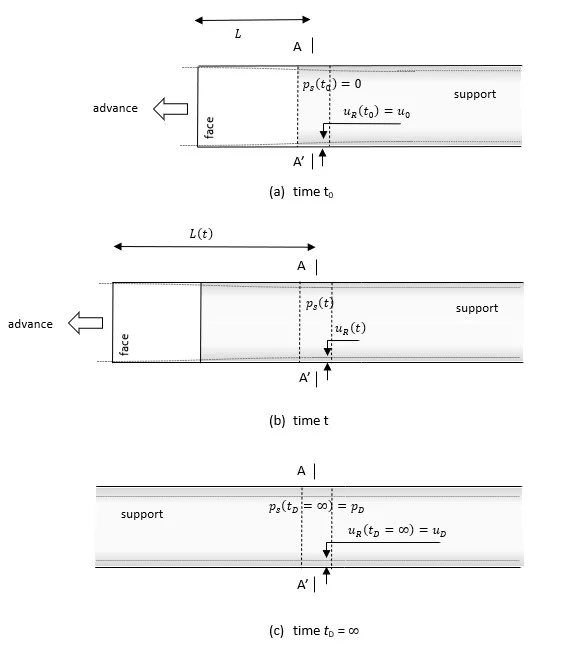

The basis of the Convergence-Confinement Method has been perfectly summarised by Carranza Torres and Fairhurst (2000), from which we have extracted the upcoming elements illustrating the main principles of the Convergence-Confinement Method as shown in Figure 1:
Figure 1: Loading of the support at section A-A’ due to progressive advance of the tunnel face (after Carranza and Fairhurst, 2000).

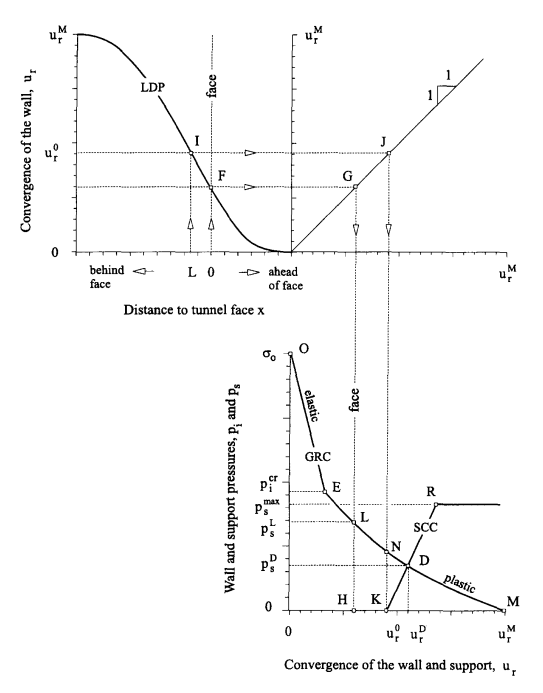

Figure 2: Schematic representation of the Longitudinal Deformation Profile (LDP), Ground Reaction Curve (GRC), and Support Characteristic Curve (SCC) (after Carranza and Fairhurst, 2000).
As can be seen from Figure 1, the determination of the load transferred to the support requires an analysis of the interaction of the load-deformation characteristics of the elements comprising the system:
As illustrated in Figure 2, the three basic components of the Convergence-Confinement Method are therefore:

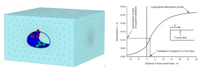

The LDP is the graphical representation of the radial displacement that occurs along the axis of an unsupported excavation – for sections located ahead of and behind the face. It enables the user to determine the amount of radial displacement that will take place at the tunnel boundary (and corresponding amount of rock stress release) before the installation (and therefore associated loading) of stiff support will take place.
LDP is used to calibrate the staged plane strain 2D model in which the inner tunnel core will be replaced by incrementally relaxing boundary tractions to simulate a progressive reduction of a “fictitious” internal support pressure applied at the tunnel wall:
pf = 1 - λ (σ)0
where 0 is the initial stress state and is the deconfining rate.

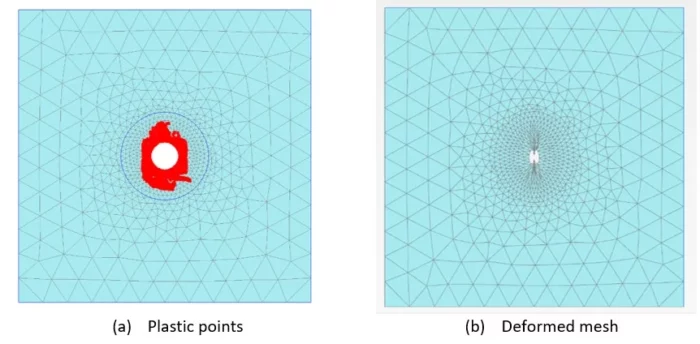

For uniform or isotropic initial stress conditions and circular tunnel cross-sections, the LDP can be calculated using axisymmetric models or analytical formulas as introduced by Panet (1995). However, for most situations (anisotropic state of stresses, non-circular tunnel cross-section, etc.), three-dimensional analyses will provide the most accurate LDP curves (see Figure 3).
Figure 3: Use of PLAXIS 3D numerical analysis for the obtention of the LCD for a horseshoe tunnel.
Such analyses could advantageously be set up using the PLAXIS Tunnel Designer functionality to ease the creation of the 3D geometry from a simple 2D cross-section definition and speed up construction stage setup where the incremental tunnel construction process must be accurately taken into consideration.

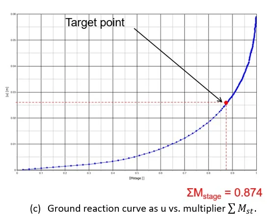

The Ground Reaction Curve can simply be obtained by running a PLAXIS 2D plane strain analysis with the consideration of a full tunnel excavation without any means of support. Such analysis will enable the monitoring of the tunnel wall radial displacement versus the staged construction multiplier ΣMst (which in that case exactly equals the deconfinement rate) as illustrated in Figure 4.
Figure 4: PLAXIS 2D for the determination of the Ground Reaction Curve.

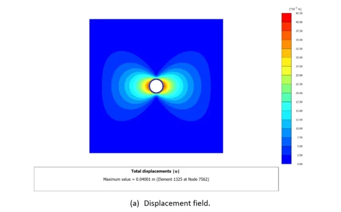

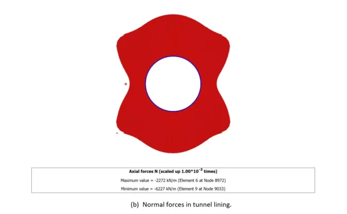

Figure 5: PLAXIS 2D analysis results after activation of the tunnel support.
The obtained GRC will then be used to evaluate the equivalent deconfinement level that will provide the same radial tunnel wall displacement as given by the LDP at a distance L from the front tail where the support is meant to be activated.
The Support Characteristic Curve will be implicitly provided in a separate and similar 2D plane strain analysis with the additional activation of the tunnel support at the appropriate level of confinement found during previous analysis (as deduced in Figure 4c). An example of such type of 2D analyses is presented in Figure 5.
