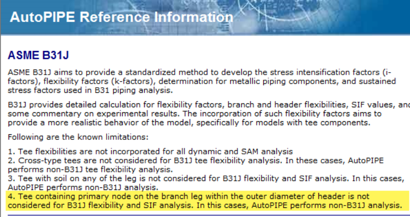

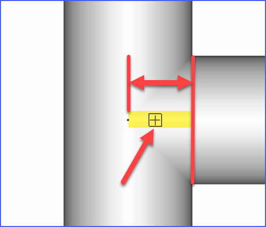

This is a limitation of the program that it cannot apply tee flexibilities when a tee branch has a node within a distance of Header D/2 from tee center:
Avoidance:
Remove all branch node points that exist within the radial distance of the tee header. Another words, if there is a node point insider of the header pipe of a tee, delete it.
