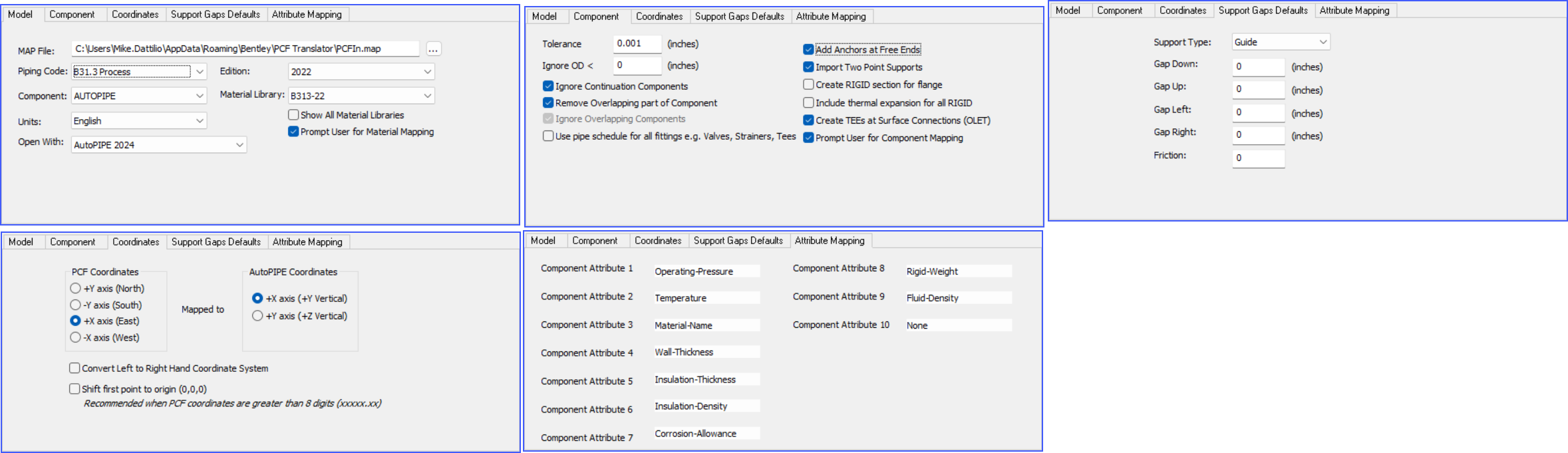

- Import example PCF with attributes defined
The following can be copied from to a blank notepad++ file. Save the files as "Example 1 PCF with attributes.PCF"
================================================================== (do not copy)
ISOGEN-FILES ISOGEN.FLS
UNITS-BORE INCH
UNITS-CO-ORDS INCH
UNITS-WEIGHT LBS
UNITS-BOLT-DIA INCH
UNITS-BOLT-LENGTH INCH
UNITS-WEIGHT-LENGTH FEET
PIPE
    END-POINT        -462.7500      99.6683       0.9727       2.0000
    END-POINT        -462.7500     122.8750       0.9727       2.0000
    UNIQUE-COMPONENT-IDENTIFIER     E66AB067-719B-49A9-81C4-C9A848E79754
    FABRICATION-ITEM
    ITEM-CODE  5
    COMPONENT-ATTRIBUTE1 111
    COMPONENT-ATTRIBUTE2 222
    COMPONENT-ATTRIBUTE3 A106-B
    COMPONENT-ATTRIBUTE4 0.218
    COMPONENT-ATTRIBUTE5 0.55
    COMPONENT-ATTRIBUTE6 6.66
    COMPONENT-ATTRIBUTE7 0.07
    COMPONENT-ATTRIBUTE8
    COMPONENT-ATTRIBUTE9 70
    COMPONENT-ATTRIBUTE10
    PIPING-SPEC C11R
MATERIALS
ITEM-CODE 5
    DESCRIPTION PIPE,2"
Import the file using the following PCF settings:
While importing the PCF file, the translator will generate a *.LOG file in the same folder. Open this file in any text editor for review .
