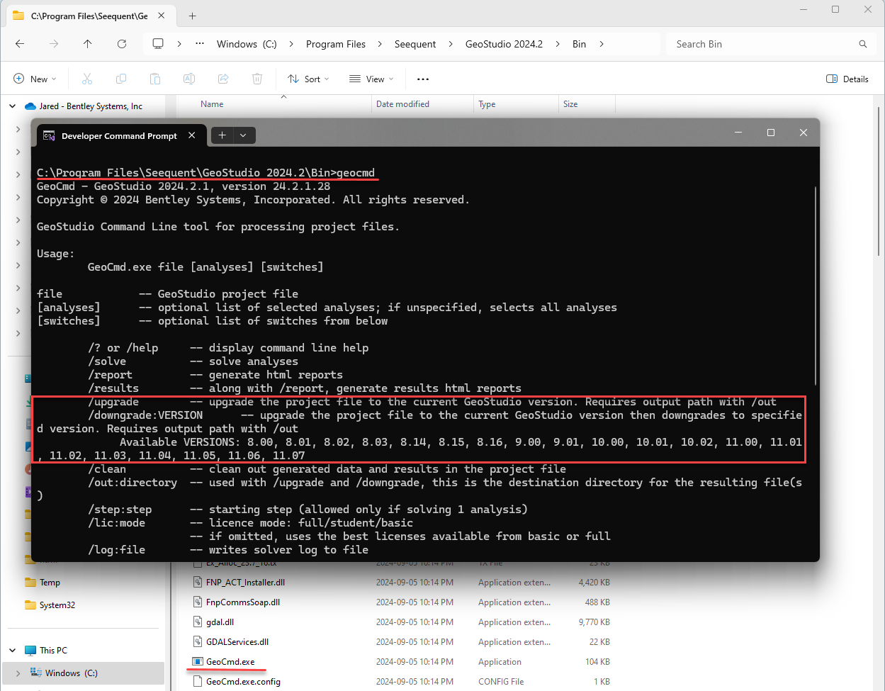

File Upgrade / Downgrade with GeoCmd.exe
GeoCmd.exe is a command line utility for processing GeoStudio files.  Full details for using GeoCmd.exe can be found in the GeoStudio Help Menu.
One feature of GeoCmd.exe is the ability to upgrade / downgrade GeoStudio files.  Refer to the Help Menu documentation, or run the geocmd.exe program from the command line (without any arguments) for an explanation:
GeoCmd.exe
GeoCmd.exe can be used to batch process multiple analysis files.  Download the following zip file for both a batch file and python script example.
