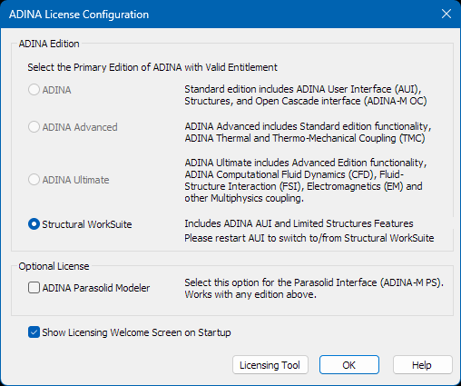

For Structural WorkSuite Entitlement holders, a new product called ADINA SWS has been created and may be selected when launching the ADINA AUI.
A single installation file installs all of the ADINA Tiers including this new Structural WorkSuite version. The ADINA Parasolid Modeler is not included but may be purchased as an add-on. Otherwise solid modeling based on OpenCascade is available to all.

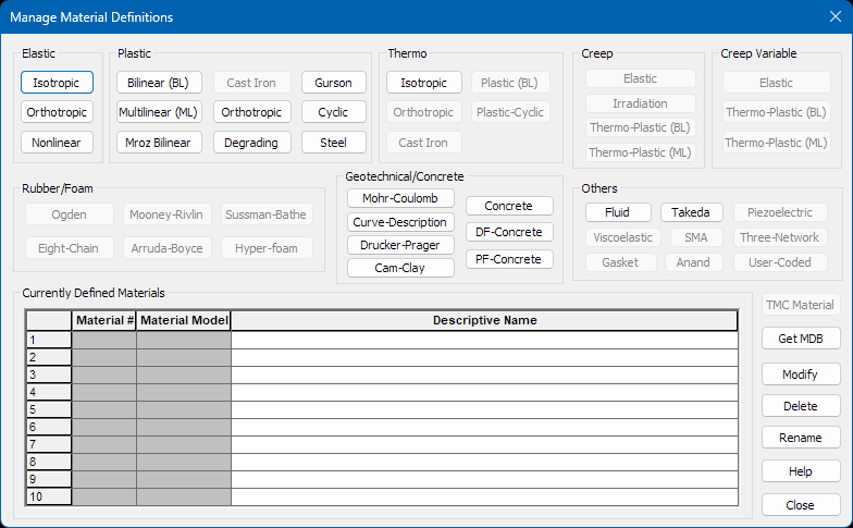

Materials which are not allowed in ADINA SWS are greyed out in the Manage Material Definitions dialog box within ADINA AUI, but advanced structural materials including plastic steel, isotropic thermo, and several advanced concrete materials are included:
