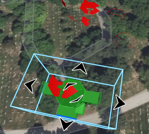

The Edit Extents tool lets you easily adjust the extents by moving the arrows on the bounding box. You can quickly identify the position of the geometry based on its color (Image 1):
Image 1 - Editing iModel Display Extents
NOTE: If certain elements are far from the extents boundary, they may not be rendered. Depending on your needs, you may need to update the source files to position these elements correctly or delete them. For more information about potential issues and the best solutions, click here.

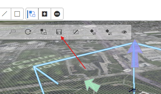

Once you are satisfied with your adjustments, don't forget to click Save to apply your changes (Image 2). If you cancel the extents editing or close the application without saving, no changes will be made to the iModel.

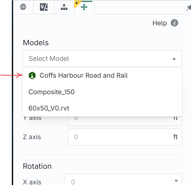

Offset individual models
To transform the position of a model, click the Transformation tool and select the model from the dropdown list. The XYZ and Rotation fields allow for manual entry and offsetting the model in any direction.
You can modify any number of models as needed. If multiple models are transformed, the dropdown will show an unsaved changes icon next to the model names, and a Transformation Summary will appear, detailing the positional changes for each model.
Once you are satisfied with your adjustments, click Save Transforms to apply the changes. If you choose to Reset or close the application without saving, no changes will be made to the iModel.

Translate and rotate iModel

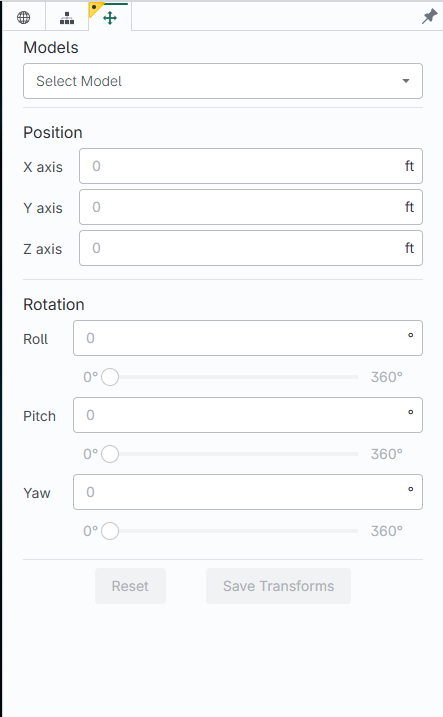

To adjust the position of the whole iModel, click the Transformation tool and select the iModel from the dropdown list. The iModel will have a dedicated iModel icon (Image 4).
Image 4 - iModel selection in the Transformations widget example

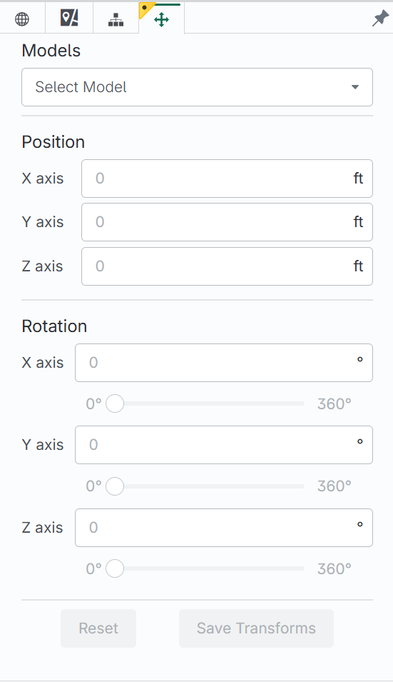

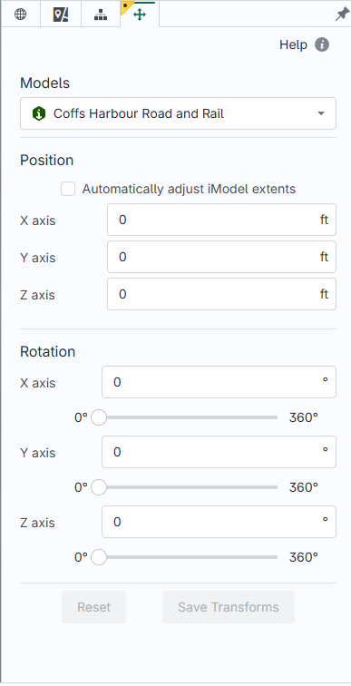

Once iModel is chosen as a transformation target, the Position and Rotation fields allow for manual entry and offsetting the location in any direction (Image 5). Once you are satisfied with your adjustments, click Save Transforms to apply the changes. If you choose to Reset or close the application without saving, no changes will be made to the iModel.
Changes to iModel must be saved or reset before you can adjust any individual model.
Image 5 - Transformation widget example for iModel offsets
NOTE: The distance you can move your iModel from its origin will be limited. Once you move an iModel or model more than 2km, distortion or inaccuracies can occur. Visually, this means that the iModel or model will start floating above the Earth the further it moves away from its original origin. While 2km is a good estimate, the actual distance will vary depending on the iModel's specific geolocation - locations closer to the equator will be more forgiving than locations closer to the Earth's poles.
Behavior outside of iModel Display Extents
Offsetting an iModel does not change the existing iModel Display Extents boundaries. If you move the iModel outside of the extents boundary, those elements may not be rendered.
Depending on your needs, you can choose to check the Automatically adjust iModel extents, that way existing extents boundaries will move together with iModel. Or you can adjust extents to the new required limits using the Edit Extents tool.

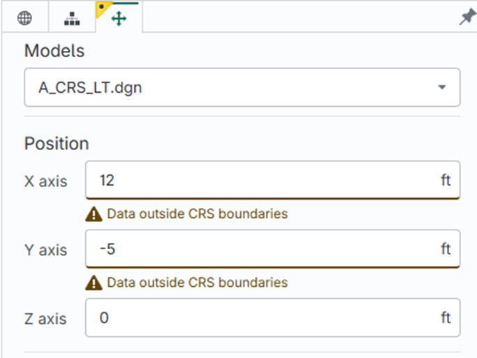

Ensure that model design data is contained within the chosen Coordinate Reference System (CRS) boundaries. Data located outside these boundaries can lead to various technical and practical issues. For example, when geometry is modeled far from the origin, it can result in precision and accuracy problems, as numerical precision decreases. This may lead to inaccuracies in geometry calculations. You might also experience performance issues, such as slower rendering and navigation, among others.
If, during transformation, the data is moved outside the specified boundary, a warning will be displayed.
Image 3 - Data outside CRS boundaries
Given that iModel has a valid CRS, you can view its boundaries by enabling the Show CRS Boundaries toggle in the Geospatial Metadata panel. More about it here.
