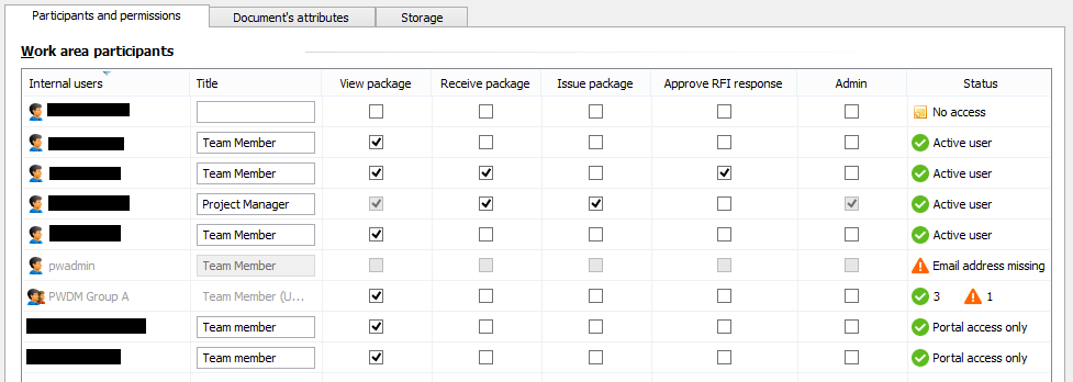

When you first open the Deliverables Management Settings dialog of your work area after associating it to a ProjectWise project, you will see that the Participants and permissions tab lists the ProjectWise users who are already participants of the work area, their current status as a ProjectWise project member, and their default Deliverables Management permissions in this project.

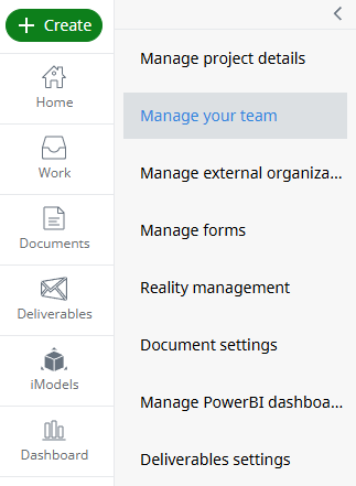

Deliverables Management service sync can add users but cannot remove them from the "Manage your team" section in the portal. That is why it is recommended that instead of using Deliverables Management user sync, users would either synchronize their work area users using ProjectWise Web connections user sync (automatic sync, that adds and removes users) or add them directly through "Manage your team" section in Infrastructure Cloud portal.

Note: Only ‘Project Owner’ role holders and IMS administrators can manage project settings in Infrastructure Cloud portal (Deliverables Management portal settings included).
Changing the Permissions of an Internal team member in the Deliverables Management connector for ProjectWise Explorer
You set the permissions for an internal team member when you add them to the project. It is recommended that you change these permissions from the Infrastructure Cloud portal “Manage your team” section by modifying the assigned user roles. However, it is also possible to modify some permissions in the Deliverables Management connector for ProjectWise Explorer.
  1. In ProjectWise Explorer, right-click the Deliverables Management node in the associated work area and select Settings.
The Deliverables Management Settings dialog opens.
  1. On the Participants and permissions tab, change the permissions for each internal participant as needed.
Permissions that can be added:

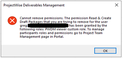

Note: You cannot remove “View package” or “Admin” permission from Deliverables Management connector for ProjectWise Explorer. To remove these permissions, go to Infrastructure Cloud Portal “Manage your team” section and remove the roles that extend these permissions. By default, these permissions are part of Team member and Project Administrator roles.
* If you created your own roles In Infrastructure Cloud portal with any of Deliverables Management permissions (Read & Create Draft Packages, Receive External Packages, Issue Packages, Approve RFI Response, Manage Settings) and assigned them to any of your team members, you will only be able to remove said roles and their permissions within “Manage your team” section in Infrastructure Cloud portal. Trying to remove permissions in Deliverables Management connector for ProjectWise Explorer will result in the following or similar error messages:

When you set permissions for a ProjectWise group or user list, all members of the group or user list inherit those permissions and get assigned the appropriate role in the Infrastructure Cloud portal. If a ProjectWise user is added to the internal participants list twice (once as an individual user, then again as a member of a group or user list), the permissions set for the individual user will override the permissions the user inherited from the group or user list they are a member of.
A screenshot of a computerAI-generated content may be incorrect.
For any ProjectWise user in the list who does not have an email address, you cannot configure any permissions, as the lack of email address prevents them from being an internal project team member.
