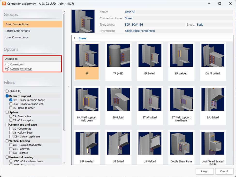

When a joint that belongs to a group is selected, the Assign Connection dialog includes a new option to choose whether to assign the connection to Current joint or to the Current joint group.
Figure 3. New option to select between Current joint or Current joint group to assign the connection.

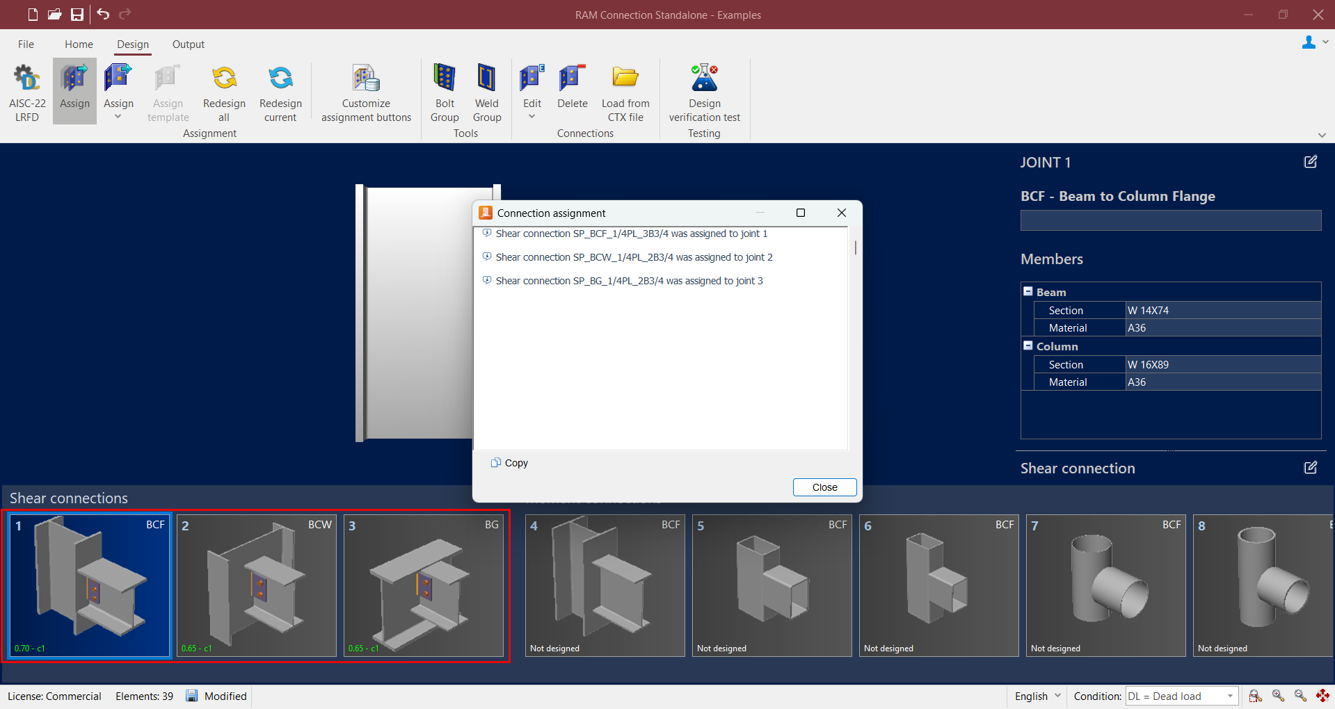

Selecting the group option will apply the chosen connection to all joints within that group, streamlining the modeling process and ensuring consistent detailing across similar joints.
Figure 4. All connections assigned at once to all joints in the group.

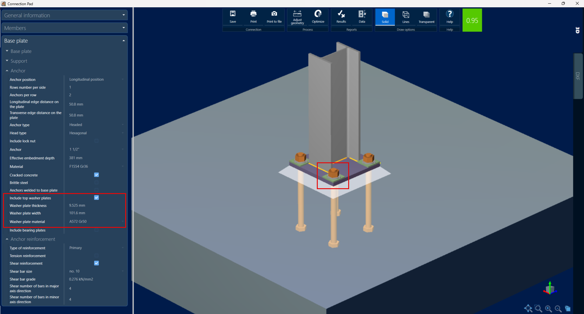

Washer Plates: The option to define washer plates has been added. When used, flexural capacity of anchor bolts is considered in the design calculations.
Figure 7. New top washer plates.

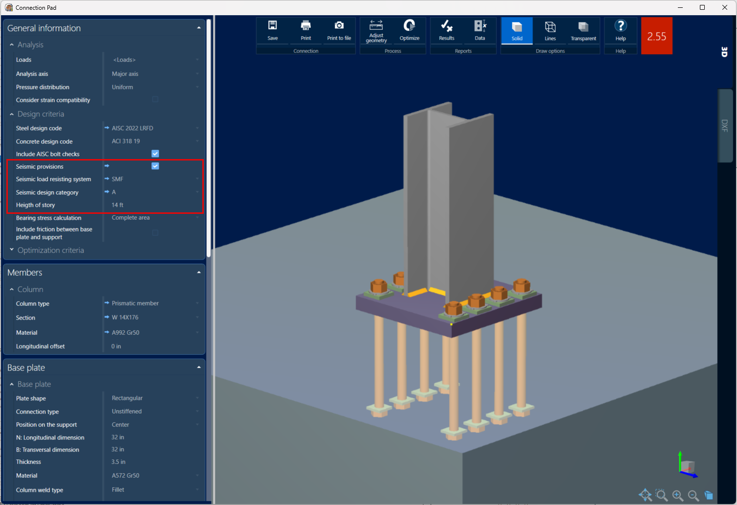

Seismic Provisions per AISC 341 Section D2.6c: The base plate now supports seismic design checks based on AISC 341, including the calculation of required shear and flexural strengths for anchor rods in accordance with Section D2.6c for moment frames.
Figure 8. Seismic provisions for moment frames according to AISC 341.

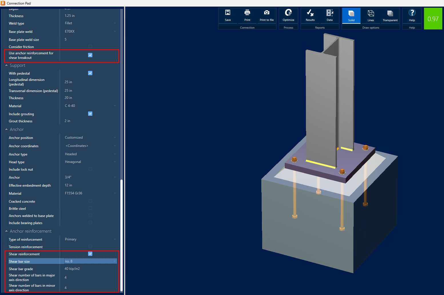

4. AISC Base Plate option to consider reinforcement for shear lug concrete breakout. A new option "Use anchor reinforcement for shear breakout" is now available for AISC base plates with shear lugs. When enabled, the defined anchor reinforcement is considered effective in resisting concrete breakout due to the shear lug in agreement with Anchorage Design for Petrochemical and Other Industrial Facilities (ASCE, 2nd Ed., 2022). As RAM Connection does not yet include reinforcement location, for more detailed procedure refer to the ASCE publication.
Figure 9. New reinforcement option for shear breakout for shear lugs.

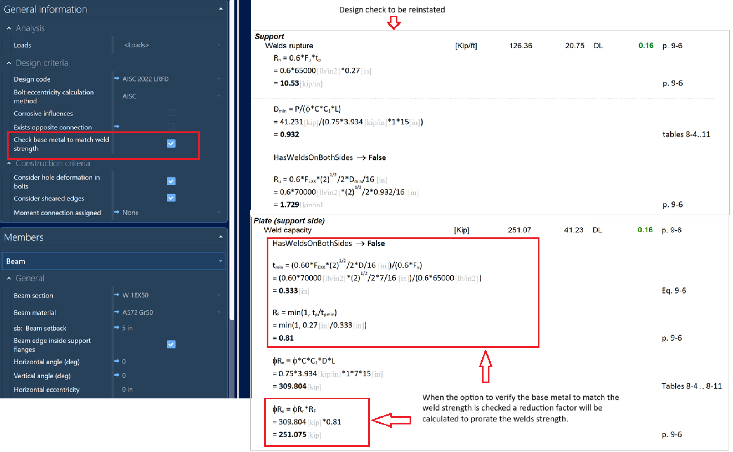

6. Optional Weld Strength Reduction to Match Base Metal Shear per AISC. This release reinstates the weld rupture check and introduces a new optional setting that reduces the weld capacity to match the shear strength of the connected base metal, following AISC provisions. When the option is enabled, a minimum required thickness for the connected elements is calculated using the equations provided in Part 9 of the AISC Steel Construction Manual. If the actual thickness is less than the required minimum, the weld strength is reduced proportionally by the ratio of the provided thickness to the minimum required thickness (Rf = t / tâ‚˜áµ˘â‚™). This check ensures more accurate and conservative designs in accordance with AISC, particularly where base metal rupture may control the connection strength.
Figure 10. Weld Strength Reduction to Match Base Metal
