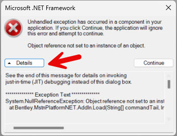

MicroStation .NET framework errors in Bentley software can stem from a variety of factors, including outdated Windows updates, corrupted .NET Framework installations, conflicts with other software, or incorrect MicroStation workspace settings.
The error can occur when initializing a drawing file or it can occur when performing a specific operation. In most cases the error can be ignored, and you can continue to work. However, this can become a nuisance when it repeatedly is popping up.
Some things to be considered are updating Windows, repairing or reinstalling the.NET Framework, checking workspace settings, and ensuring proper MicroStation configuration files.
Log a Support Case

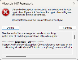

It is recommended that you log service case with the product support team. One of the things the team will need are the details of the error.
You want to copy all the details from this dialog and paste them in text editor like Notepad or a Word document. Send this document in as an attachment when logging your support case.
