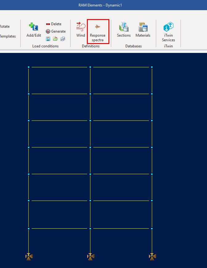

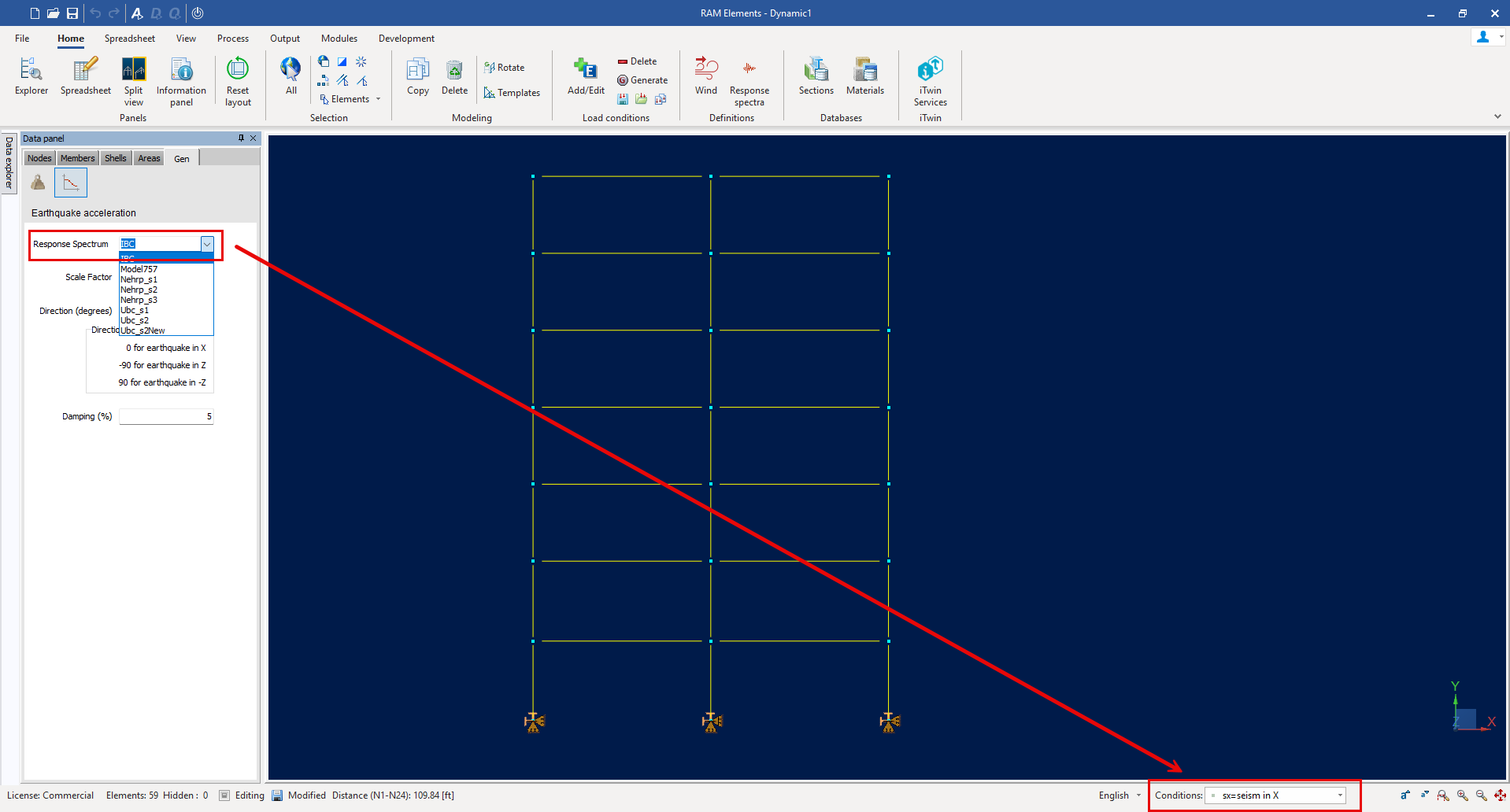

1. Multiple Response Spectra Support. It is now possible to assign and analyze multiple response spectra within a single model. Previously, only a single response spectrum could be used, which limited flexibility when addressing different code and loading requirements. This enhancement allows users to apply distinct spectra to different load cases, enabling more accurate and code-compliant analysis for complex structural scenarios.
Support for multiple response spectrum definitions has been added, allowing users to define and manage several spectra within the same model.

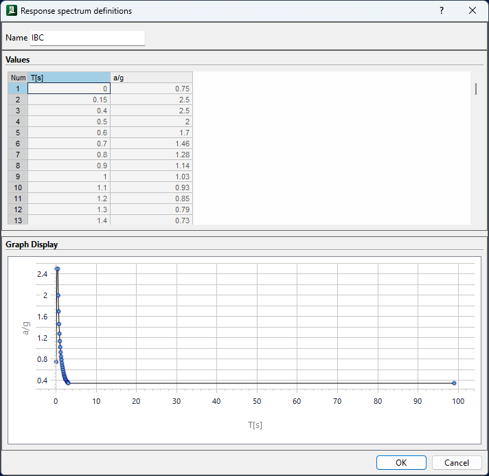

Figure 1. New Response Spectrum definitions
The interface to create and edit response spectrum definitions follows a structure similar to other database elements such as materials and sections. The Response Spectrum Definitions dialog consists of two main sections. The upper section provides a table where users can input the period T [s] and the corresponding acceleration ratio a/g

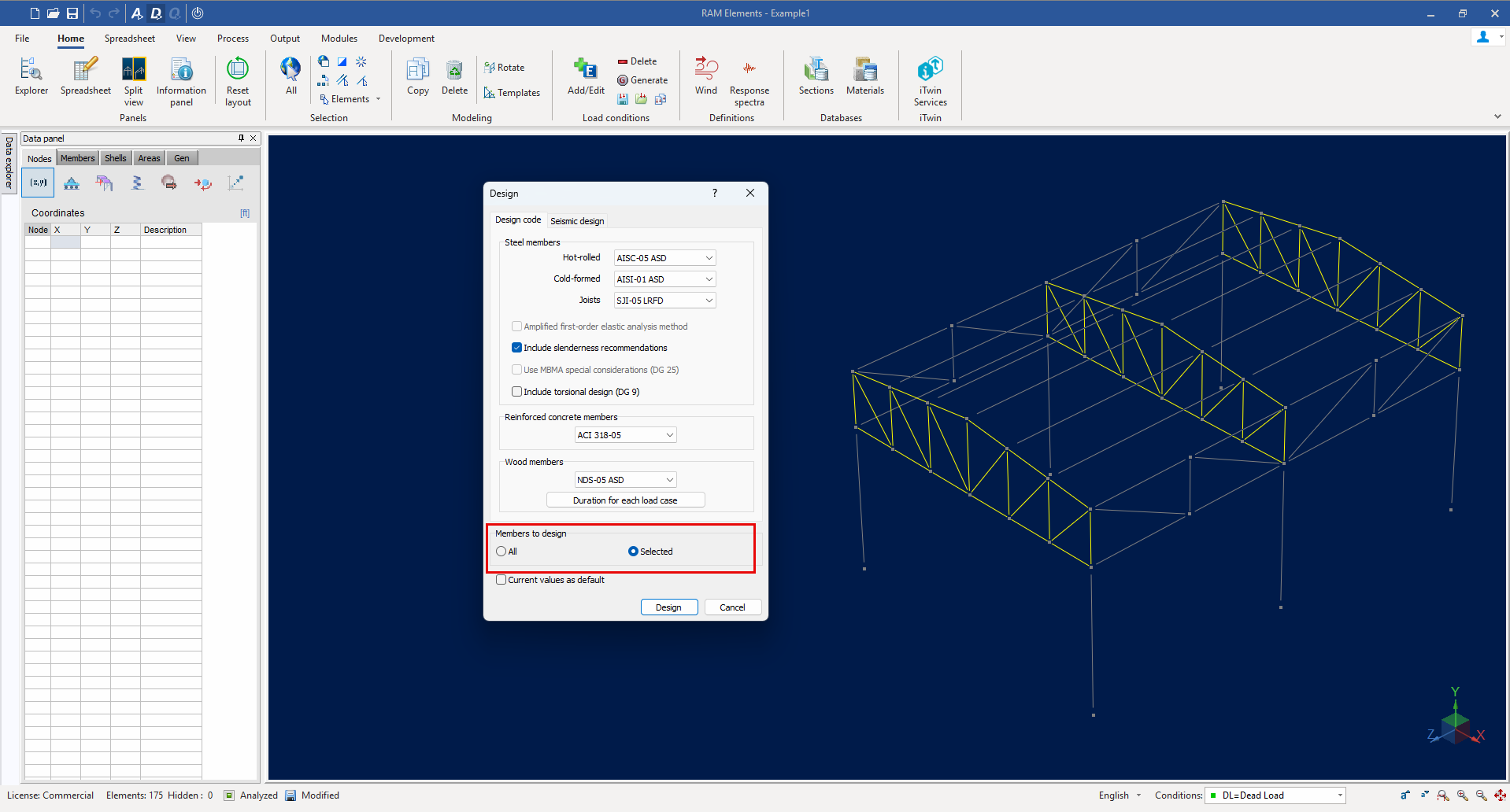

2. Design Only Selected Elements Option. A new option has been added to allow design of only the selected elements within a model. This is especially useful for large structures, where running the design on the entire model can be time-consuming. By focusing the design process on specific elements, users can significantly reduce processing time and improve workflow efficiency during iterative design phases.

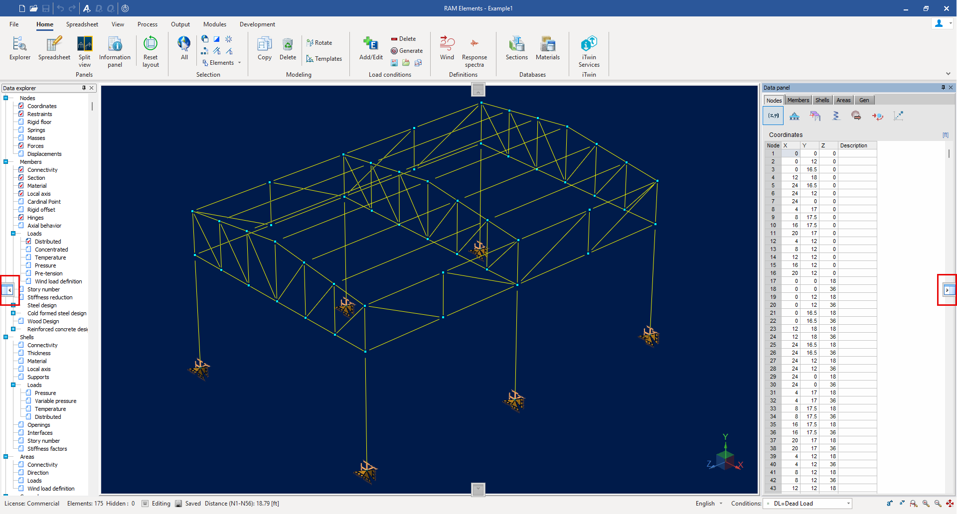

4. Enhanced GUI Layout for High-DPI (4K) Monitor Support. The graphical user interface has been updated to ensure compatibility with high-DPI (4K and higher) monitors. Previous issues with UI components not scaling or displaying correctly have been resolved, greatly improving usability and visual clarity. This update also introduces docking options for RAM Elements panels, allowing users to customize their workspace more effectively. As high-resolution displays become standard, this enhancement ensures a consistent and modern user experience across all supported screen types.
The different panels (e.g., Data Panel and Explorer) can now be docked to the left or right of the display area by dragging the panel title to one of the available docking zones that appear during the action.
