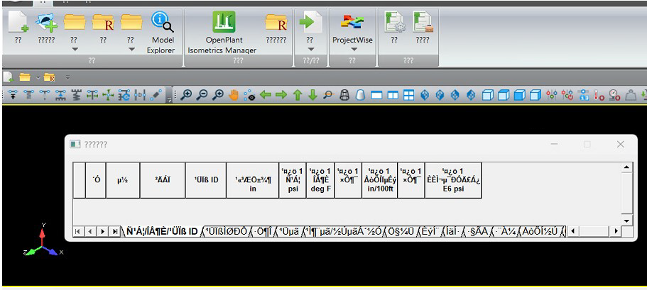

Most words (except for ProjectWise, OPIM, and Model Explorer) on toolbar & grids are illegible
The following was viewed after installing and starting AutoPIPE:
Why and how to Avoid?
This would be a local environmental issue and has nothing to do with the program itself.

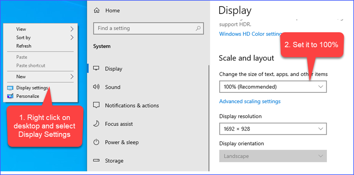

Possible Solution #1: Scale
Confirm Display setting: "Change the size of text, apps, and other items" = 100%

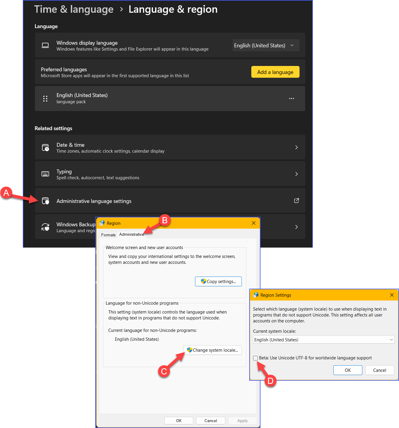

Possible Solution #3: Font Unicode
Uncheck Use Unicode UTF-8 for worldwide language support
    1. Open Language and region, select Administrative Language settings
    2. Select Administrative tab
    3. Select Change System Locale...
    4. Uncheck "Use Unicode UTF-8 for worldwide language support" setting
