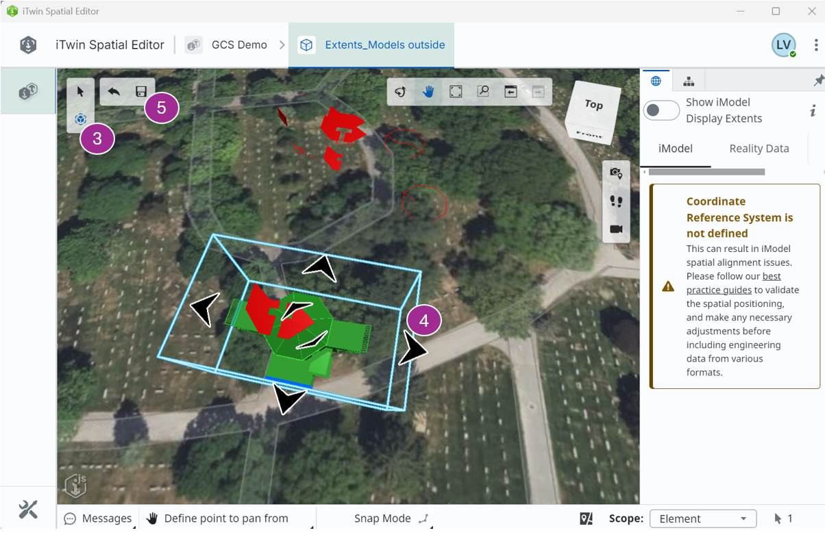

  1. Click the Manage Extents button (2). This will launch the iTwin Spatial Editor application on your desktop. After signing in, open the iModel you wish to adjust.
  1. Click Edit Extents button (3) and use the arrows (4) to adjust the iModel display extents to the desired size. You can quickly identify the geometry based on color:
    • Green – element is within the extents
    • Red – element is outside of the extents
    • Blue – element is at the extents boundary
For More info, Please refer to this Article.
[NOTE: If certain elements are far from the extents boundary, they may not be rendered. Depending on your needs, you might need to update the source files to position these elements correctly or delete them. For more information about potential issues and the best solutions, click here
  1. Click Save (5) to apply your changes. If you cancel the extents editing or close the application without saving, no changes will be made to the iModel.
