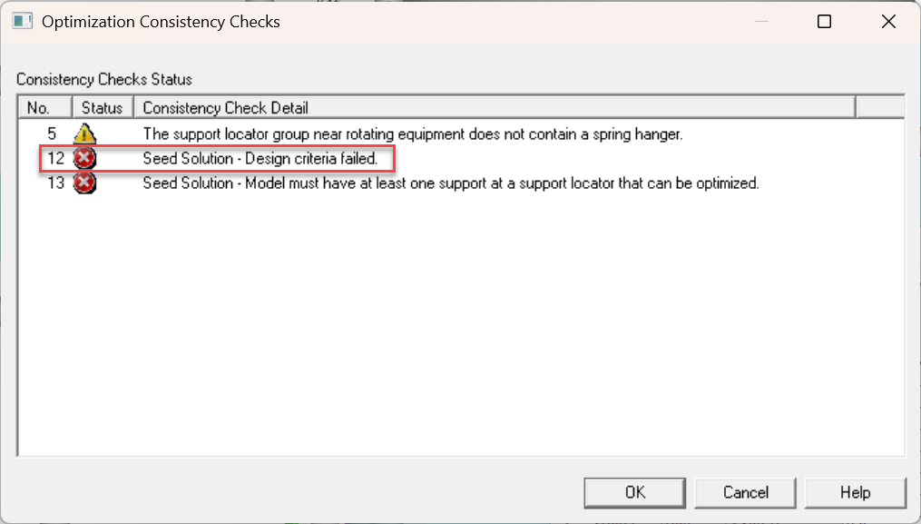

The following Error message appear when  :
Error
12   Seed Solution - Design criteria failed.
OK    Cancel    Help
Why and how to avoid it?
This error may appear when any of the design criteria is correctly defined.

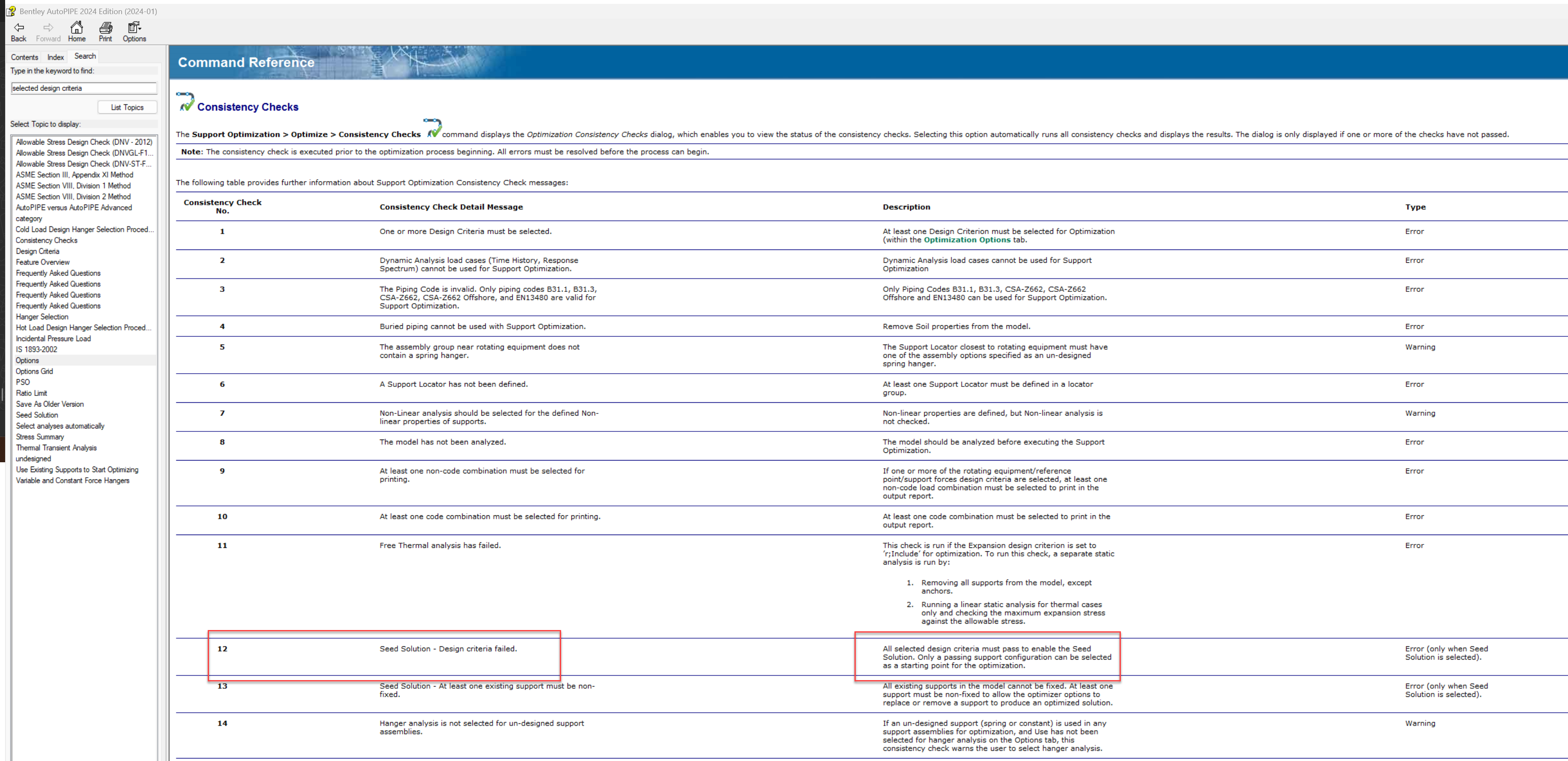

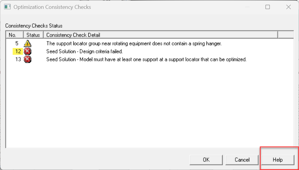

Click on Help button, you will find the below documentations, then refer the Error no.12.As shown below.
Now as per the description of the error code 12, we are not properly defining the design criteria.

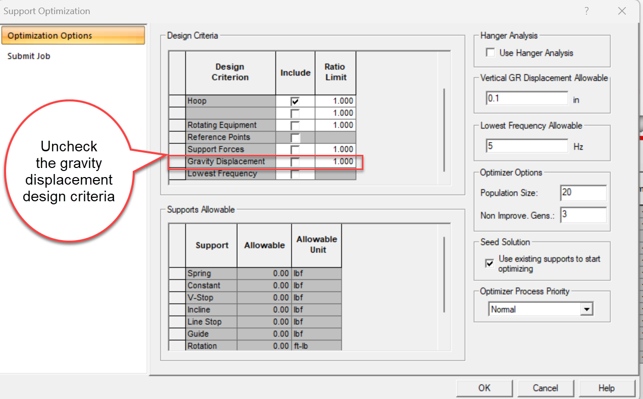

Go to Support optimization > Optimize > Option.
Check all design criteria that do not meet the ratio limit, such as in this case when Gravity Displacement is unchecked. Perform the consistency check again, and the error message should disappear.
