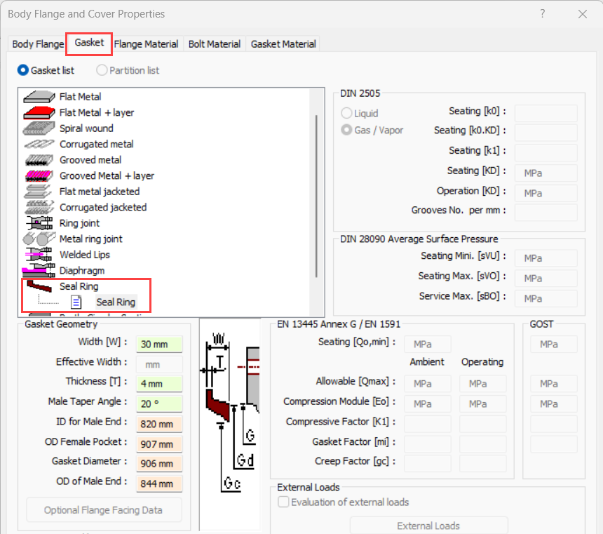

Why we are unable to use Tapered Gasket (Seal Ring)? facing an error while performing analysis.
Question

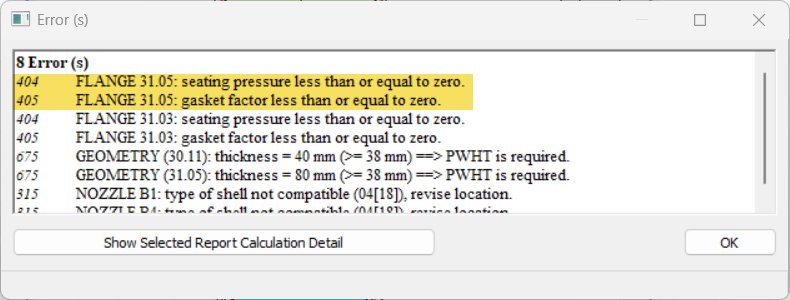

We have error messages that we are unable to process because only geometric data can be modified.

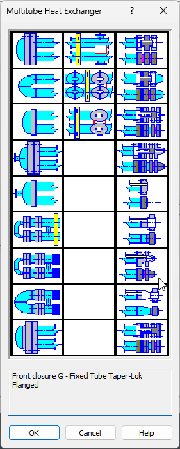

This type of (tapered) gasket can only be used with specific Taper-Lock flanges available only with Multitube Heat Exchanger (under specific license not available to all users).
Use different types of joints.
