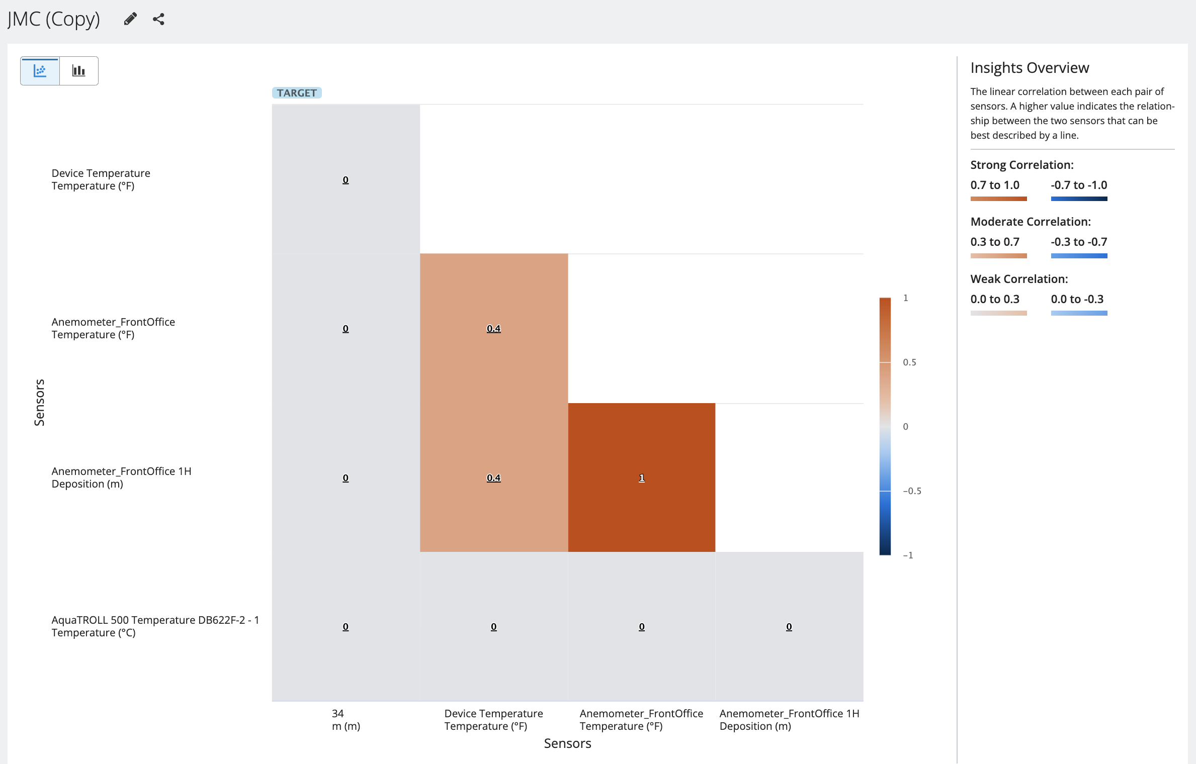

The application will then run an analysis and generate a linear correlation matrix heatmap, showing the strength and direction of relationships between the target sensor and other selected metrics. This visual representation helps users quickly assess correlations between variables.

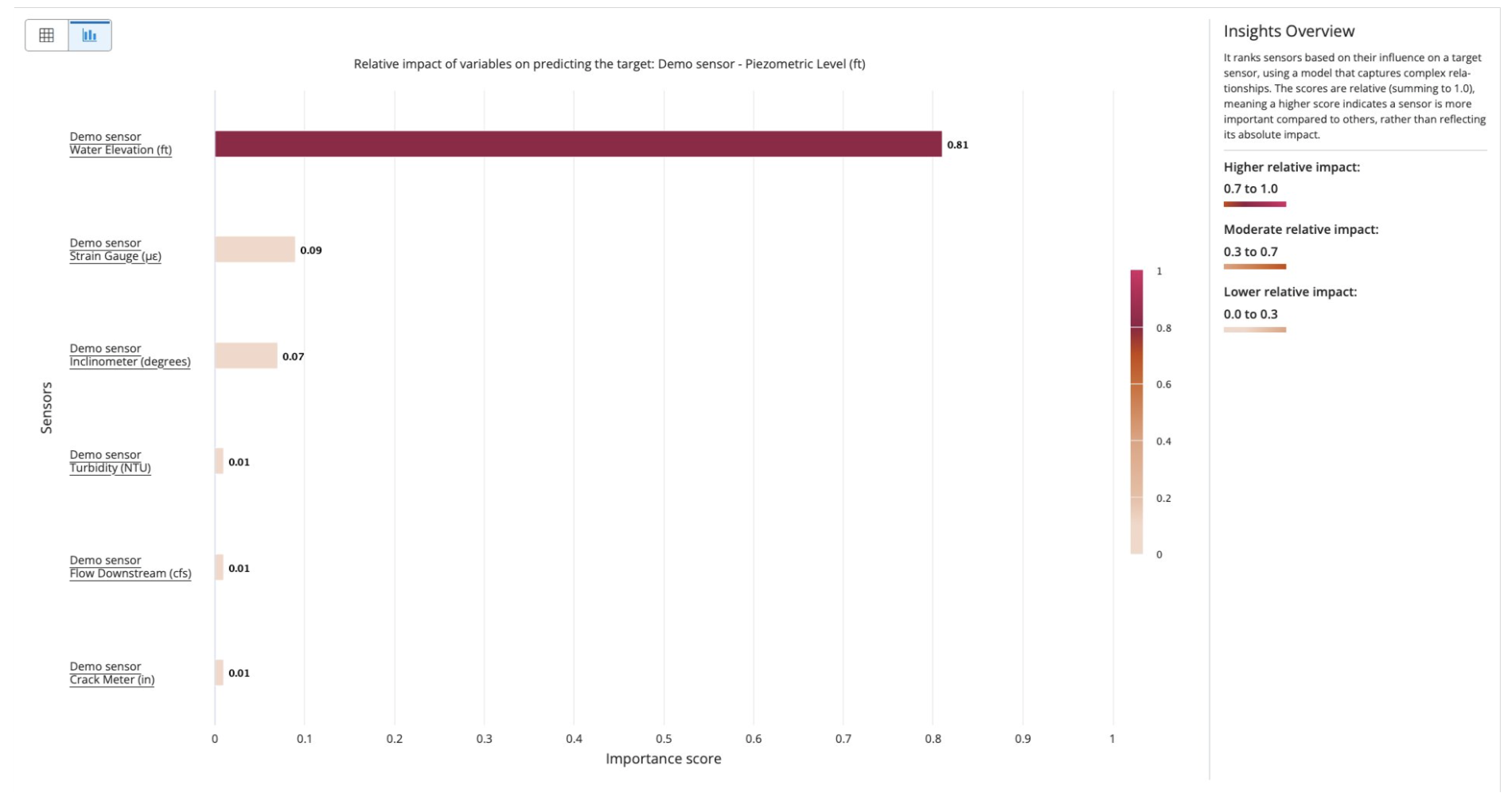

The analysis also generates a Variable Importance bar chart highlighting the overall importance (linear and non-linear) of variables in relation to the target sensor metric, aiding in feature selection and understanding the significance of each metric.

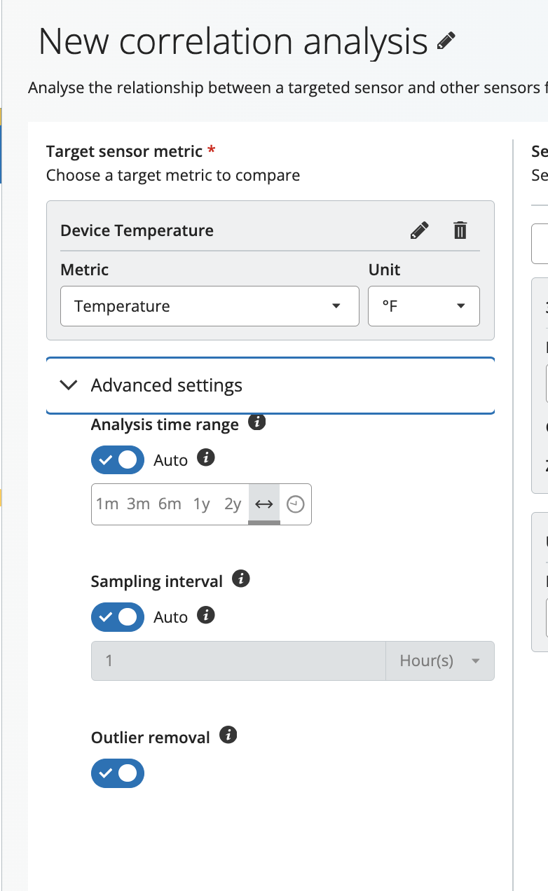

Sampling Interval
The Sampling Interval is a function toggle under Advanced settings in the Analysis configuration.

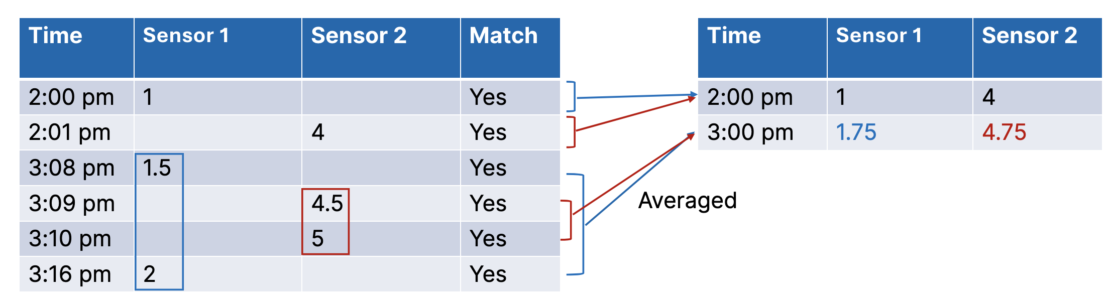

Sampling interval is the amount of time between two consecutive data points in a time series used for the analysis. ​The sampling interval averages each sensor's data over each period,  independently.​
The example below shows a sampling interval set to 1 hour.

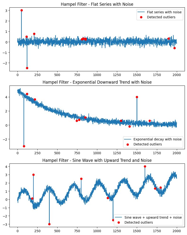

Outlier Removal
The Outlier Removal is a function toggle under Advanced settings in the Analysis configuration.
If enabled, outliers (not anomalies) are removed for the correlation analysis, but all data is plotted in the correlation graphs for reference​. A Hampel Filter is applied to the data to remove outliers.
Hampel Filter: A sliding-window of size 10 that flags points whose deviation from the local median exceeds 6 times the scaled Median Absolute Deviation (MAD):​ MAD=median(∣xi −median(x)∣)
 A screenshot of a graphAI-generated content may be incorrect.
No outlier removal is used in small datasets (n < 100).
Linear Correlation
Computes the linear correlation between different pairs of variables in a set of sensor time series data. A higher correlation value indicates that the relationship between the two metrics can be best described by a straight line. This helps in understanding dependencies, identifying trends, and detecting redundancies in sensor data.
Relative Importance
The Relative Importance calculation is used in the Variable Importance bar charts.
The Analysis a machine learning model that uses all sensor metric data to predict (fit a regression model over) the values of the target sensor metric. Then looks at the contribution of each sensor in creation of that model.
Since the variable importance values are relative to each other, and they always sum up to 1, a large value does not necessarily mean a high correlation exists between that metric and the target metric.

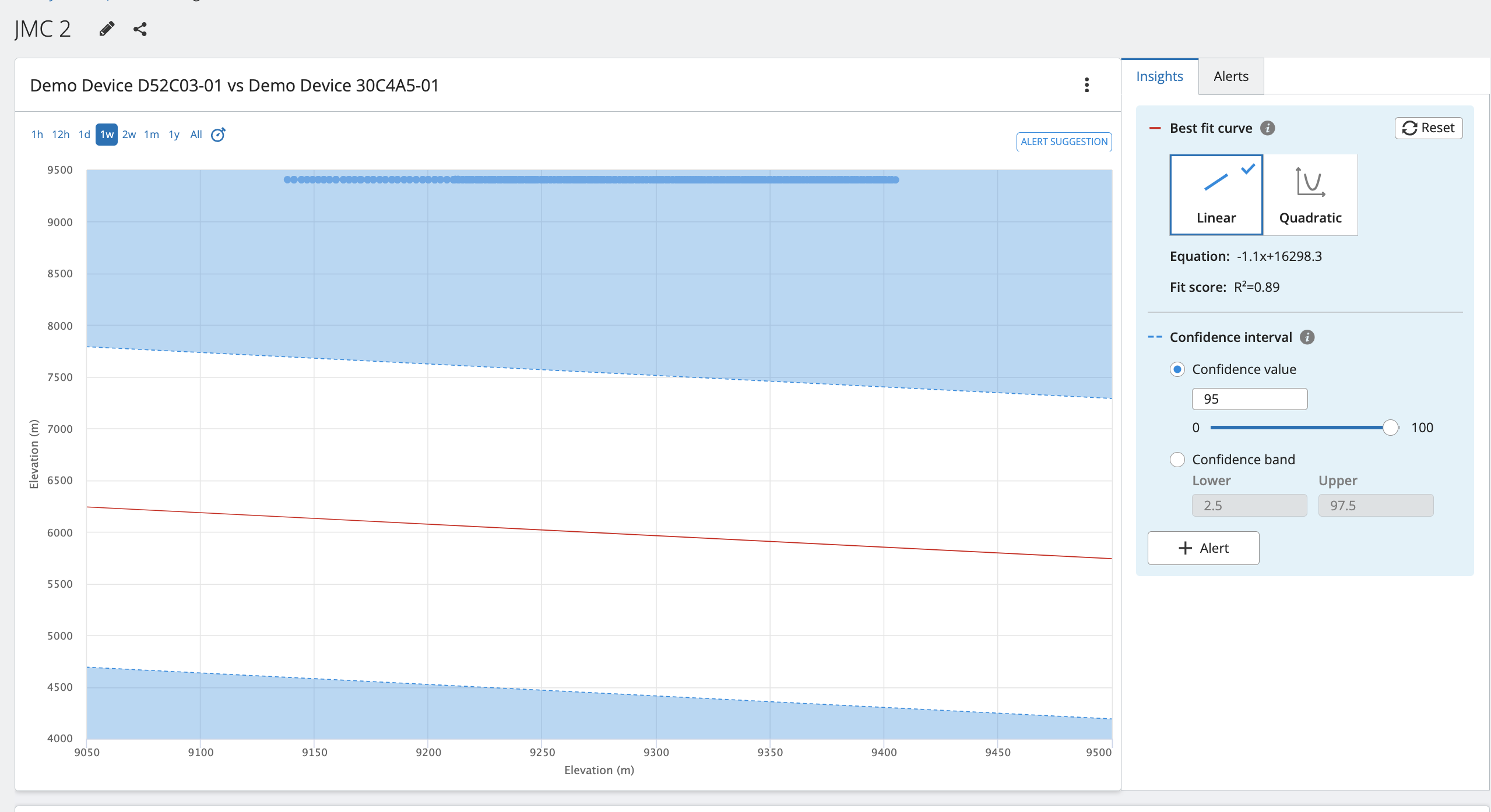

Regression Models and Fit Scores
The polynomial regression tool fits the best linear or quadratic regression model using historical correlation data between two time series. The tool provides the regression equation along with the R² score to indicate the goodness of fit. It uses least squares error to model relationships between two sensor time series. The equations supported at the moment are:

Confidence Interval
The user can pick a symmetrical confidence value, or set the lower and upper lines independently to achieve a non-symmetric setup.
The center line in red is the best fit curve, and the presented confidence band around it refers to the region or range around the regression curve (whether linear or quadratic) that accounts for the uncertainty in the predicted values of the dependent variable (y axis) for given values of the independent variable (x axis).
When you decrease the confidence value from the default 95% to say, 70%, the confidence band gets narrower and would contain less of the historical data.

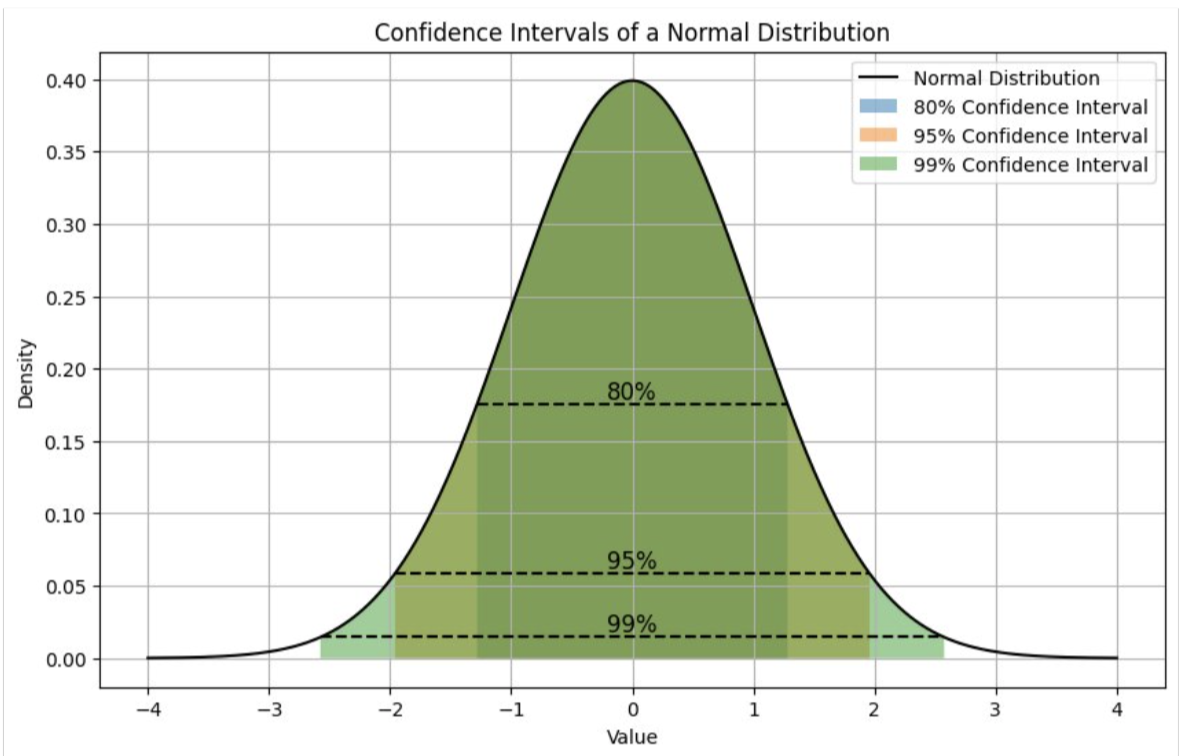

Given a normal, or Gaussian, distribution, the confidence intervals can be illustrated as such:
You can imagine this might roughly be the historical distribution of the y-axis sensor metric data at a given x-axis value (a vertical line in the graph).
The shaded regions highlight the range of values within each confidence interval, while dashed black lines mark their boundaries. The percentage labels indicate the confidence levels at the center of each horizontal line. The lower and upper bounds of each confidence interval are also displayed, showing the corresponding percentage values at each of the boundary points.
For a 95% confidence interval (C), the lower (L) and upper (U) values should be set to 2.5% and 97.5%, respectively, for a symmetric setup:
  • L = (1-C)/2 = (1-0.95)/2 = 0.025 = 2.5%
  • U = (1+C)/2 = (1+0.95)/2 = 0.975 = 97.5%
  • C = U − L = 0.975 - 0.025 = 0.95 = 95%
