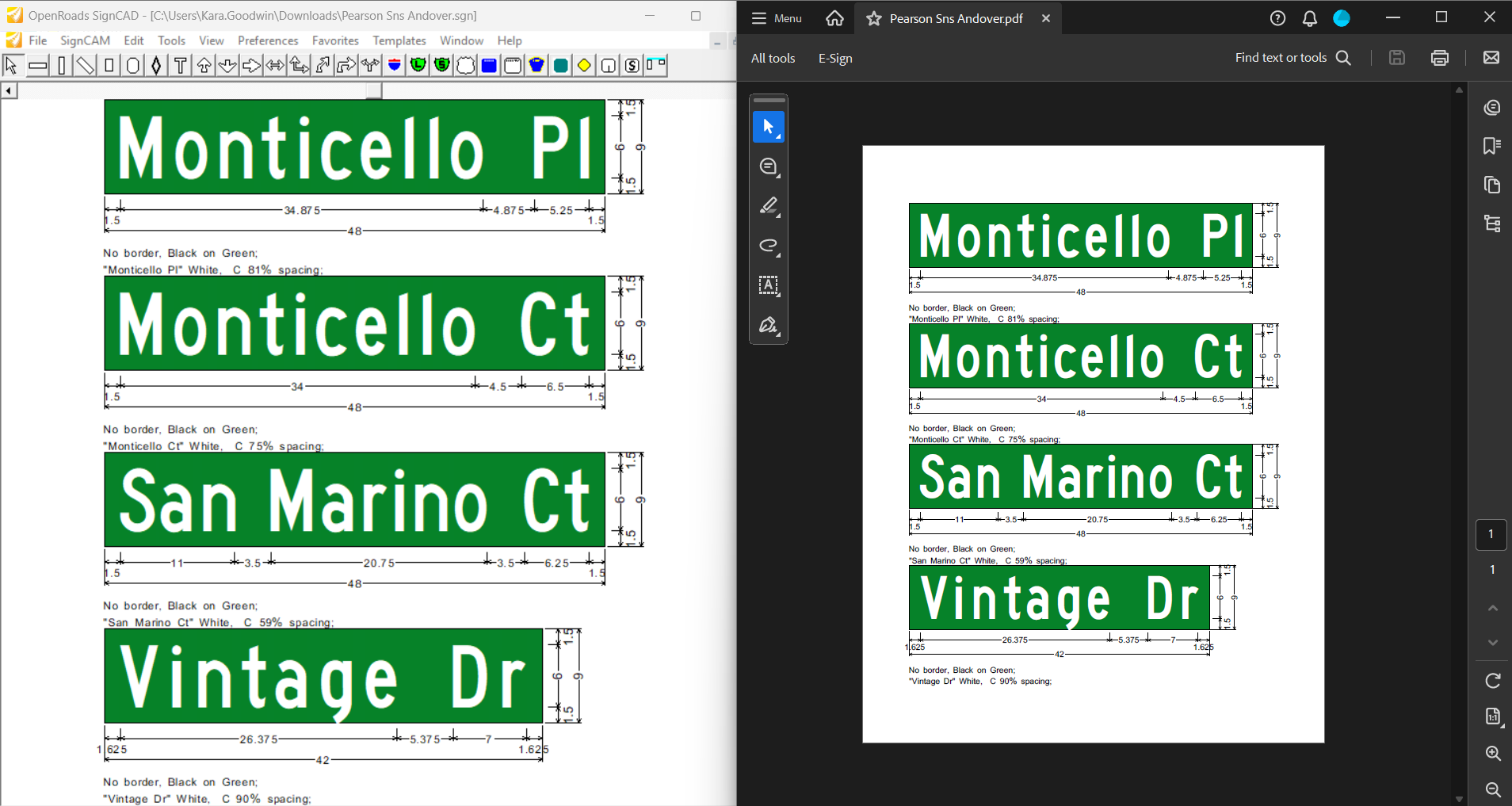

Question:
How do I print a sign file in OpenRoads SignCAD to pdf?
A screenshot of a computer
AI-generated content may be incorrect.
Answer:
1) Open the sign file in OpenRoads SignCAD.
2) Pick File>Print
3) Set the printer to a pdf printer (ex: Microsoft Print to PDF)
4) Print the sign and save the pdf file.
NOTE: A pdf printer must be installed on your computer to print to pdf from OpenRoads SignCAD.
