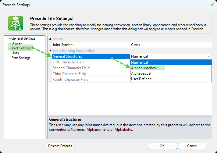

    If the FEMAP model is large, user needs to use Alphanumeric names for the joints, which can be modified in the PRECEDE settings.
