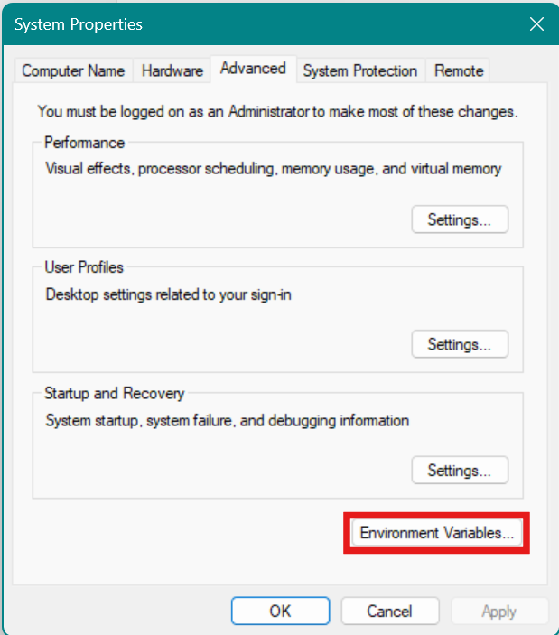

When attempting to use the Reports command to generate a report that requires XSLT Script Execution a message is presented stating “.xsl was trying to execute a script. This might impose a severe security threat. Script execution is disabled by default, to enable script execution, please refer to the documentation.”
For added security, the OpenCivil 2024 products block XSLT Script Execution by default. However, if it is desired to run XSL Reports that contain scripts from trusted sources, then a Windows system environment variable must be defined.
XsltEnableScript=TRUE
To enable this as a Windows system environment variable, navigate to Settings -> System -> Advanced system settings. Here, under the Advanced ribbon, select Environment Variables... and add the variable above.
