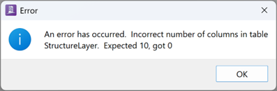

File Corruption and Performance Issues with Network Files
File corruption or long save times may have occurred when saving .cpt files to network directories. Corrupted files generated the error shown below when attempting to open them in another program session following the file save. This issue only affects previous RAM Concept 2024 releases (v24.00.00 and v24.00.01). Network files are now saved in a local temp directory and then copied to the network directory to resolve these issues.

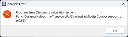

Program Error After Changing Size of Column with User SSR
The Analysis Error “Program Error (Geometry calculation issues in PunchDesignerHelper::maxTransverseRailSpacingSatisfied()” shown below occurred after changing dimensions of columns with associated User SSR and then attempting to run the calculations. This was a fatal error that prevented the calculations from completing.
Now the warning shown below is produced at affected locations with an option to automatically delete the User SSR and redesign with Program SSR.

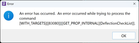

Copying Design Strip Objects Referencing Deflection Checks Between Models
The error referencing “…[GET_PROP_Internal][DeflectionCheckList]” shown below occurred after copying/pasting span segments or deflection check lines with one or more deflection check selections between models and then attempting to view its properties.
The deflection checks and selections are now cleared when span segments or deflection checks are pasted into another model.

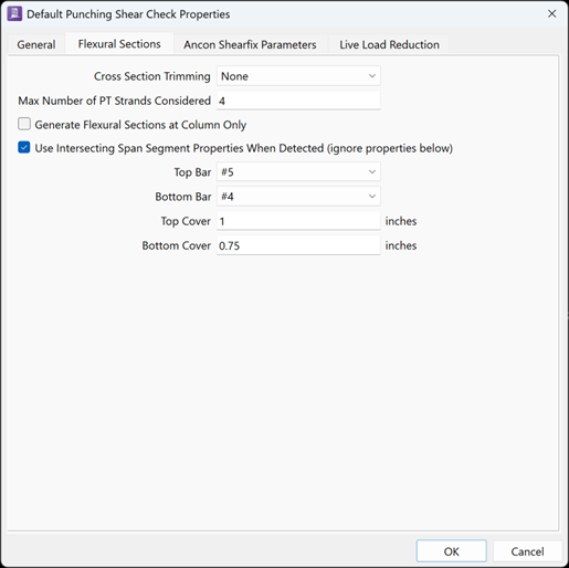

ACI Punching Check Flexural Design Section Outside Drop Panels and Shear Caps
In previous versions, flexural design sections at punching checks were generated only at the column face with effective slab widths equal to the column width plus 1.5x the slab thickness on each side. Now, flexural design sections are generated outside drop caps or other punching shear zones as required by ACI 318-19 8.4.2.2.3. An option to only consider flexural sections at the column has also been added. Refer to Generate Flexural Design Sections at Column Only option shown in the image below. This change affects the ACI 318-14 and 318-19 design codes only.
Option for Trimming ACI Punching Check Flexural Design Sections
An option to trim flexural design sections at punching checks is now available. Refer to Cross Section Trimming selection menu shown in the image below. The trimming options match those available for design strip span segments. This change affects the ACI 318-14 and 318-19 design codes only.
Option for Max Number of PT Strands for ACI Punching Check Flexural Design Sections
An option to limit the number of post-tensioning strands considered in the design of the flexural design sections at punching checks is now available. Refer to Max Number of PT Strands Considered option shown in the image below. This change affects the ACI 318-14 and 318-19 design codes only.
