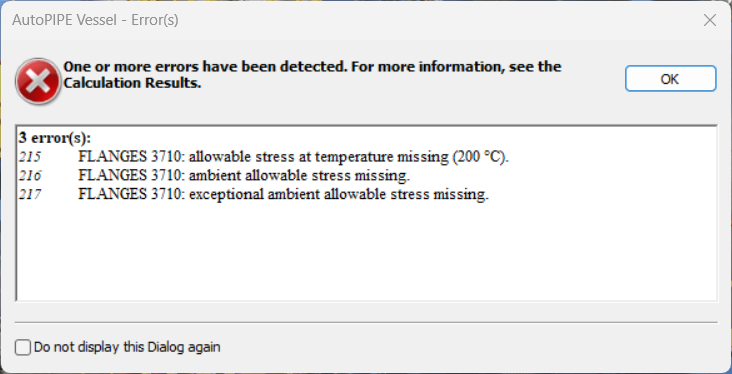

The following message appears in AutoPIPE Vessel while performing the calculation,
215       FLANGES 3710: allowable stress at temperature missing (200 °C).
216       FLANGES 3710: ambient allowable stress missing.
217       FLANGES 3710: exceptional ambient allowable stress missing.

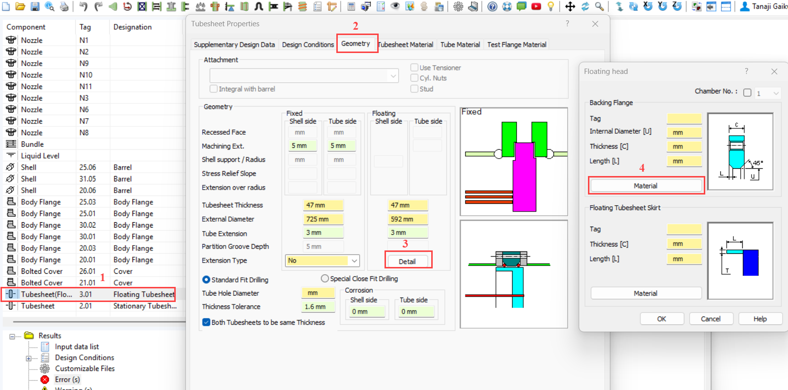

Scenario 1:
One possible reason for this error message is that the backing flange material was not assigned.
To update the flange material, navigate to Floating Tubesheet Properties > Geometry > Detail. Please refer to the snapshot below for further details.
