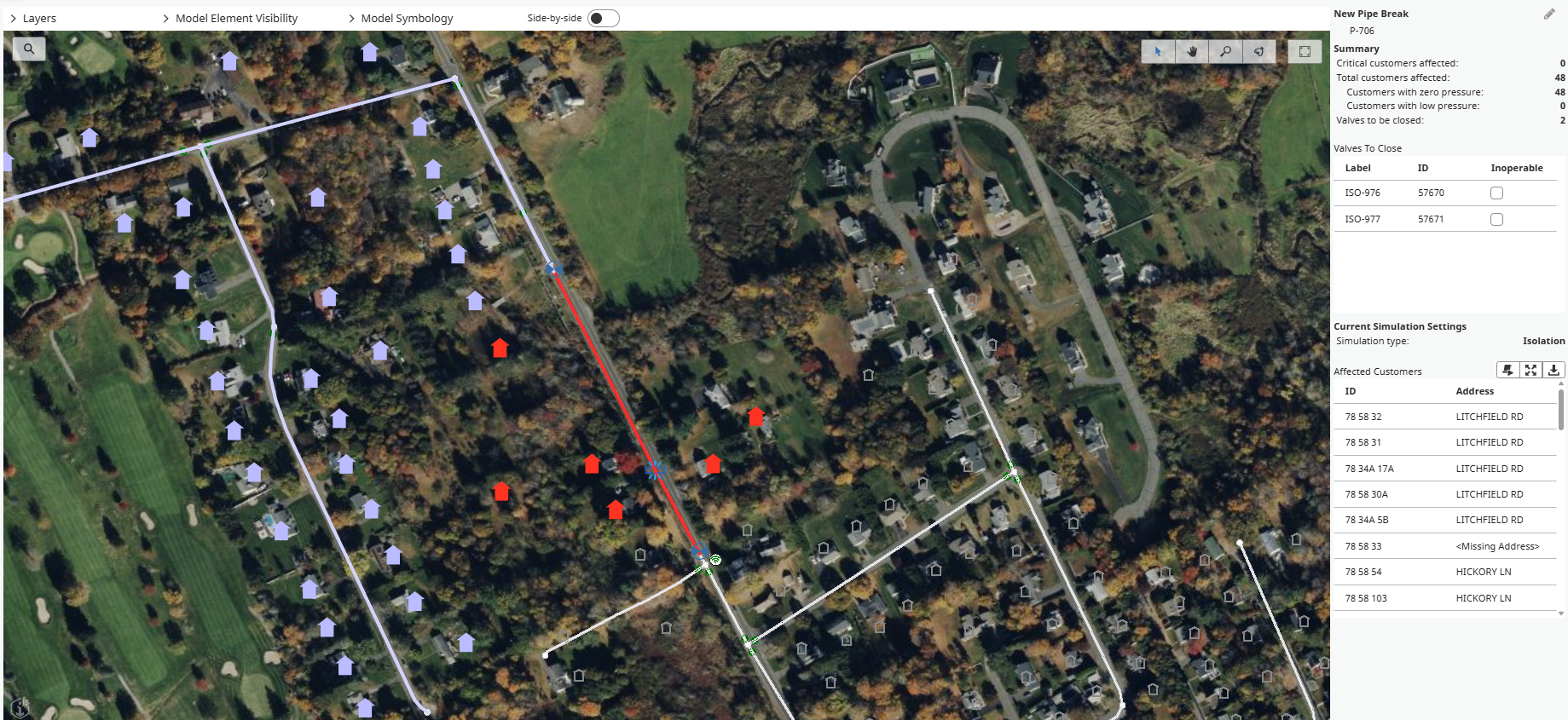

Inconsistent Results during Pipe Break Isolation run - check valve issue
In case you are running a pipe break isolation run (the first step to identify affected customers, and before running a steady state or EPS model run) and you notice that the outage segments seem incorrectly defined, please confirm if you are using a check valve on the pipe next to a reservoir. If that is the case, adjust your WaterGEMS model by placing the check valve on the next-downstream pipe (rather than on the pipe directly adjacent to the reservoir), and then upload the updated model one again in WaterSight. This should solve the issue. We are working toward improvements of the handling of this situation.
Figure 1 - Pipe Break Isolation run results: customers with no water are displayed at red (for those withing the isolated pipe) and purple (for those downstream the isolated pipe)

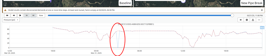

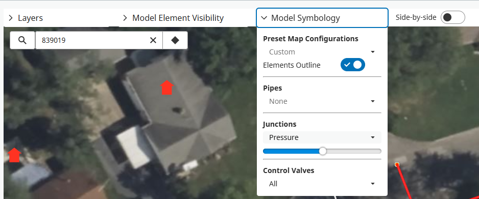

1 - After running the EPS simulation, go to  "Model Symbology" and enable visualization of pressure at the junctions and then enable the "Side-by-side view" toggle.

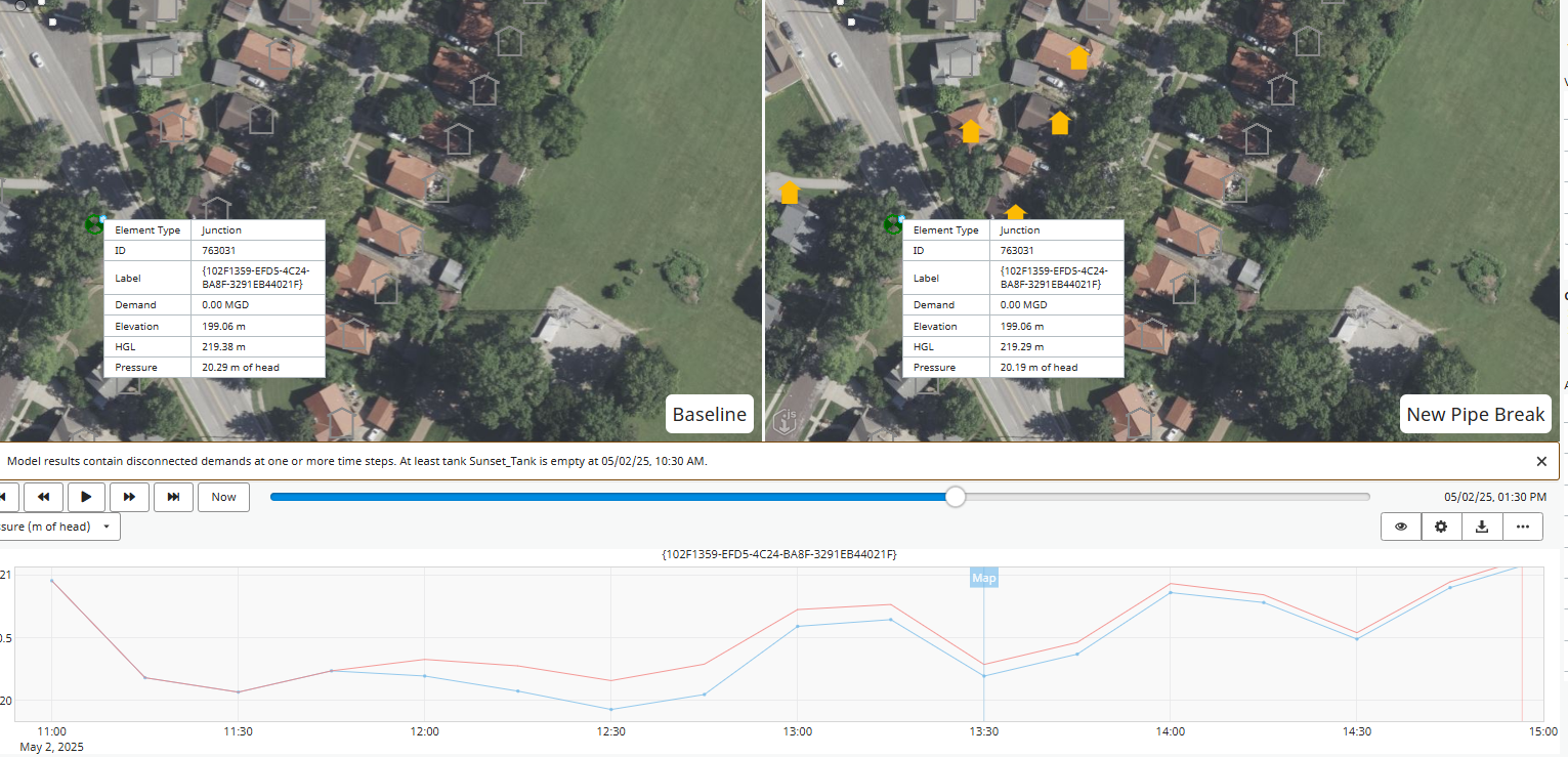

2 - Click in a node in the map very near one of the affected (purple customers) and look at the pressure graph. An example below.
3- The blue line represents the pressure for the baseline scenario (without event) while the red line represents the scenario with the event. In case you get a sudden pressure spike going down for short instants for one of the scenarios (but not for the other), than this instant might be the one that is being used to assess impacted customers and might be related to an unbalanced timestep.
4 - Download the hydraulic model for this operational event directly from WaterSight, by acceding Event Management >> Operational Response, and downloading it from the table.
5 - Open the model in WaterGEMS and run it. Check if you get unbalanced time steps for the same periods you get the pressure decreases in WaterSight. Check also that you obtain the same pressure results for for the same nodes with issues in WaterSight, considering the event scenario (the event scenario is automatically configured an populated under the SCADA Connect Simulator Interface of WaterGEMS).
