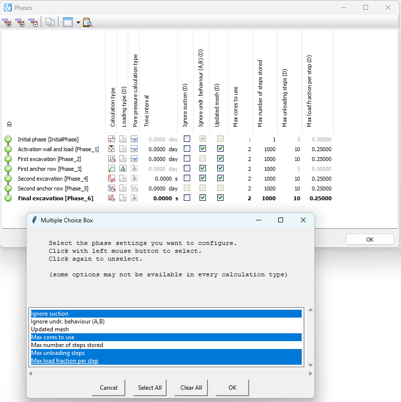

In PLAXIS the large number of phases can make it challenging to configure multiple phase settings. Despite the option to view the phase configuration in a spreadsheet view (F12), the process of updating each setting is error prone and cumbersome.
Using Python, the whole process can become easy and without risking making any accidental mistakes.
Python solution
This Python script allows assigning multiple phase settings in PLAXIS Input according to user-specified properties. The list of available phase settings is customizable and ensures that only when applicable the available phase settings are updated.
This quick and error-proof process prepares your PLAXIS calculation according to your typical settings you may be using daily.

  4. Make sure to adjust the boilerplate on line #39 (uncomment) and #41 (comment).
  5. In PLAXIS Input, open the project containing the geometry and phases
  6. In the Expert menu,
    go to Expert > Python > Editor..., open the phase_settings_configuration_tool.py and run it (F5)
    Or
    In the Expert menu, go to Expert > Run Python script > Open... browse for phase_settings_configuration_tool.py
