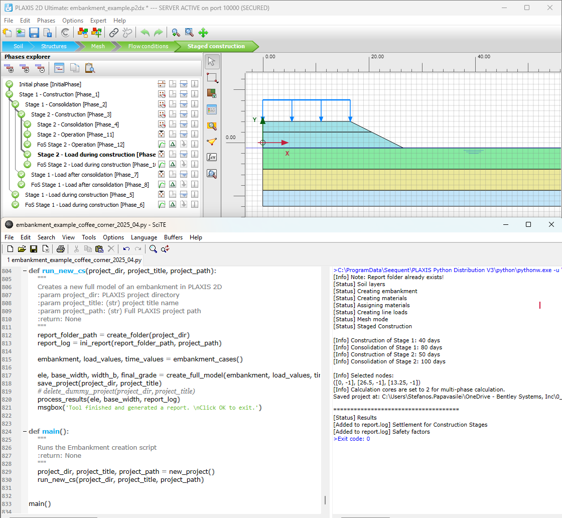

Figure 1. Variables used for embankment model geometry definition
Figure 2. Python solution for the creation of an embankment cross section in PLAXIS 2D

The Python scripts create a half-symmetric 2D model which creates the geometry based on user input. It considers the soil layers as well as the embankment information along with the loading conditions and consolidation time. The solution also covers the meshing and preparation of the necessary Staged construction phases which are set to perform a consolidation and a follow-up safety analysis.
The outcome of the script apart from the calculated PLAXIS 2D model is a report containing the key results for the performed analyses.

  4. Make sure to adjust the boilerplate on line #53 (uncomment) and #55 (comment).
  5. Start PLAXIS Input.
  6. In the Expert menu,
    • go to Expert > Python > Editor..., open the embankment_example_with_results.py and run it (F5)
      Or
    • go to Expert > Run Python script > Open... browse for embankment_example_with_results.py
