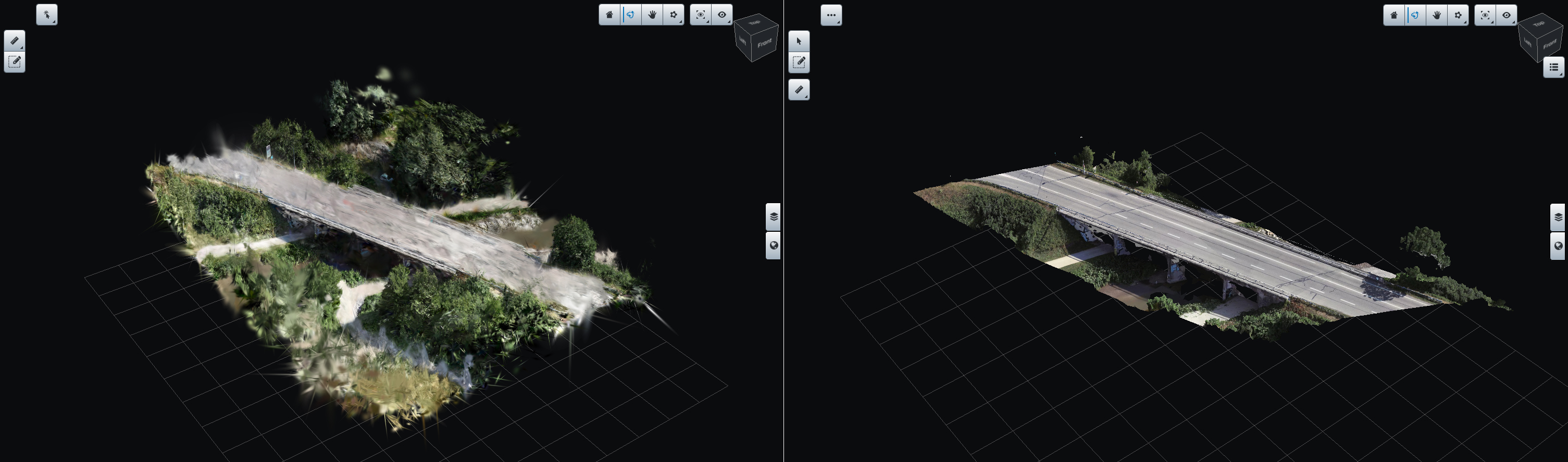

Gaussian Splatting is more sensible to viewing angle and requires the scene to be captured from every angle to allow for seamless visualization. It makes it very effective for scenes like communication towers where most of the viewing angles are covered through orbiting around the structure. However, the mesh result will be much better for Nadir datasets, as soon as the viewing angle is too far from an angle covered by a photos in the dataset.
Gaussian Splatting (Left) VS Reality Mesh (Right): a typical Nadir user case where the Gaussian splatting rendering is not providing good results compared to the Reality Mesh
