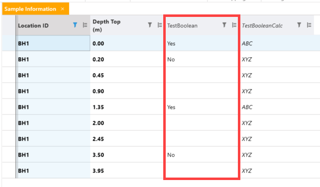

In OpenGround Professional, these headers contain Yes/No values (Yes equals True and No equals False):

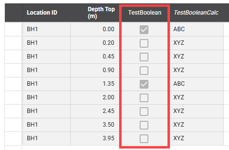

And in Portal, they appear as checkboxes (checked equals True and unchecked equals False):

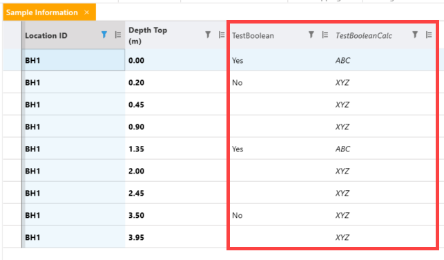

Model Calculation Example
In this example, we have added a calculated TestBooleanCalc header that references a TestBoolean Boolean header in the SampleInformation group.
We want the expression to return ‘ABC’ if TestBoolean is True and ‘XYZ’ if False. We use this expression, which explicitly checks if TestBoolean is True:
if(TestBoolean='True','ABC','XYZ')
We see the results in the image above. You’ll note that this expression treats a ‘blank’ Boolean value as False, which is usually desirable.

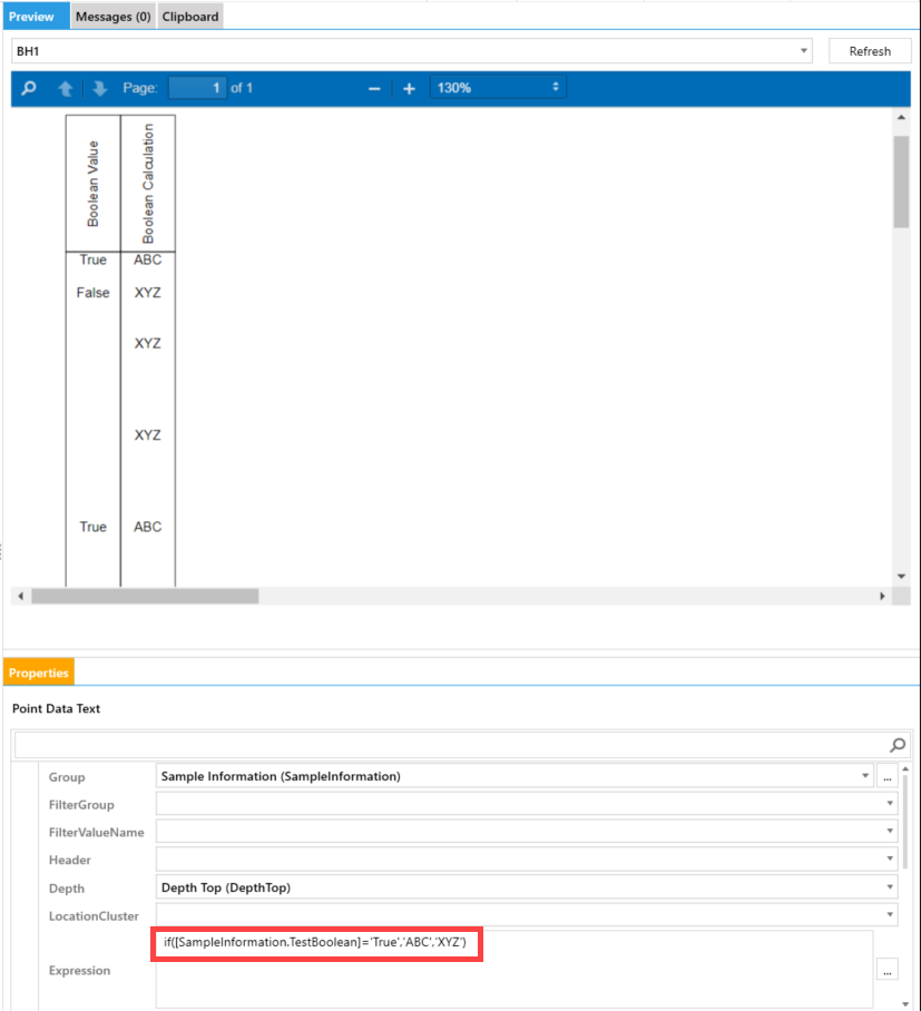

Template Studio Example
In this example, we will use the same scenario as above, except the expression referencing TestBoolean will be executed in Template Studio:
if([SampleInformation.TestBoolean]='True','ABC','XYZ')
