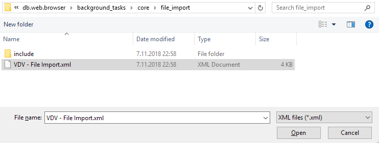

For some features in VDV, it is necessary to install scheduled tasks to run a server-side process.
This article refers to the following components. Notice that the path and name of the XML import file for each component will be unique.
/Vista Data Vision/db.web.browser/background_tasks/core/vdv_monitorTasks
VDV - MonitorTasks.xml
/Vista Data Vision/db.web.browser/background_tasks/core/DataExportTask
VDV - Data Export Task.xml
/Vista Data Vision/db.web.browser/background_tasks/core/file_import
VDV - File Import.xml
/Vista Data Vision/db.web.browser/background_tasks/core/datasource_burst_data
VDV - Burst File Import.xml
/Vista Data Vision/db.web.browser/background_tasks/core/burst_data
VDV - Burst Event Alarms.xml
/Vista Data Vision/db.web.browser/background_tasks/core/loadsensing
VDV - Loadsensing Import.xml
/Vista Data Vision/db.web.browser/background_tasks/core/total_station
VDV - Total Station.xml

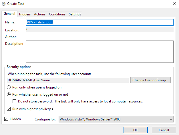

The following help refers to the configuration of the Data Source File Import scheduled task. When installing other tasks, modify the path and XML file name according to the relevant task.
If VDV is not installed under the C: drive, the task Actions must be modified accordingly.
Change User or Group...
button. Search for or enter the name of the appropriate user account, select it, and press OK.\Vista Data Vision\db.web.browser\php7
