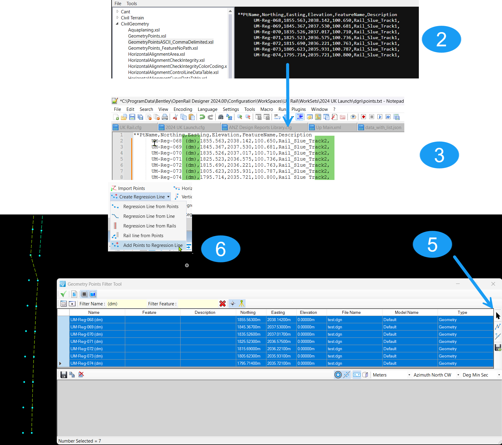

One possible workflow is:
  • Change regression points of both track to set them asĀ Ignored
  • Copy a set of regression points of track 1, or report and import (see below)
  • Add copied points to regression line of track 2
To keep elevation on duplicated points, I suggest to:
  1. select the points
  2. do a horizontal points report
  3. save as text file and edit to better control names and feature definition
  4. Import point (from Ascii)
  5. Select points (Point filter could help)
  6. Add points to regression line
