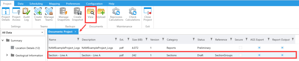

Save Section
This can be used to attach a PDF version of the Quick Section to the cloud Project.
The PDF can be accessed by going to Project>View Documents.

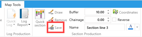

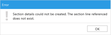

Note that you first need to save the Section Line you are working with before you can save the Section Details. If you don’t, you will get an error telling you that "Section details could not be created. The section line referenced does not exist.":
The Section Line can be saved under Map Tools>Save:

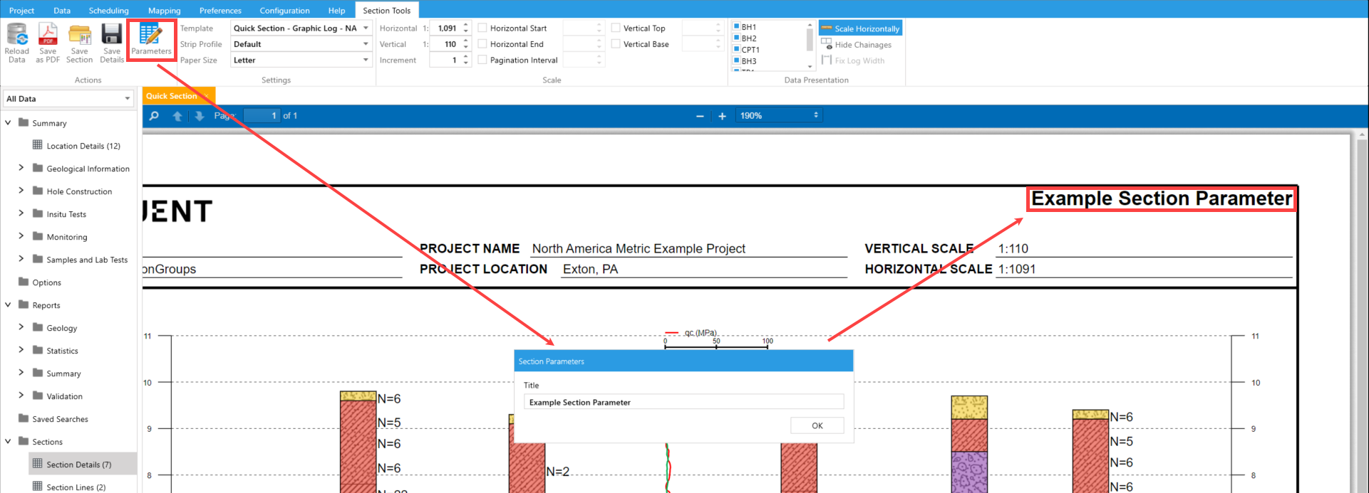

Parameters
Parameters is where values are entered if your Quick Section template uses Dynamic Text objects.
Parameters need to be re-entered every time the Quick Section is generated. This is a somewhat obsolete feature.
Often it will be preferable to create custom Headers in the Section Details Group that are used instead. The advantage with using Section Details is that the values are persisted and do not need to be re-entered every time the Section is generated.

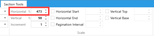

This is the Horizontal Scale used for the Quick Section expressed as a ratio. For example, a 1:100 scale would mean that 1 m on the Section would represent 100 m in real life (or similarly, 1 ft on the Section would represent 100 ft in real life).
When the Quick Section is generated, it will utilize a best-fit scale depending on the length of the Section and paper space available.
It is possible to enter a larger value for the Horizontal Scale than the best-fit scale, but not a lower value (unless you adjust the Horizontal Start/End values – see below). If you enter a lower value, it will default back to the best-fit scale because the full Section can not fit into the available space.
Here the Section is generated with the best-fit Horizontal Scale (1:473):

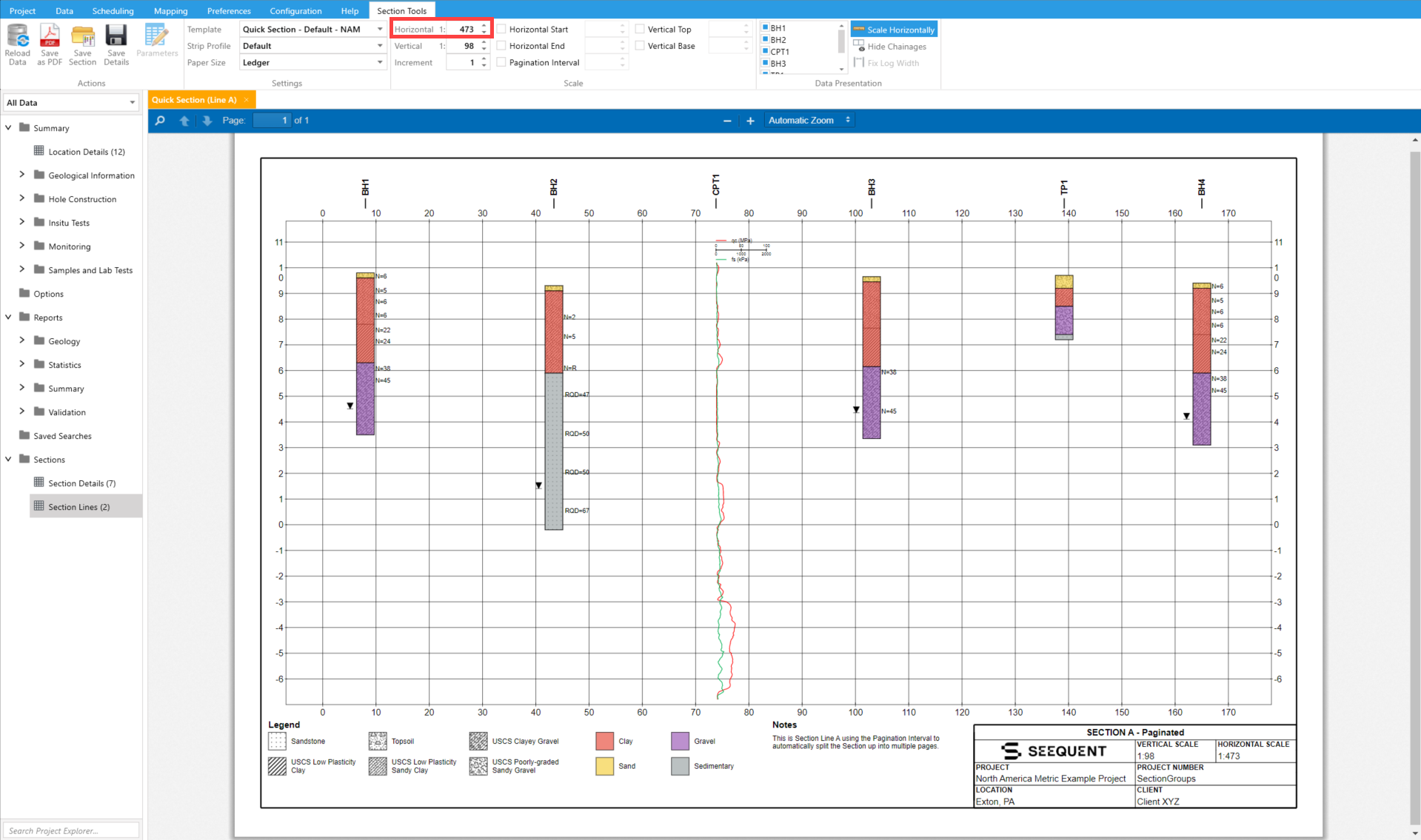

Resetting to the Best-Fit Horizontal Scale

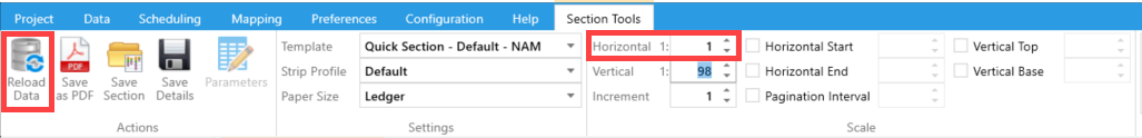

In the course of adjusting your Section settings, you may want to regenerate the Section using the best-fit scale. A trick is to set the Horizontal Scale value to 1:1, which will cause the Section to generate using the best-fit scale when reloaded.
For example:
Which would cause the Horizontal Scale to generate using the best-fit Scale:

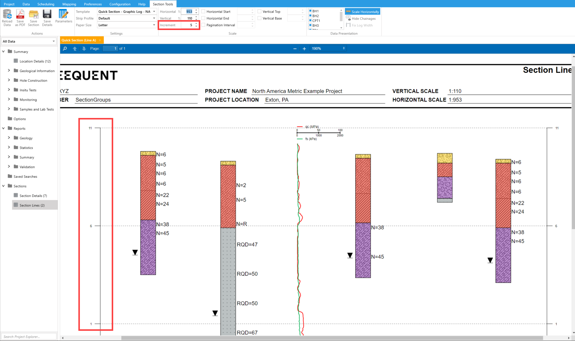

Increment
This value controls the interval for the vertical scale ticks and labels:

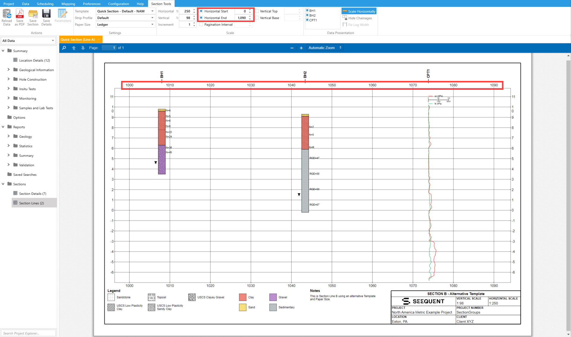

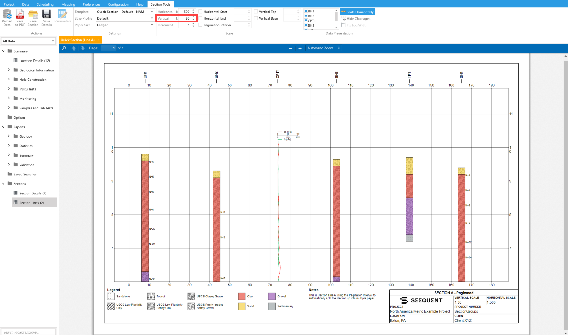

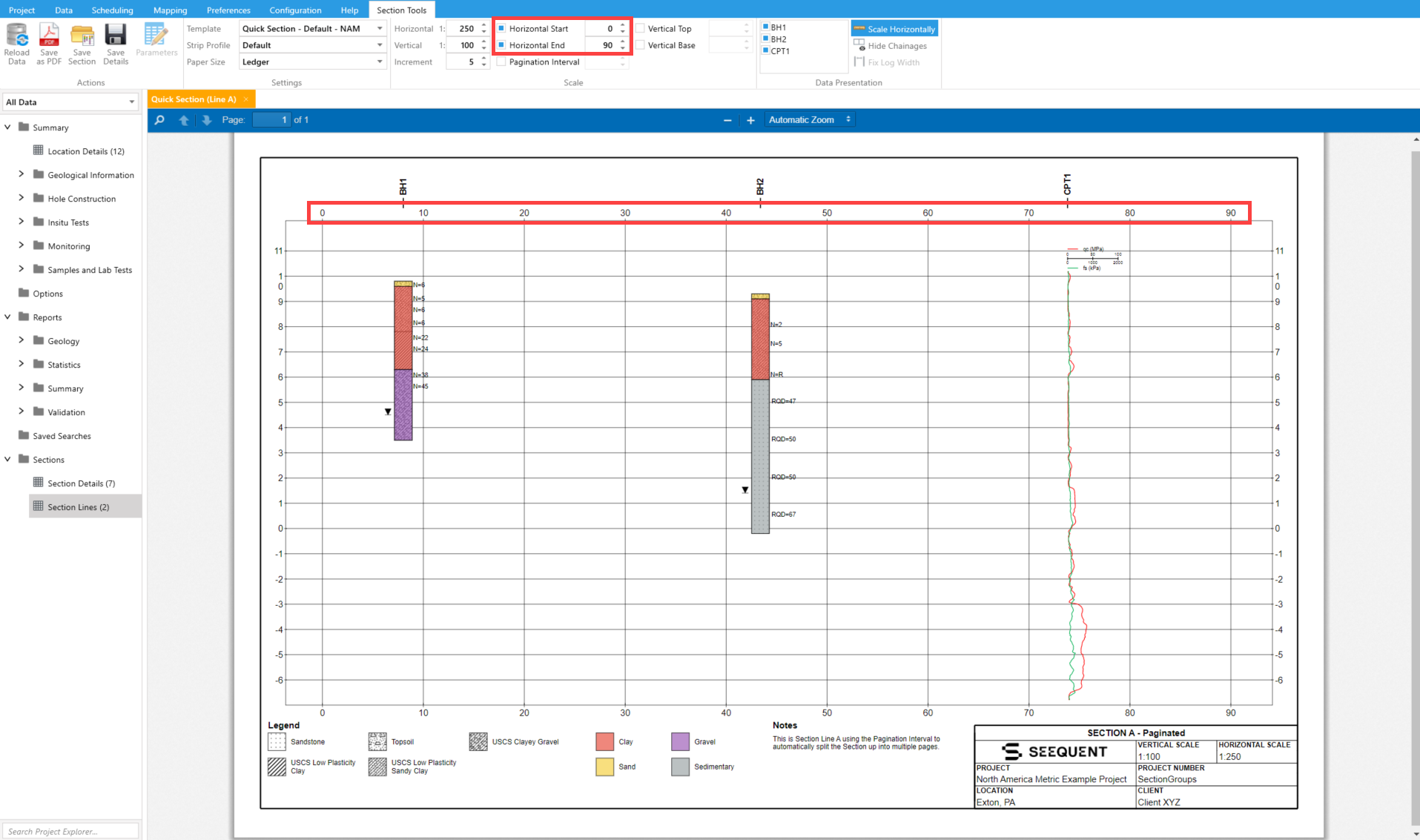

The Horizontal Start and End settings can be used to trim a Section horizontally instead of showing the full length of the Section Line.
For example, here the Horizontal Start and End are set to 0 m and 90 m, which shows the Section trimmed to the first part of the Section Line:

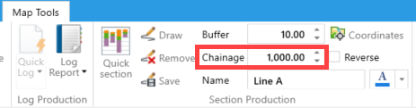

Note that the Horizontal Start/End settings respect the initial Chainage value (see above) for the Section Line. For example, if initial Chainage is set to 1000 m, Start/End would need to be set to 1000/1090 m show a similar portion of the Section Line as the example above:

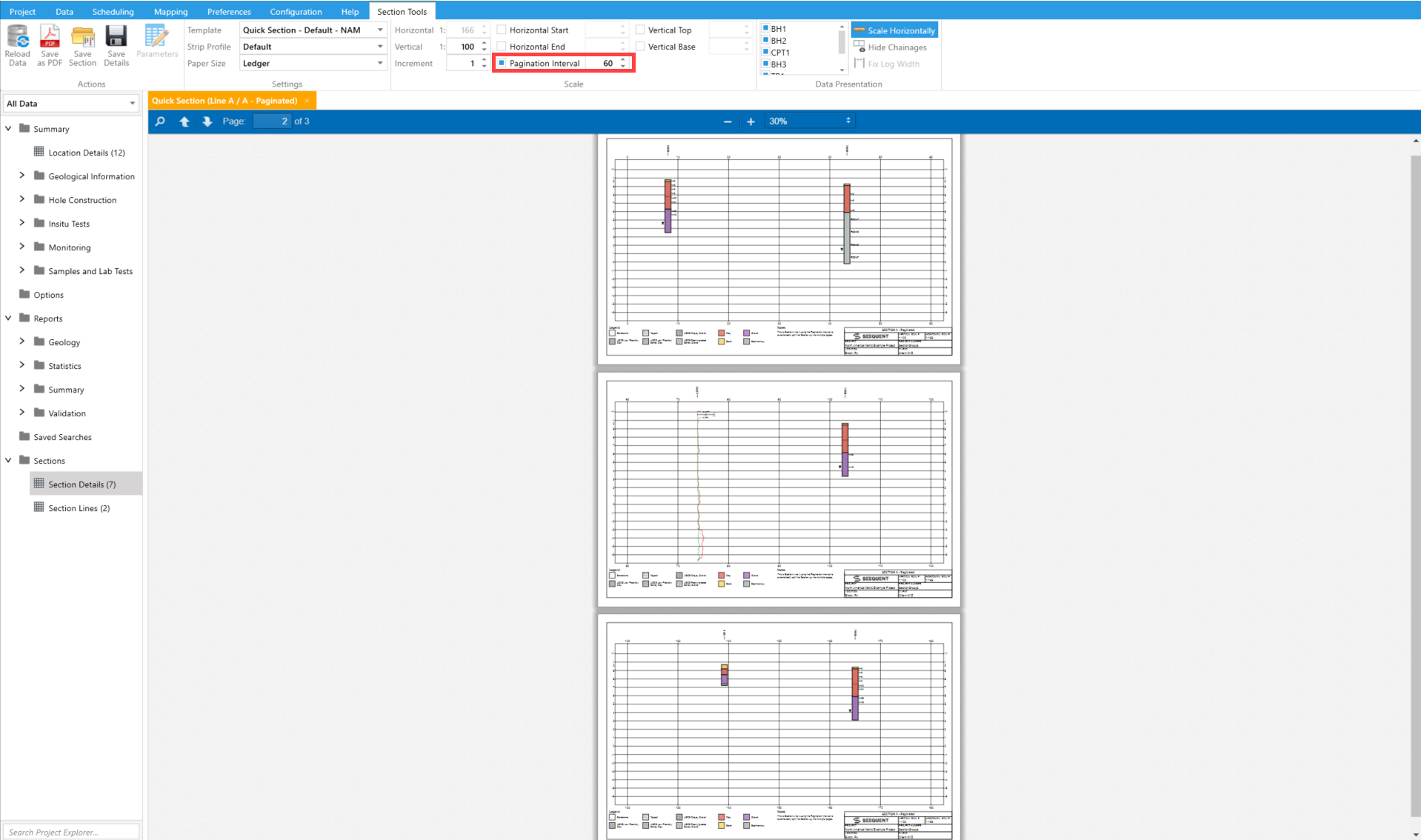

Pagination Interval
The Pagination Interval can be used to break up a long Section Line into multiple pages.
For example, here a Pagination Interval of 60 is entered, and the Section is broken up into 3 pages each showing 60 m along the Section Line:
When a Pagination Interval is set, a best-fit Horizontal Scale will always be used, and the scale cannot be adjusted.

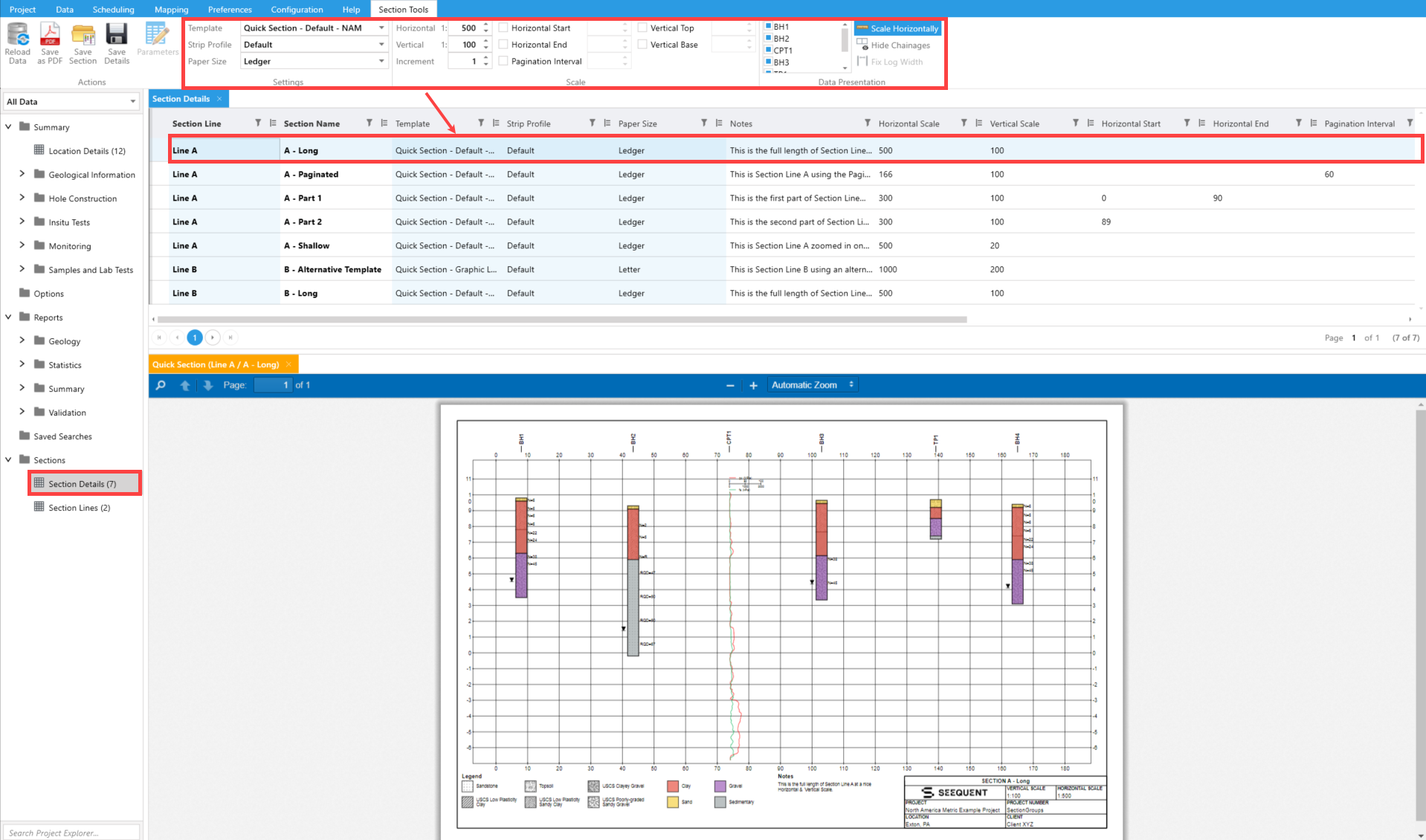

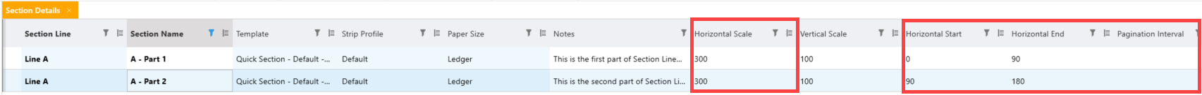

If you’d like to break a Section Line into multiple pages horizontally and also use a specific Horizontal Scale, this can be done using the Horizontal Start/End settings instead of a Pagination Interval. Multiple records can be created in Section Details Group with the Horizontal Start/End and Horizontal Scale specified.
For example:

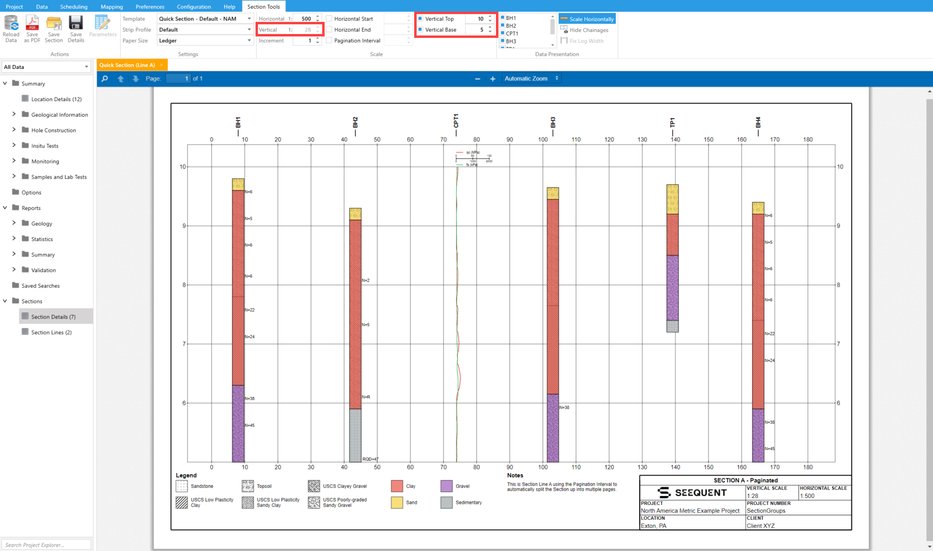

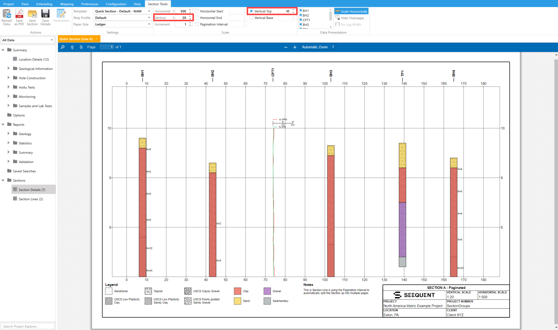

Vertical Top/Base
The Vertical Top and Base settings can be used to trim a Section vertically to show a specific range in the profile.
If you enter both a Vertical Top and Base, the Quick Section will be drawn with a best-fit scale that cannot be adjusted:
If you enter just a Vertical Top or just a Vertical Base, the entered Vertical Scale will be respected:

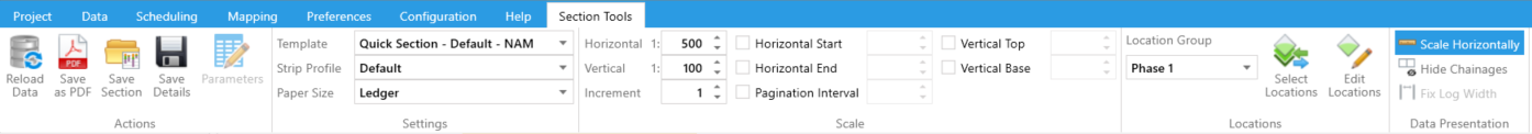

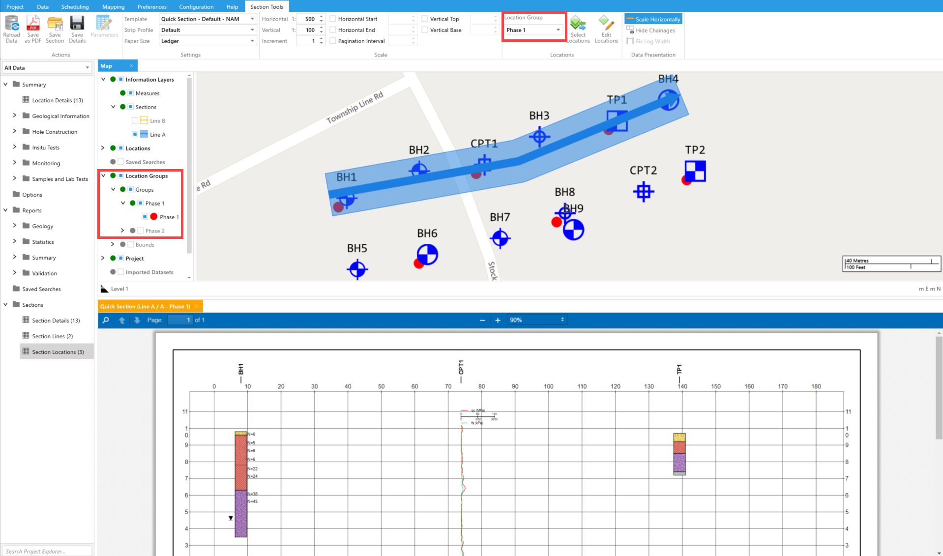

Location Group
A Location Group can be selected. Only Locations within the selected Location Group (and within the Buffer) will be shown on the Quick Section.
For example, below a "Phase 1" Location Group (indicated by red dots on the map) has been selected and only those Locations are shown on the Quick Section.

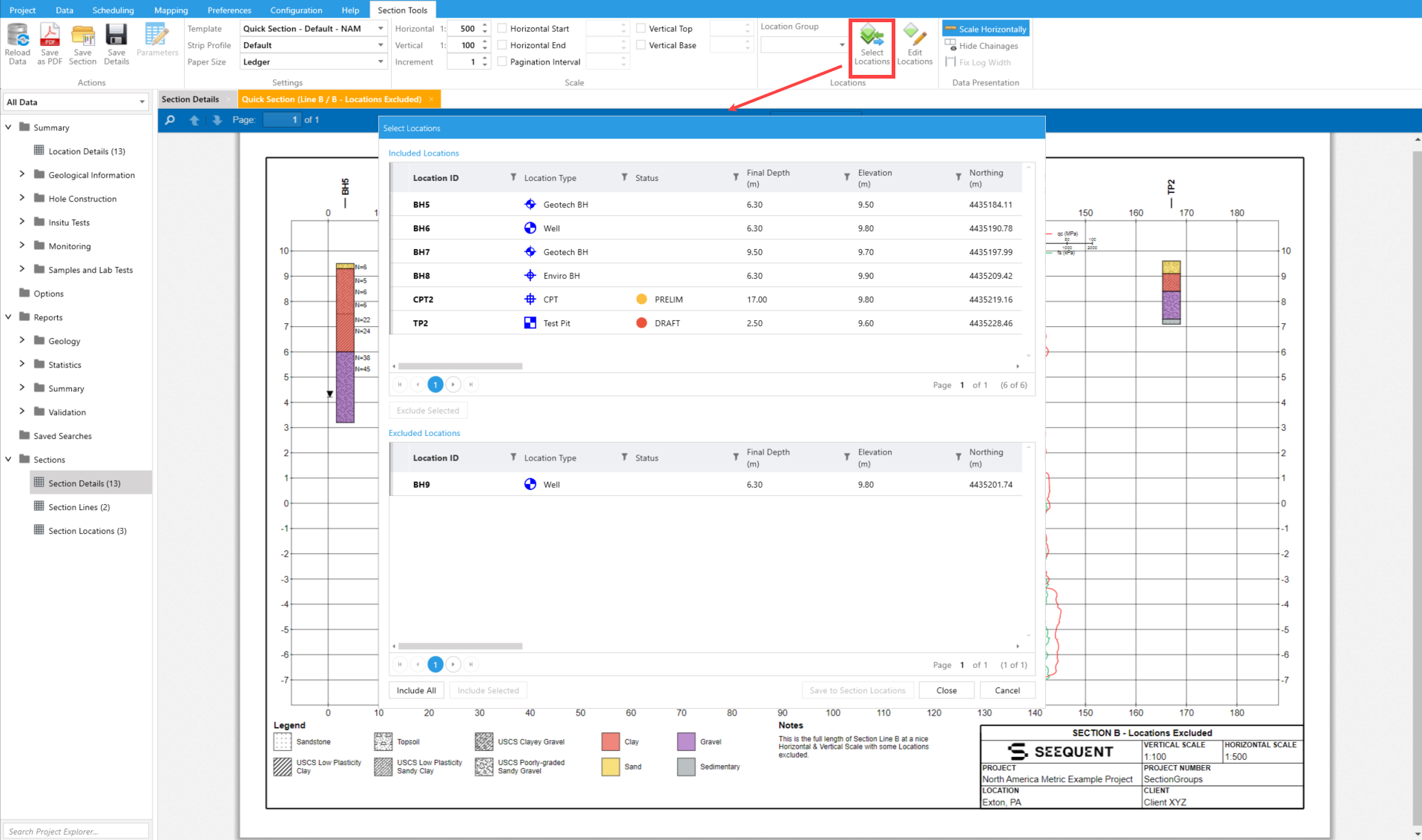

Select Locations
The Select Locations button will open an interface for selecting any Locations that you want to Exclude (hide) from the Quick Section.
The initial list of "Included Locations" will be the Locations within both the Section Line Buffer and Location Group (if selected).
Locations can be selected and toggled back and forth between the "Included Locations" grid and "Excluded Locations" grid using the Exclude Selected, Include All, and Include Selected buttons.
Note that the grids contain all Headers from the Location Details grid and are filterable to potentially make Location Selection easier if you have a lot of Locations to manage.
When you are finished with your Location selection, there are three options:

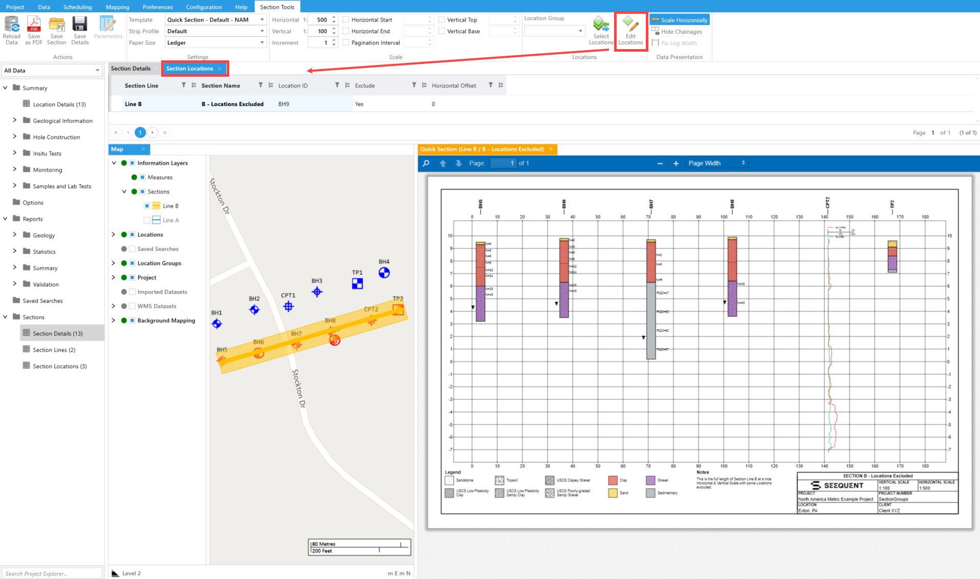

Edit Locations
The Edit Locations button will open the Section Locations Group.
This can only be used if the current Section has been Saved to the Section Details Group (see Save Details above).
The Grid will be filtered to the records for the current Section (rather than showing all records for every Section). For example, below there is only the single Excluded Location BH9:

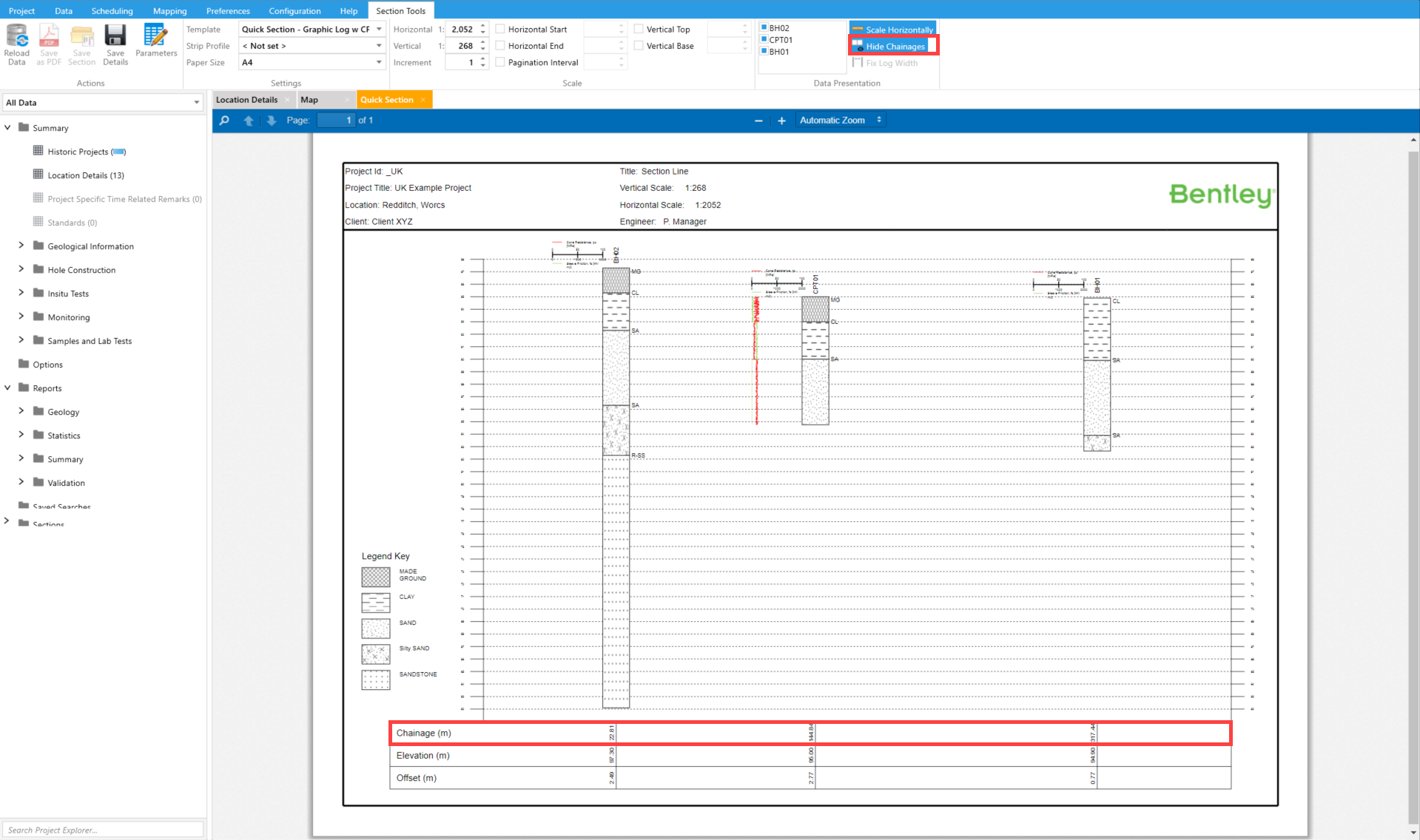

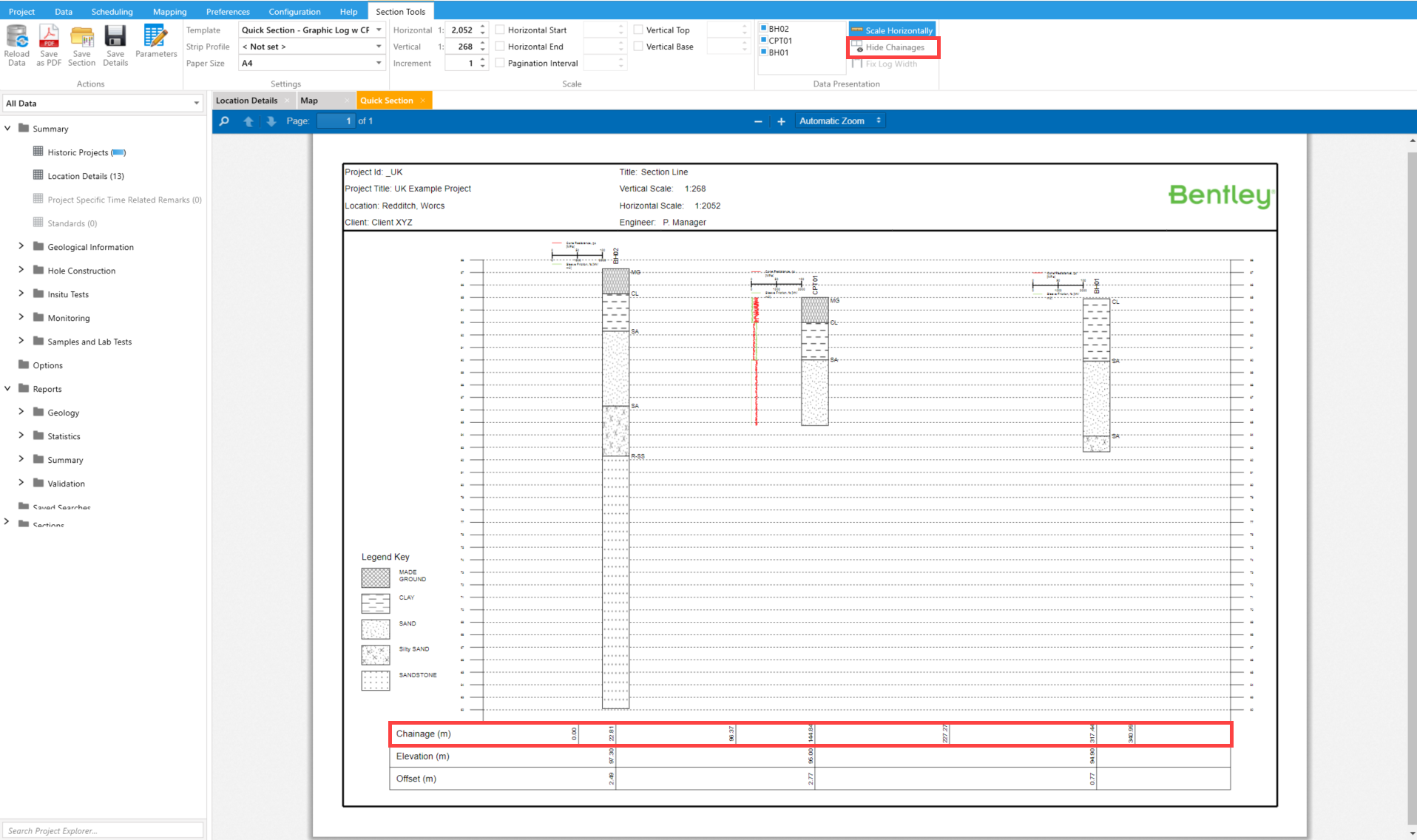

Hide Chainages
This setting applies if the Quick Section template uses a Chainage Horizontal Scale.
By default, Chainages will be shown on the Horizontal Scale for each Location, as well as for any points along the Section Line:
Using the Hide Chainages option will hide the Chainages for the points along the Section Line, but still show them for each Location:
