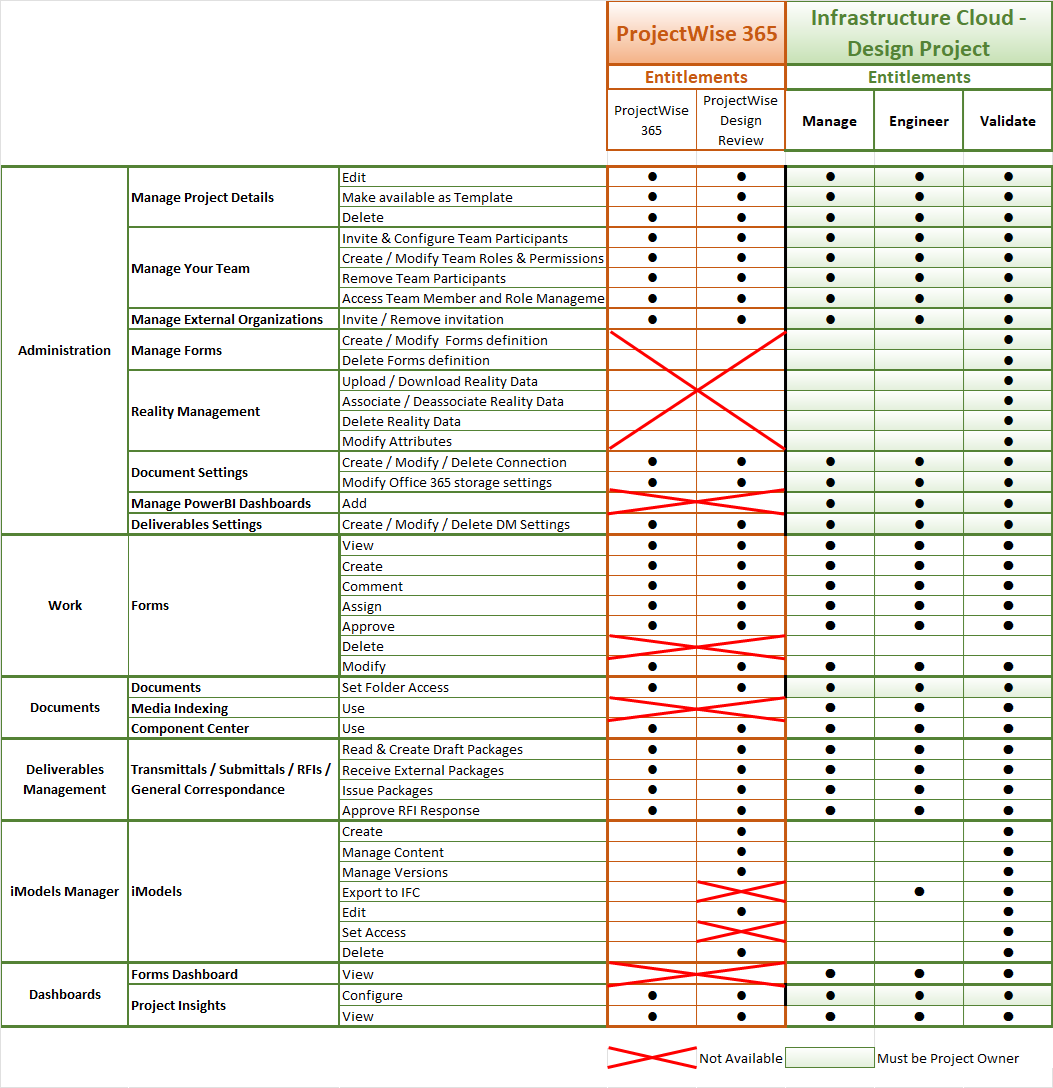

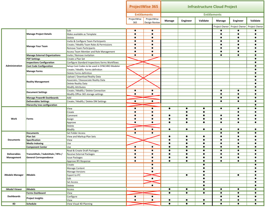

Entitlements / Permissions
In ProjectWise 365, ProjectWise 365 entitlement does not define the set of permissions users may have when they access a project, therefore everyone has access to all the features, with the exception of Design Review, Design Validation and Dashboard which require a ProjectWise Design Review Visa. Permissions/Restrictions must be set by Roles.
In Infrastructure Cloud Projects, Bentley Infrastructure Cloud Connect and Bentley Infrastructure Cloud ProjectWise entitlements will define the maximum set of permissions users will have when they access the project. Permissions can be restricted further using Roles, but you cannot grant permissions higher than the entitlement allows.

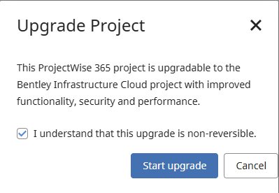

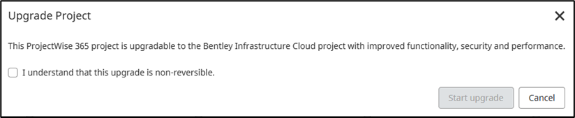

[Note: Once you upgrade a ProjectWise 365 project to an Infrastructure Cloud Project, you will no longer be able to open the project with PW365.]

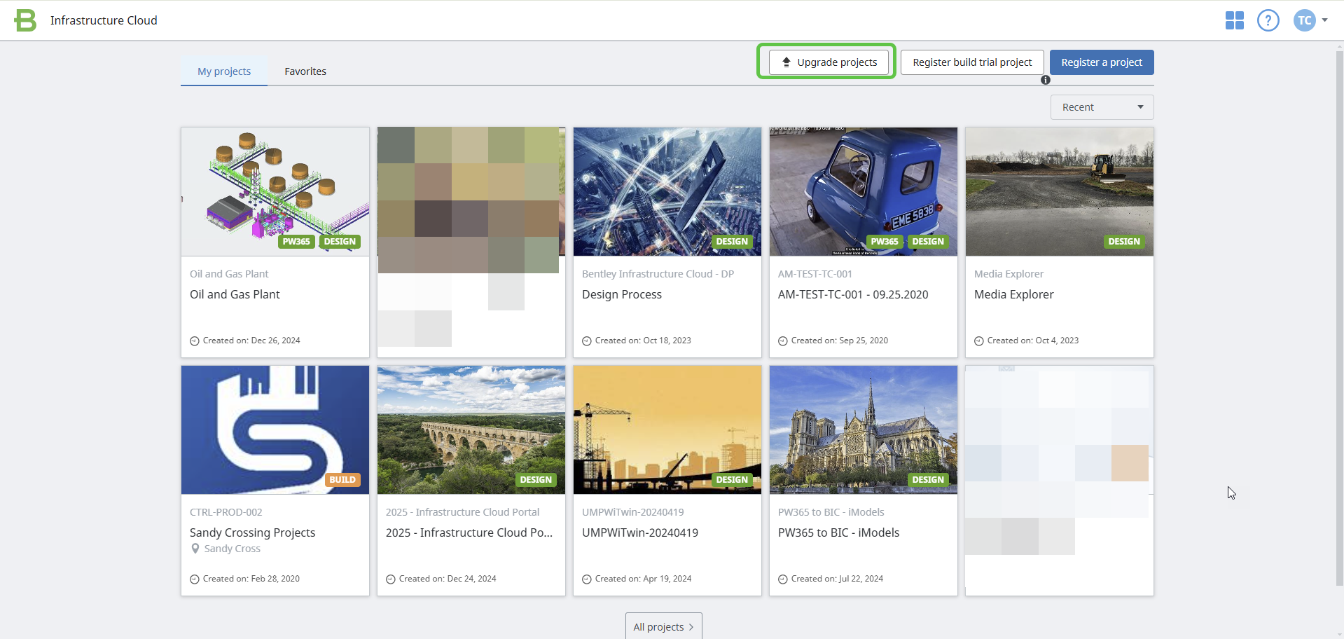

Single project Upgrade
To upgrade a PW365 project to an Infrastructure Cloud project

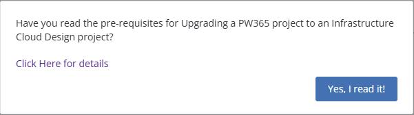

[Note: The first time you click on a PW365 project, you will get a pop-up to remind you to read about pre-requisites.
'Click Here for details' – will take you to the article.
'Yes, I read it' – will dismiss the pop-up and let you continue.
undefined
'Click on the browser’s back arrow' – to go back to the Landing Page.
This is a one-time pop-up]

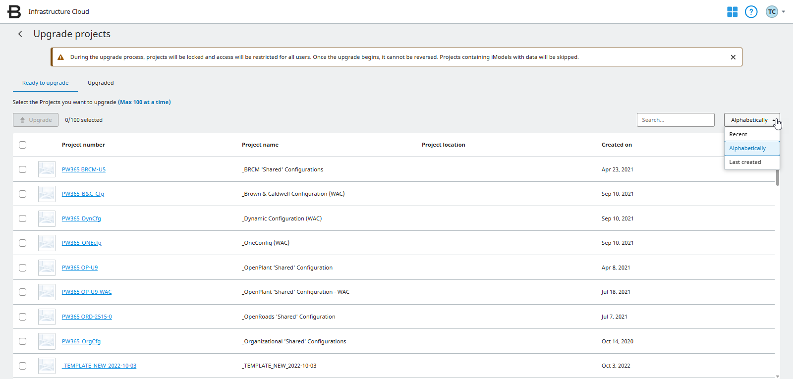

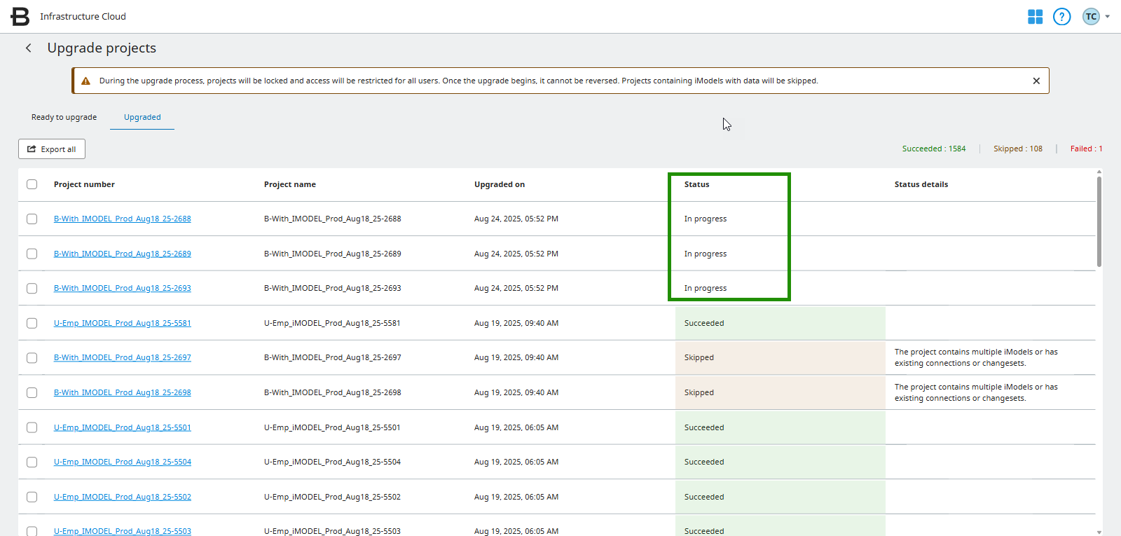

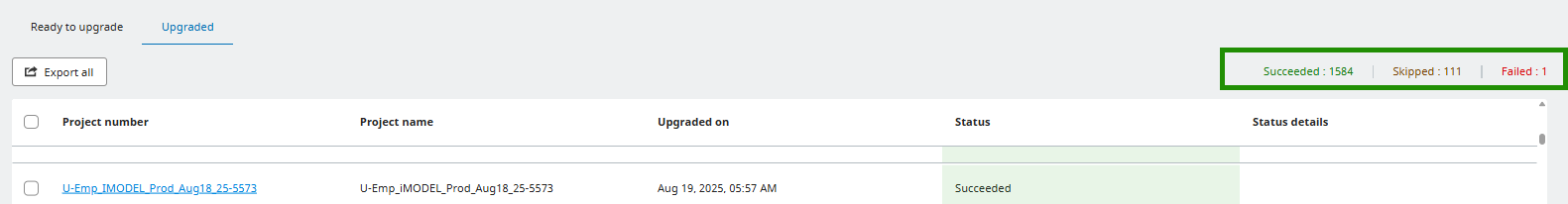

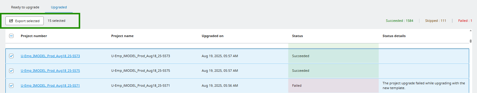

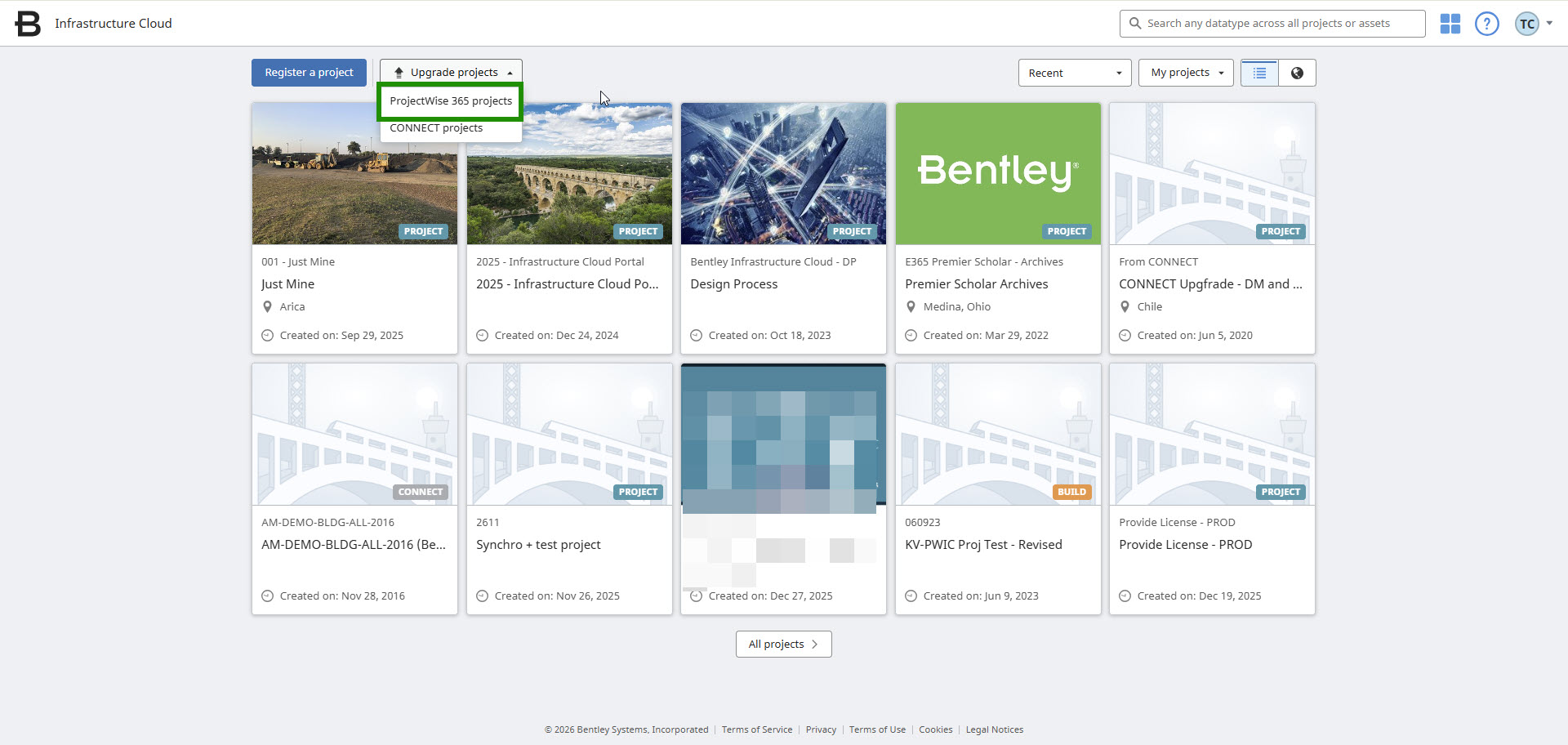

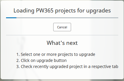

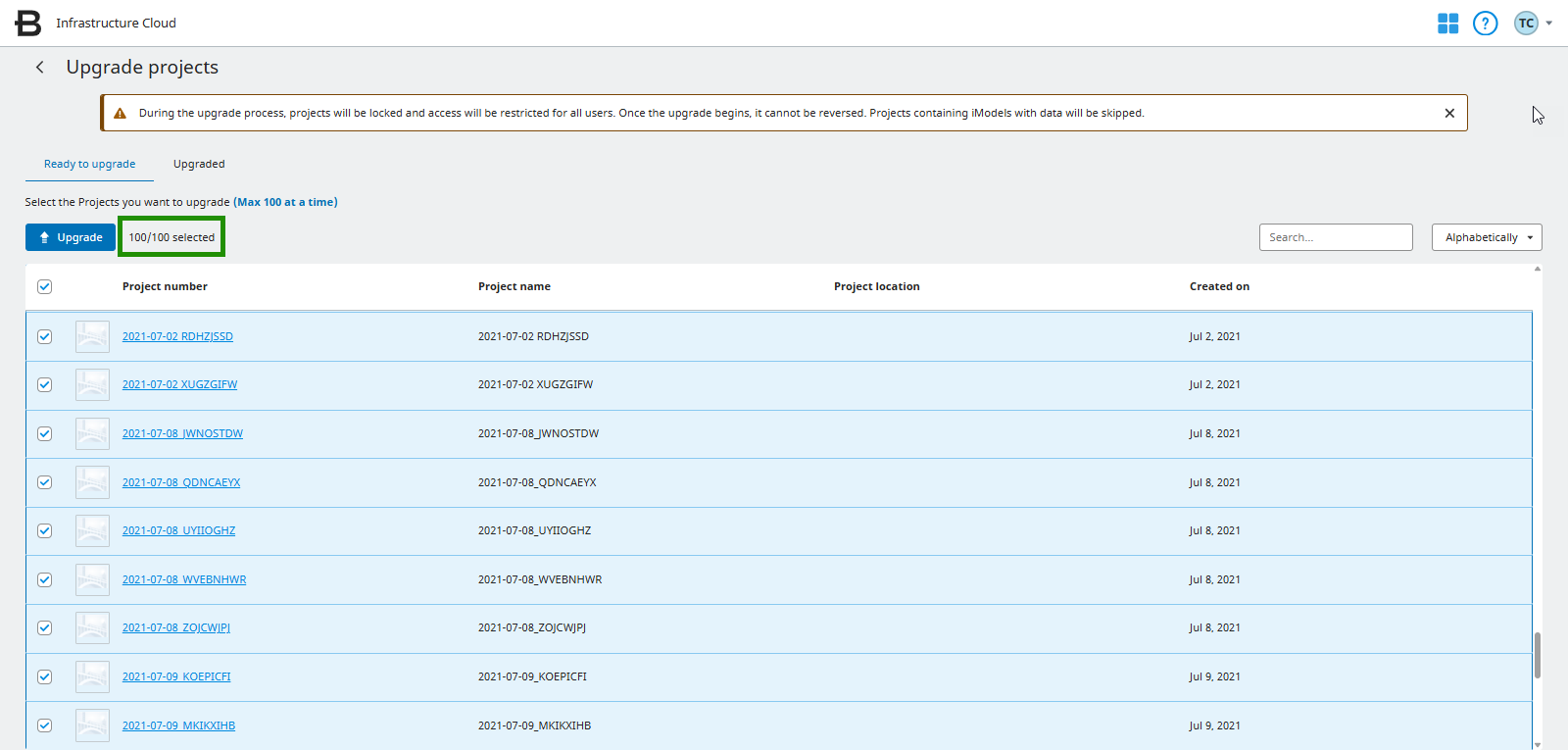

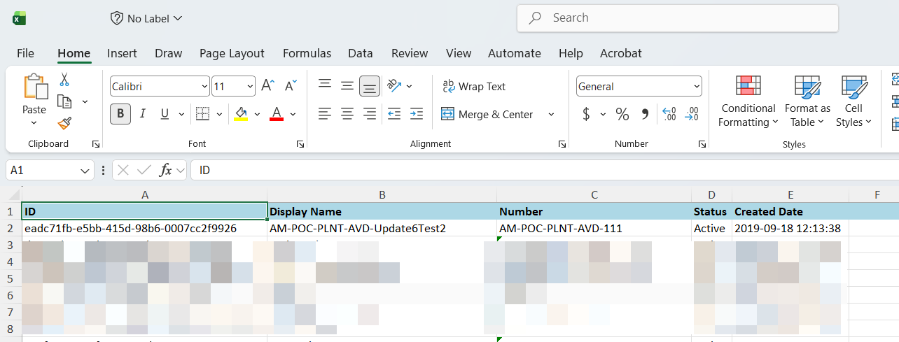

Several projects at the same time
[Note: PW365 projects with iModels with connections will be skipped during the Bulk Upgrade. You can manually upgrade them using Single project Upgrade]
To Upgrade several PW365 projects to Infrastructure Cloud Projects, at the same time

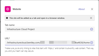

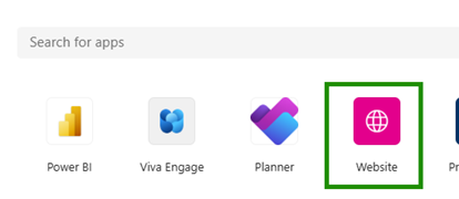

Q. What happened to Teams integration with my PW365 project? Will this integration still work with Infrastructure Cloud Projects?
A. There is no integration between Teams and Infrastructure Cloud Projects. Teams app Website can be used to add an Infrastructure Cloud Project URL to a Team’s group or Channel
