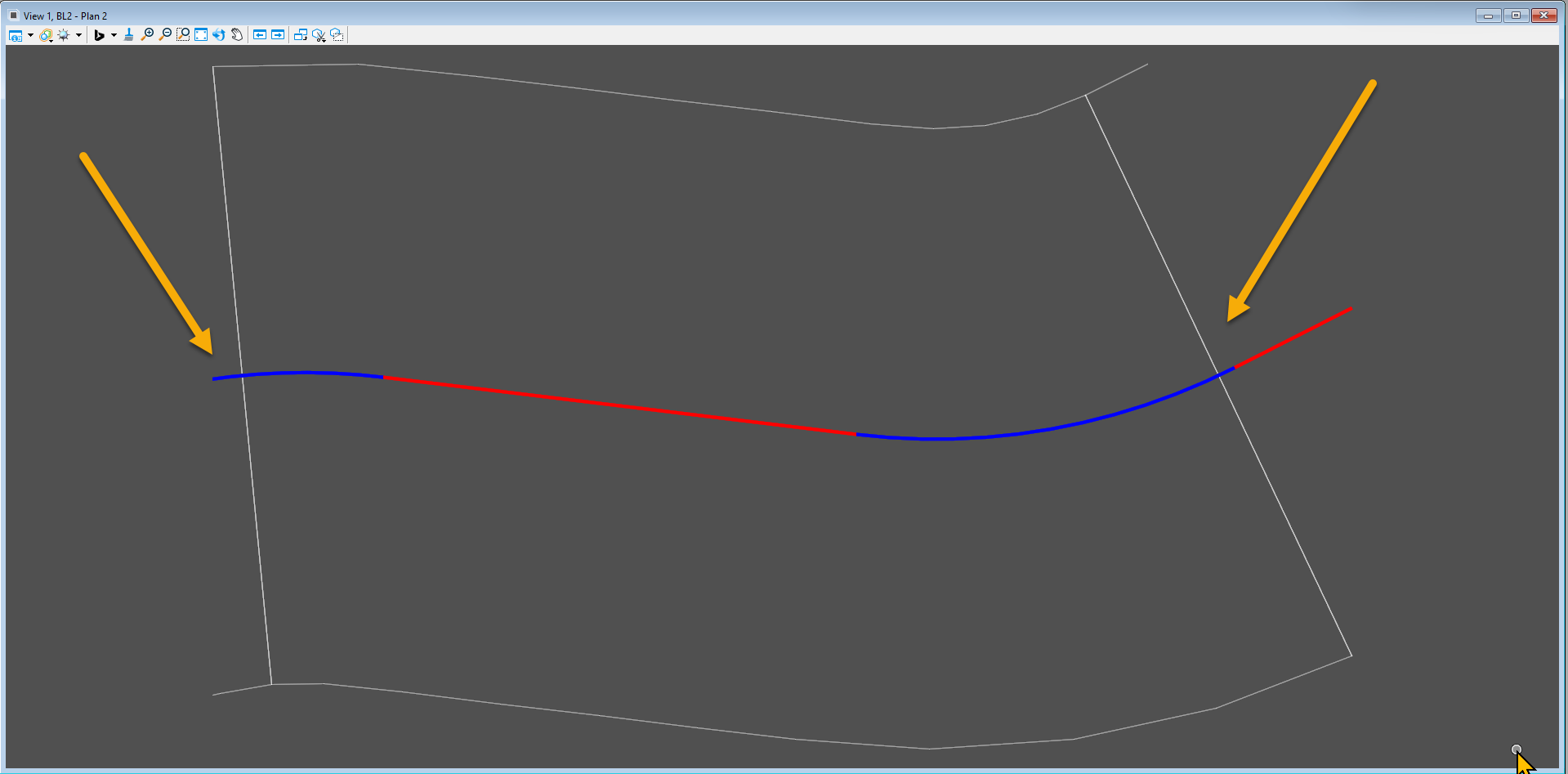

Why are the named boundaries not clipping the graphics in my sheets?
A screen shot of a computer
AI-generated content may be incorrect.

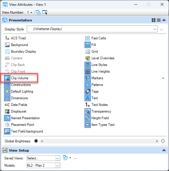

Ensure Clip Volume is toggled on in View Attributes.
A screenshot of a computer
