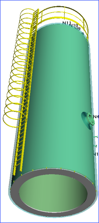

When analyzing a model in AutoPIPE Vessel the following warning number was reported.
Intel(r) Visual Fortran run-time error
forrtl: severe (408): fort: (11): Subscript #1 of the array SHELL has value 0 which is less than the lower bound of 1

When using the tank module, the applicable codes usually require that bottom plates be added into the model before running an analysis.
Confirm bottom plates are defined by looking at the bottom of the tank in the 3d view.
Avoidance:
Simply inserting a bottom plate before running an analysis.
