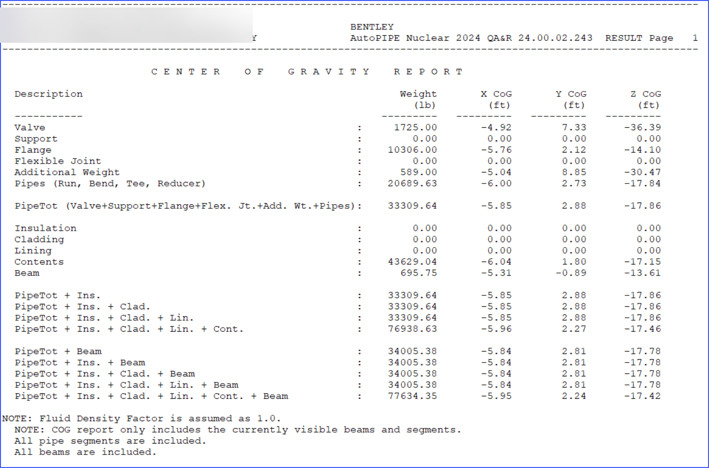

Why does the Center of Gravity report not match the Gr load case?
Example:
Totaled up all of the forces from the gravity load on the supports in the y-direction and came up with an overall number. However, this number is about 4000 lb lighter than the overall weight of the piping and the contents
After adding all the support loads = 73032 lbs
difference of 4602.35 lbs
Why?

Scenario #1:
In this scenario, a particular model was used to generate the COG report (imaged above). The following list was compiled by taking a deep dive into modeling all of the component one at a time to understand how the weight is being reported to each report. For each component, calculate their weight in the COG report and Restraint report to find reasons for any disparities.

As mentioned above, the following component are not correctly accounted for across the 2 reports: Tee, Distributed Loads, and Concentrated forces.
Conclusion
Most of all AutoPIPE's components are correctly accounted for across the various reports. Any discrepancies of weight between these reports can be attributed to these few items until they are addressed.
