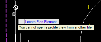

I’ve referenced a corridor dgn into my container. When I try to open the profile model of the corridor generated linear features I cannot. A message appears that says "Cannot open profile view from another file.”.
A close-up of a black background
AI-generated content may be incorrect.
How to resolve?
Answer:
1. Open the profile in the corridor dgn first
2. Try re-opening the profile in the container file.
