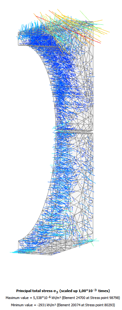

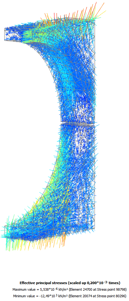

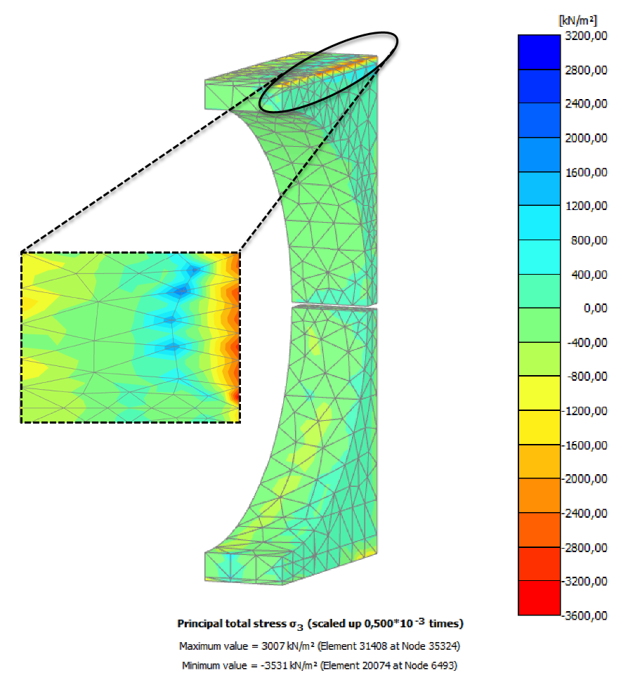

Consider a concrete block designed to withstand only compressive forces, with zero tensile strength defined as an input for the material parameters. When analysing the principal stresses, one would expect to see only compressive stresses (Figure 1). However, an inspection of the σ3 shadings plot suggests the presence of tensile stresses within the block, contradicting its zero tensile strength (Figure 2).
Image 1 Image 2
Figure 1: Effective principal stresses and Principal total stresses, σ3 – coloured principal directions plot (plotted at stress points)
Figure 2: Principal total stress, σ3 - Shadings plot (plotted at nodes)
A detailed review of the table results (accessible via the “Table” icon in the top toolbar) does not indicate tension in σ3. However, noticeable tension peaks at the element corners raise questions about the accuracy of stress visualisation and the discrepancy between the values shown and the input of zero tensile strength.

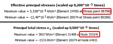

In PLAXIS Output, stress results can be visualised in two ways: at the stress points of the soil element (in the principal direction), as shown in Figure 1, or at the nodes of the soil element (in the shadings plot), as illustrated in Figure 2. The type of points used for stress plotting (stress point or node) is indicated in parentheses next to the maximum and minimum values on the graph (see Figure 3).
Figure 3: Results plotted for stress points and Nodes
In the context of Finite Element Analysis, stresses are computed at the stress points and then, for visualisation purposes,  extrapolated to nodal values to create shaded plots. This extrapolation process may occasionally yield anomalies or spikes in results, influenced primarily by factors such as mesh density and the gradient of stresses (i.e., the rate at which they change). Consequently, the values at the nodes can deviate from those at the stress points, especially in non-uniform stress fields.
When two or more neighbouring finite elements share common nodes, extrapolating stresses from stress points to these nodes can cause stress discontinuities. Each element independently calculates stresses at its stress points. Despite being in the same physical location within the structure, the stresses extrapolated to shared nodes may differ due to variations in integration rules or element shapes. Consequently, stress values at shared nodes might vary between adjacent elements. To derive a nodal stress value, the standard procedure involves computing the weighted average of the extrapolated element stresses at that node (see also “Result Smoothing”).
The example presented in Figures 1 and 2 illustrates a scenario where two adjacent volumes with different material properties (one allowing tension and the other restricting it) extrapolate different stress values to their common nodes. As a result, the nodal values at the highlighted corner in Figure 2, which come from both the concrete block and the neighbouring volume element that allows tension, display tensile stresses. Therefore, the tensile principal total stresses (σ3) are not merely a visualisation issue but represent weighted average values, as explained above.
