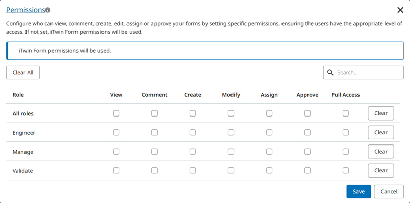

Permissions play a crucial role in determining the access granted to each role during the progression of a form. The following permissions are available:
- View: This permission allows the role to view the form.
- Comment: With this permission, the role can add comments to the form. It also automatically includes the "View" permission.
- Create: Roles with the "Create" permission can initiate a new form. Additionally, this permission includes "View," "Comment," and "Edit."
- Edit: Roles with the "Edit" permission can make changes to the form. It also includes "View" and "Comment" permissions.
- Assign: This permission enables the role to assign the form to other users. It includes "View" and "Comment" permissions as well.
- Approve: Roles with the "Approve" permission can give approval to the form. This permission also includes "View," "Comment," and "Assign."
- Full Access: The "Full Access" permission automatically includes all other permissions, providing the role with unrestricted access.
Note: The All roles row allows you to select/deselect a permission which will apply to all of the roles under that permission column.
You have the flexibility to choose a customized combination of permissions to provide the necessary access for each role.
The permissions assigned to each form instance are specific and based on the role assigned to it. As a result, different forms within the same project may have varying levels of permissions for certain roles. This allows for fine-tuning access based on the requirements of each individual form and its corresponding role on the project.
Note: If no permissions are set, the iTwin Form permissions will be used as the message indicates in the dialog above.
