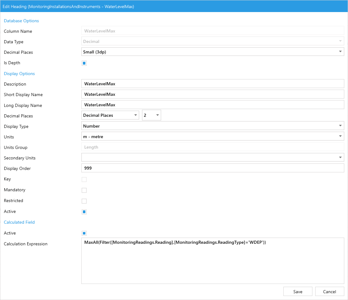

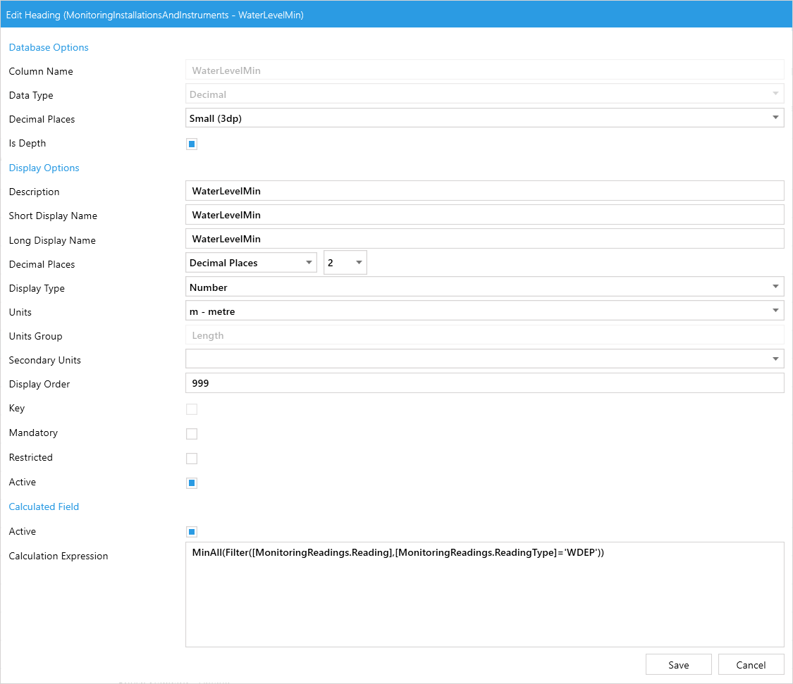

In this example, Filter() will be used to determine the minimum and maximum Water Levels in the MonitoringReadings Group. To do this, we’ll add calculated headers in the parent MonitoringInstallationsAndInstruments Group. In the example data, there are ‘Reading Types’ for Temperature (TEMP), pH, and Water Levels (WDEP), so Filter() is used to find the minimum and maximum for just the WDEP readings:
MinAll(Filter([MonitoringReadings.Reading],[MonitoringReadings.ReadingType]='WDEP'))
MaxAll(Filter([MonitoringReadings.Reading],[MonitoringReadings.ReadingType]='WDEP'))

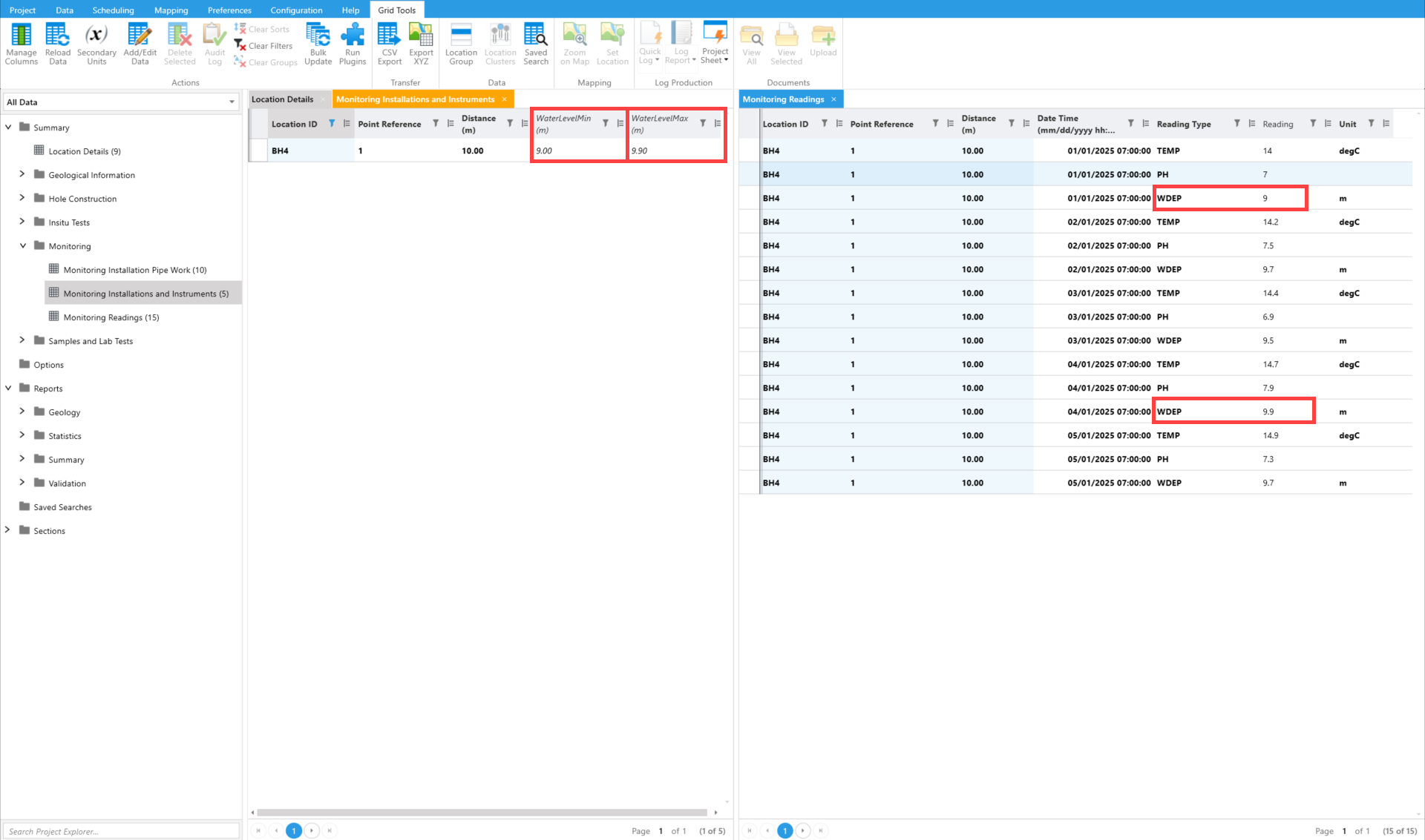

Looking at the results, we see a minimum Water Level of 9.00 m and a maximum of 9.90 m was recorded in this example.
Note – the calculations above were performed in the parent MonitoringInstallationsAndInstruments Group so the results are per instrument in that Location (the example data above happens to only have 1 instrument). Alternatively, because it is possible to aggregate grandchild data, the calculation could have been performed in the LocationDetails Group, which would have returned the minimum and maximum values across all instruments in that Location (had there been multiple).

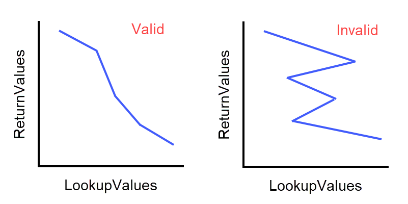

Interpolate()
Performs linear interpolation on a dataset to return a value for a given “lookup value”.
The function computes the return value by performing piecewise linear interpolation between the two points within the dataset that fall before and after the lookup value.
As described in the Aggregation in Model Calculations guide, records are ordered by Key Headers when performing the interpolation.
The function takes two forms – with or without optional ScaleOptions, which can be used to specify arithmetic or logarithmic scales.
Interpolate(LookupValues, ReturnValues, LookupValue)
Interpolate(LookupValues, ReturnValues, LookupValue, LookupValueScaleOption, ReturnValueScaleOption)
When performing the calculation, the following validations are performed:

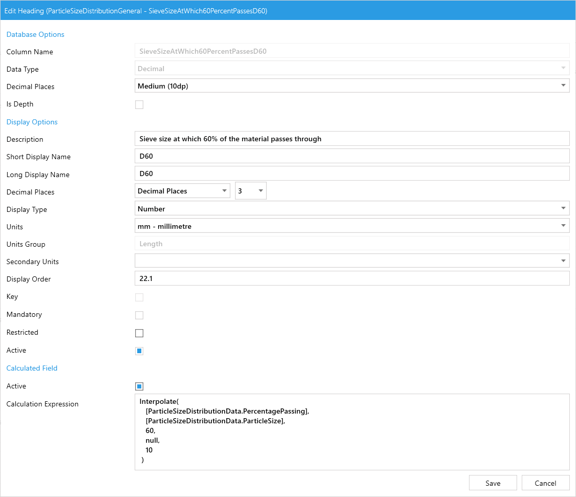

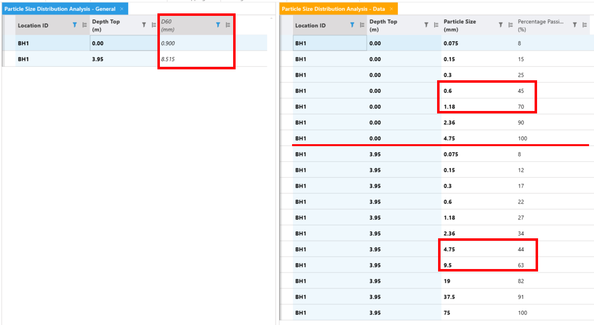

Interpolate() can be used to calculate D60 for a Particle Size Distribution test (particle size at which 60% of the soil particles are smaller) using the expression below in the ParticleSizeDistributionGeneral Group. The LookupValues (PercentagePassing) use an arithmetic scale (null) and the ReturnValues (ParticleSize) use a logarithmic scale (10).
Interpolate(
  [ParticleSizeDistributionData.PercentagePassing],
  [ParticleSizeDistributionData.ParticleSize],
  60,
  null,
  10

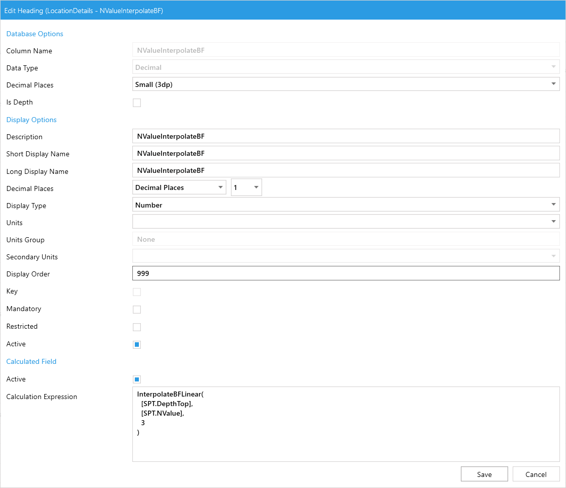

In this example, InterpolateBFLinear() will be used to determine a "representative" N-Value (ReturnValue) at 3 m depth (LookupValue) using the expression below. The ScaleOptions are omitted, in which case arithmetic scales are used. (This example is intended for illustrative purposes of the function usage rather than a real world example.)
  [SPT.DepthTop],
  [SPT.NValue],
  3

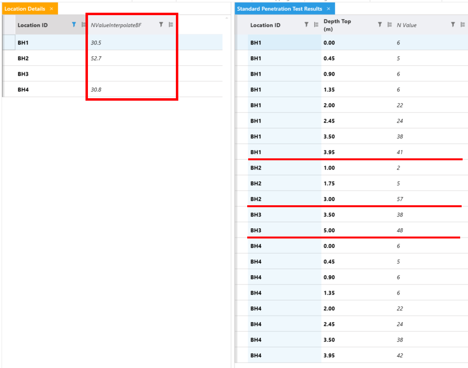

Looking at the results, we see a value has been computed for all Locations except BH3 where the LookupValue (3) is outside the range of the  LookupValues (DepthTop).
