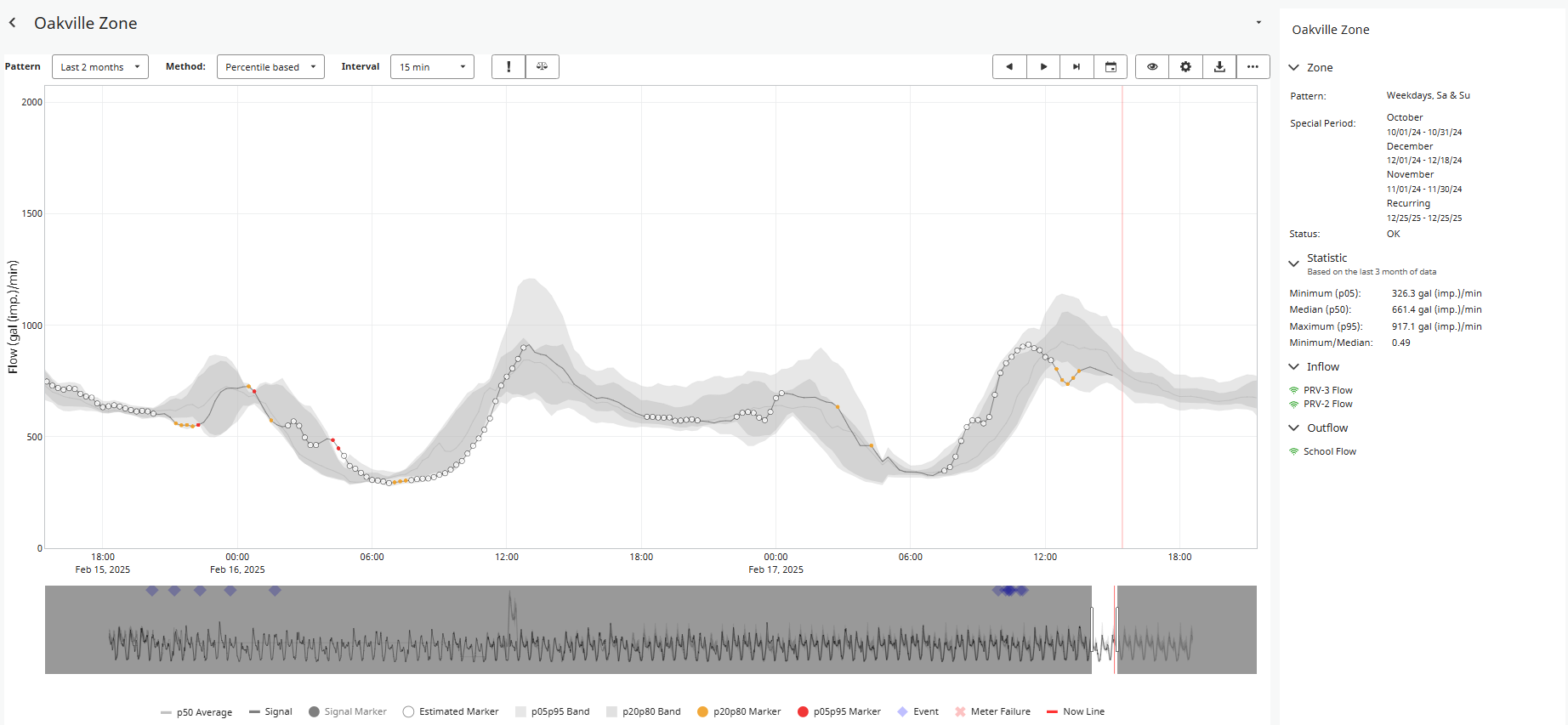

To make those activities more effective, WaterSight uses a powerful algorithm (based on statistical analysis and machine learning) to gap fill data for the zones whenever at least one of the sensor that belongs to the final zone balance fails (no data, flat reading, big spikes due to wrong data, etc). These estimations are based on the sensor pattern values.
Estimated zone flows will be displayed in the zone graphs (represented with empty circles) and the estimated values will be used in all consequent calculations of water balances and other zone KPI.

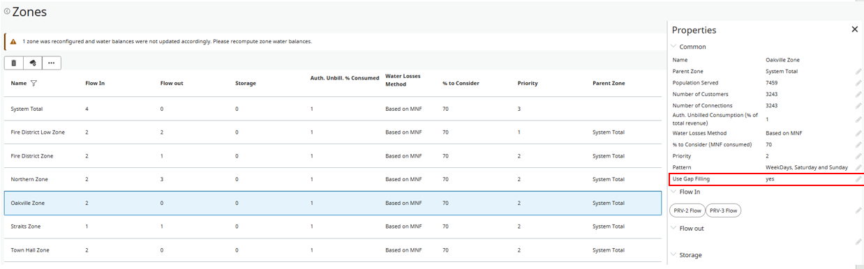

How to enable Zone Gap Filling?
By default Zone Gap Filling functionality is off, this means that if one of the sensor that belongs to the zone fails and starts to report no data, the zone will also report no data. Or if one of the sensors that belongs to the zone starts to report wrong data, the zone will also start to report wrong data. To activate zone gap filling go to Administration, and edit each zone. On the side panel, make sure to turn the option "Use Gap Filling" set to yes.
After this change is made, automatically zones data will be estimated for the specific periods where:

Estimated Zone flow display
Estimated data is only displayed at the zone level (and not at the sensor level) and will be represented in the zone graphs with empty white circles, allowing the user to continue to have access to zone flows, even if estimated, see example below.

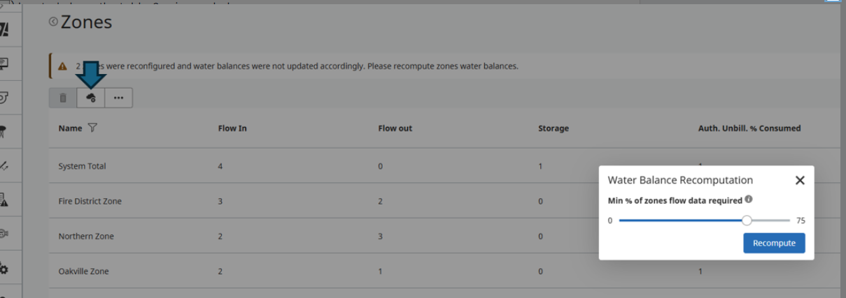

Note that if there are big periods with estimated data, the system input volume might end up not to be calculated as there is not enough data, as by default it requires 75% of the zone flow data to be available during each month (mor or less 23 days per month with zone data). The user can change this default by accessing the Administration >> Zones >> and clicking in the recompute button located on top of the table, as per figure below:
For example if setting to 0, this means that if there is no zone data available for one entire month, the data will be estimated for that month using the historical data of the previous month. If the previous month also does not have zone data, then it is not possible to calculate system input volume for the zone.
